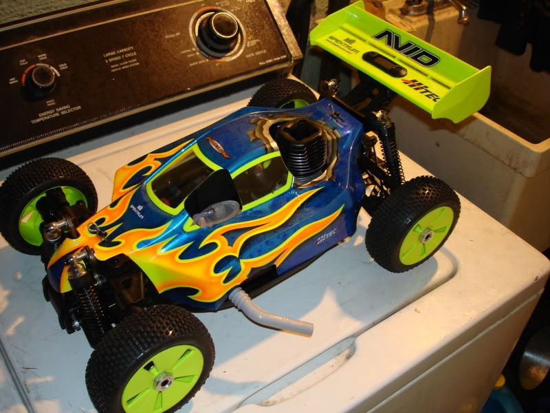

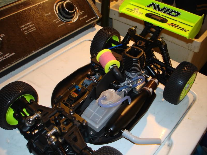

filled all three diffs with silicone and converted most of the aluminum parts to Carbon fiber, installed machined aluminum front hubs and installed a Tsais pipe.. Heres latest pics

Very Nice!!
Who's CF parts are you using?
Were they direct fits?

I have the Power Racing stuff for the Katana, It looks like he has the same parts. The carbon was a direct fit, the front upper arm mount was not. I posted about it earlier in this thread.
flyingn
02.20.2008, 01:31 PM
Thanks! I got my parts from Larry's RC .. great company!!
