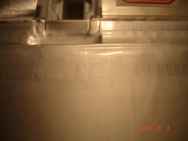

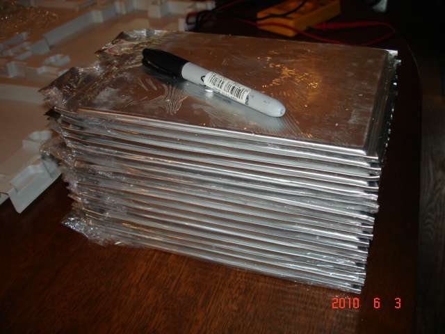

Well, after ordering the ebike kit and battery cells 2.5 weeks apart, they arrived here on the same day! Hmmm, goodies. The cells have the A123 Systems logo, part #, bar code, etc. still printed on them, and I guess they are made by Enerland facility, in Korea.

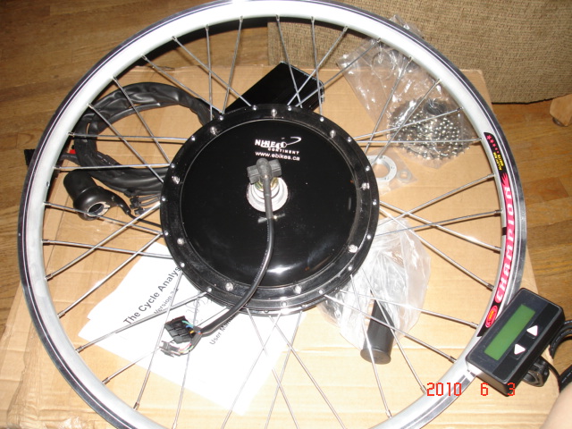

The Nine Continent motors are supposed to be one of the lightest built units available, but looks very solid to me. It would be nice if they could make them lighter, adds quite a bit of mass in the wheel, I'm not sure about rotating mass though, I would guess a 1/3 of the total motor weight.

So no one thinks this stack of 30C A123 15Ah cells looks sexy at all?

That whole pile of parts looks sexy! You'll get some serious power from those cells!
That motor might look sexier with cooling holes and a fan tho,,, If you ever need them
Make sure you run a couple torque arms in the back.. I didn't see any in the picture. I did see what I think is a disc brake adapter tho! Very nice!

Yeah man, the 720i HP is reporting them to be 1mOhm (probably the lowest it can go?) each. Cell_man did some discharge tests on endless sphere, can discharge 600amps @ 2.0v/cell IIRC. I am going to buy a 1200watt charger for it to get less than an hour 0-100% charge. If you calc the power density from the 26650 M1's, it should have a solid 17kW power capability, so obviously it's not going to break a sweat at ~2000watts peak.
Those holes look scary to me.
Oh, and do I need a torque arm for the rear?

You definitely need a torque arm for the rear. I would recommend two torque arms. Make sure you have steel dropouts too.

The dropouts are aluminum, everything on the bike frame is either alum. or magnesium. I can get a torque arm made for the disc brake side (we aren't using the disc brake anymore, caliper doesn't fit between rotor and motor), but for the gear cassette side I am not sure. Will one good torque arm suffice with 48v/40A NC kit?

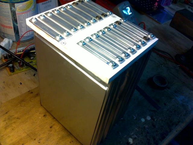

That is what I am thinking for the battery connection plate, although I will add ridges between each terminal to prevent small metallic objects being welded to the tabs, or at least reduce accidents from occurring.

Okay, I went to my machinist today, brought him the plans for the battery pack terminal plate. Will be machined out of 1/2" poly, with 47mm x 2.3mm slots machined in for tabs to come through. Aluminum tabs measuring 65mm x 8mm and 3.125mm thick will be made (17 of them) to clamp down on the tabs connection.
I also got him to make a solid torque bar that mounts to the disc brake caliper mounting holes, so it should hold good and strong.

Good deal. Make sure to make the torque bar thick. 3/8" sounds wonderful.

Alright, last weekend I got the bike back and a really nice torque bar installed, so i tested the setup out on a 16s A123 pack, just 16 26650 M1 cells, so voltages dipped alot under load, but still it got up to a top speed of 52kph or 32mph on the highway, gets there in less than 10 seconds too, faster than I thought it would be. Cruising at top speed, the voltage is sagging down to ~45 volts, from ~52-55volts resting voltage. I should be get the battery terminal plate from the machinist this week, but I will be gone until weekend so I can't assemble it or test it out until then either. Top speed should be close to 60kph or 37mph as the voltage will not drop.
