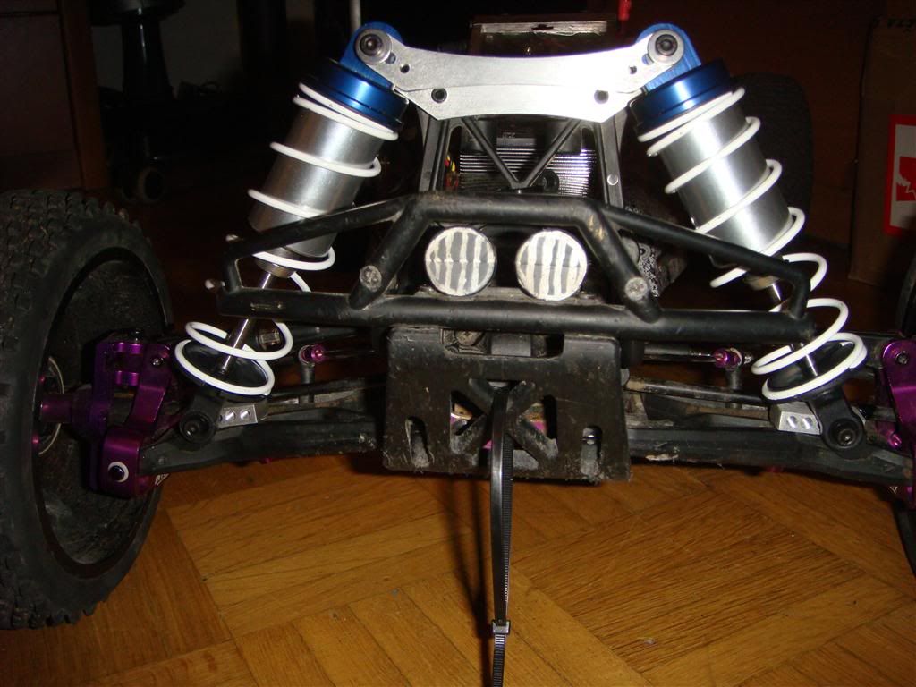

19€ shocks are standart parts for Gas Devl cars...they are identical as 29€ shocks wich are labeled under Option parts for Carson cars. No diference in shocks only in price!
Shocks do look well made and feel good, masive shaft but tests on BMX track will show more.
yes, i got front set if you check few posts back.. :)
Maybe i would be better with FLM Ext. A-arms and longer rear shocks...anyway..
Could be the stock sping is a bit to stiff/hard... If so i will go for softest springs.
Here springs....price is almost same as shocks lol.
http://rc-car-online-shop.de/shop/en...gd-2-pcs-.html
Rebuild kit is 26€, so if something goes bad on shocks, just buy another set and viola..spares if ever needed:)

haha crazy shit on that site but its still cheappppp if they're holding up to the abuse and dont leak :)
I think i'll go for the longer shocks with 14mm more travel, when i'll make my extended arms they'll fit better i think.
And indeed it looks better to buy an extra set of shocks to repair them :)))

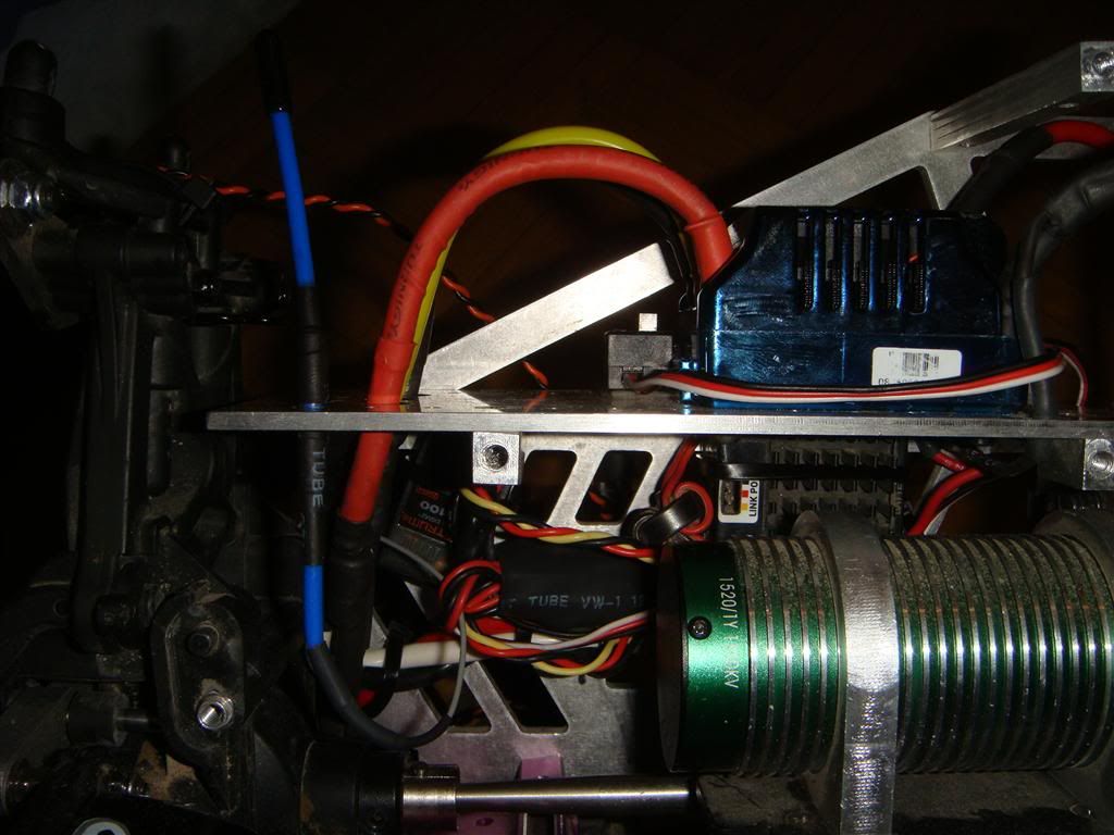

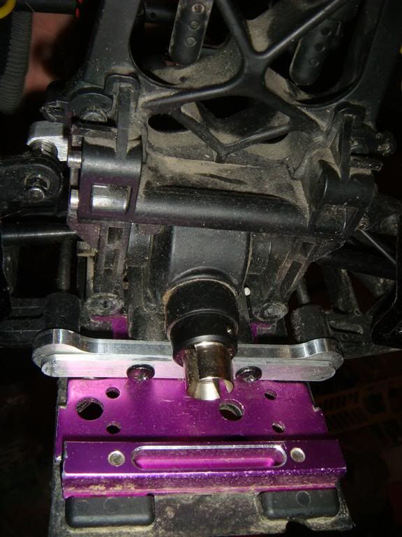

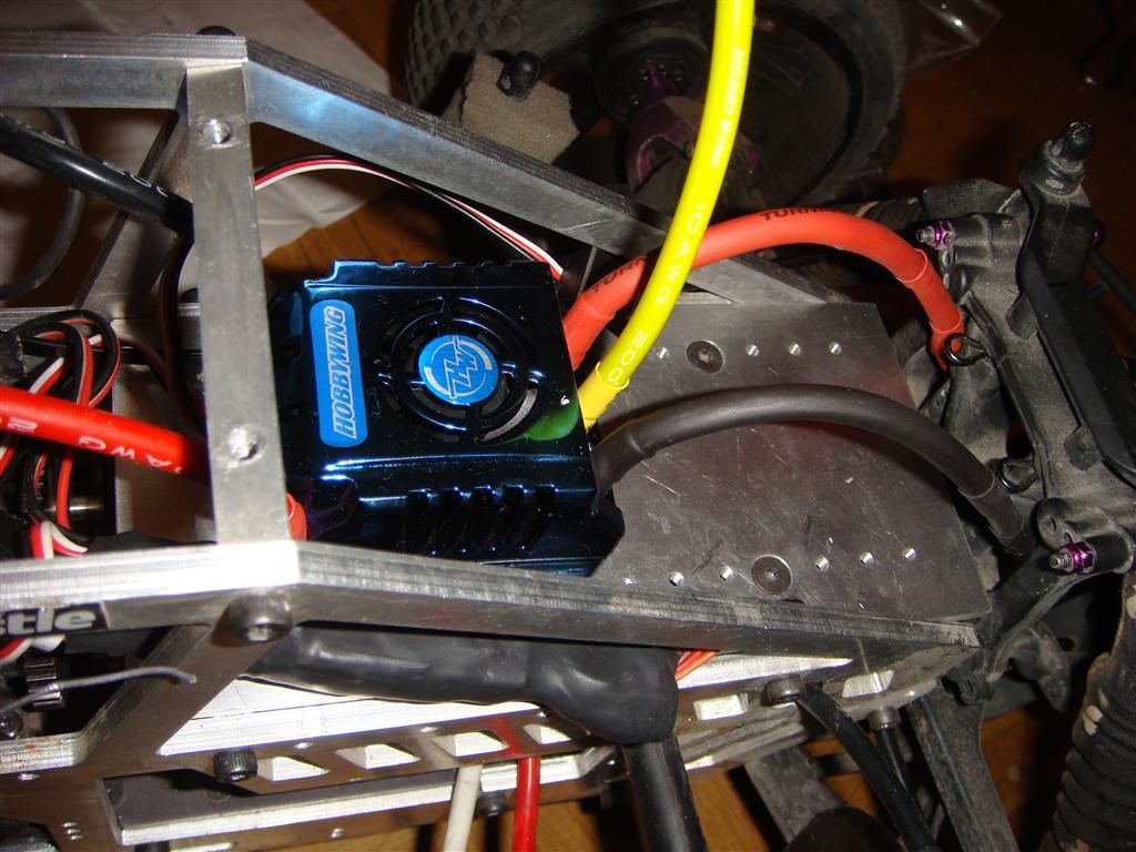

Small update, I got rid of 6,5mm connectors and now got only 6mm from HK.
Also made 4 holes in esc plate and mounted esc directly on.
Xerun 150A is great for first test and runs very very nice.
Got no card at the moment but cells are on outo cut off 3.2V per cell.
Had a great 23 min of run at the night with lights on.
I like the size of the esc, small but strong.
Here is how i mounted wing to friends 5b to get an angle for a wing.
Cutted 2 long shafts from body mount and made 2 holes wich those 2 shafts where put thrue and secured with body clips..2 Bclips up and 2 Bclips down. We can actually put more angle to the wing (set the wing angle) if 2 cutted shafts are slided/moved more up (out of the towers) or if slided/moved more down (in to the towers).
These 2 shafts push the rear of the wing more up in this case.
No need for 2 body posts between the body mount and tower as body mount is leaning on the tower ears ( tallest part on towers, where you put shock upper shcerw thrue)
Also must say wing is no longer moving, it is secured now.
FG wing, perfect fit with stock holes.

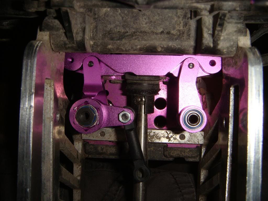

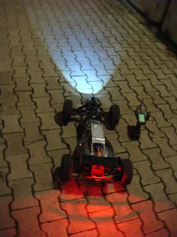

Friend ordered 14$ Yeah racing steering kit suppose to be same as mine.. but somehow it was made for oposite side.. like "mirrored" dont know the word.....lol,
we had to turn servo plate for 180 degree and servo and servo arm all because of the steering kit :)
Bad pic but anway...with lights, lol.

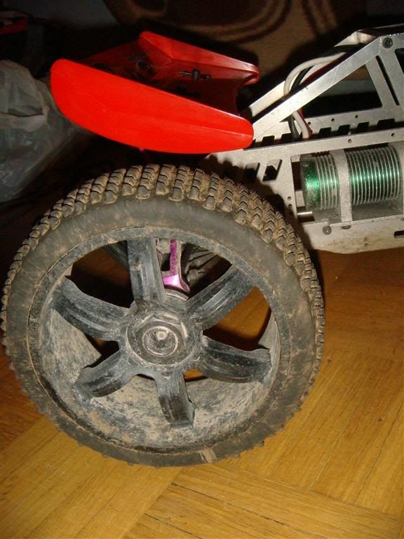

looking good and bright lights! I have 2 sets of baja lights and they shine mighty bright also on a small 2cell lipo.
It looks like that drive cup is getting eaten away ;) I have put the hd cups on it and they still look like new but dont think my car ran as much as yours... Just ordered some rubber boots to cover all the cups coz most of the damage gets caused by dirt who starts acting as sandpaper so hope this will prevent this even more.
Concerning the shocks springs, i will order the softest springs then coz i want soft dampening :)
Those shafts extending to full length without the spring on them, that's simple. It means they're correctly filled, when you didn't fill them correctly the shaft won't extend to full length wich is not good, the shock should be sufficiently filled untill the shock shaft extends fully when you push it in and release it ;) So if you fill them put the cap on them, test it and refill if necessary, I guess they did a good job at the factory who filled them :)))

I checked the cups and only front cup is eaten on both 5b-s.
My friends 5b wich picture is above is eaten the most, my is a bit less.
All other cups are ok for now. Could be because of the accelerations cars weight goes to the back so front wheels spin easier..maybe that is why only front gets eaten. Will go for SS cups.

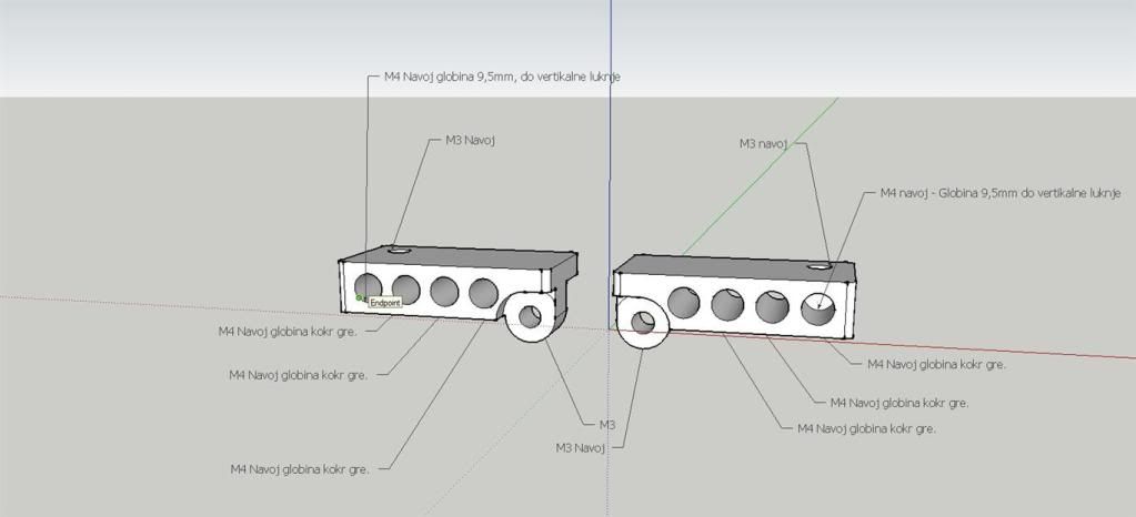

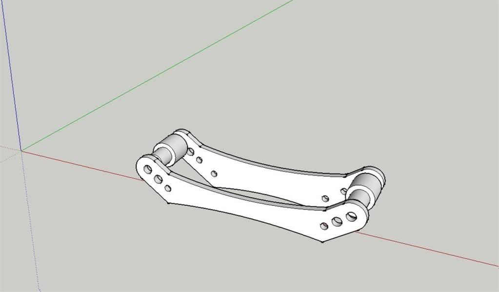

Going to draw the lower parts for shock kit, i hope i finish fast and send it to "the man" :)

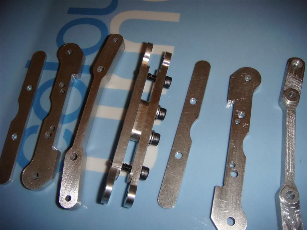

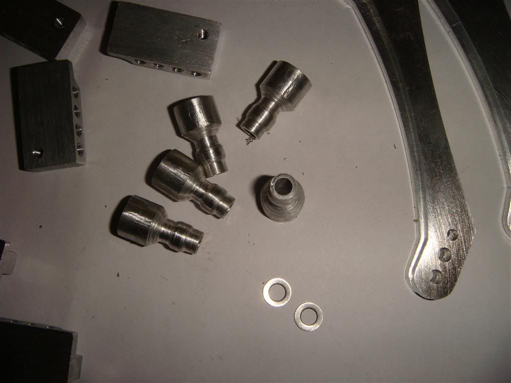

Small update..
My drawings, lol

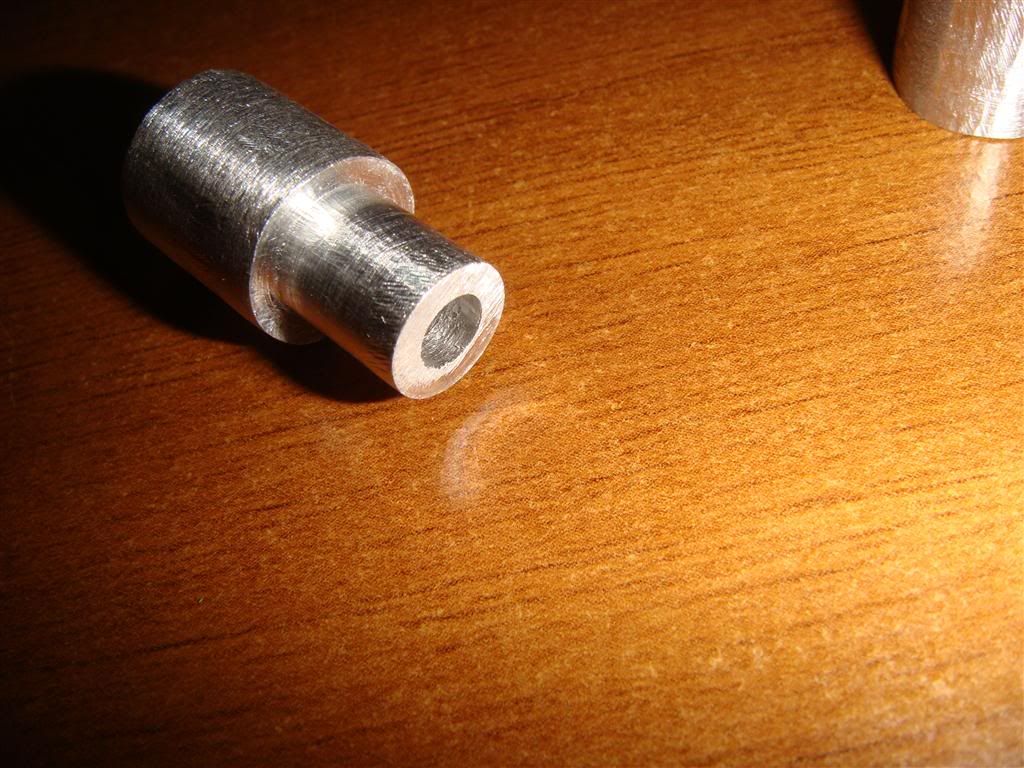

Thanks to Alza Racing for cutting all out and Mr.S2K for resizeing the aluminum shock bushings to fit the GD shocks!
Shocks kit and alu bushings for GD shocks
maybe a better picture a bit latter :)

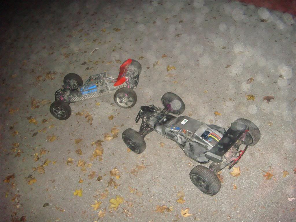

Must say my friend Foty killed the tranny on hes savage flux 5b that is got 130mm shocks and 44/23T on 5000mah 5S, MMM + 1520 motor.
So i gues i will be making a little video alone :/

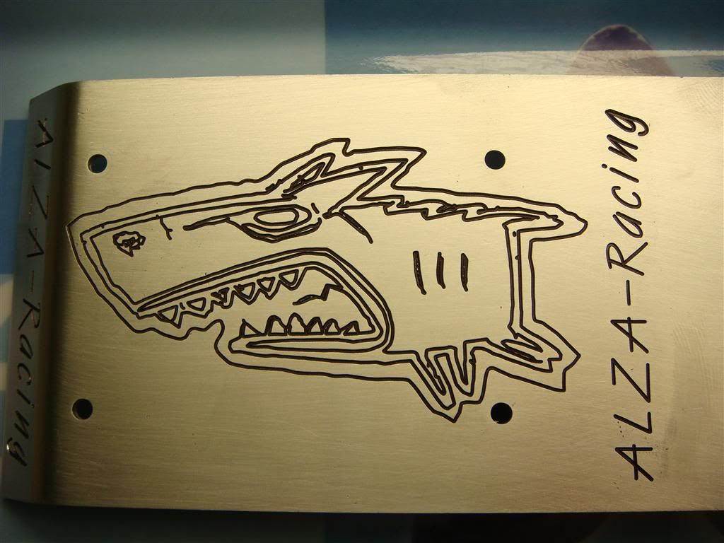

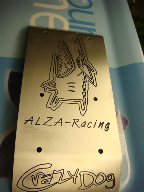

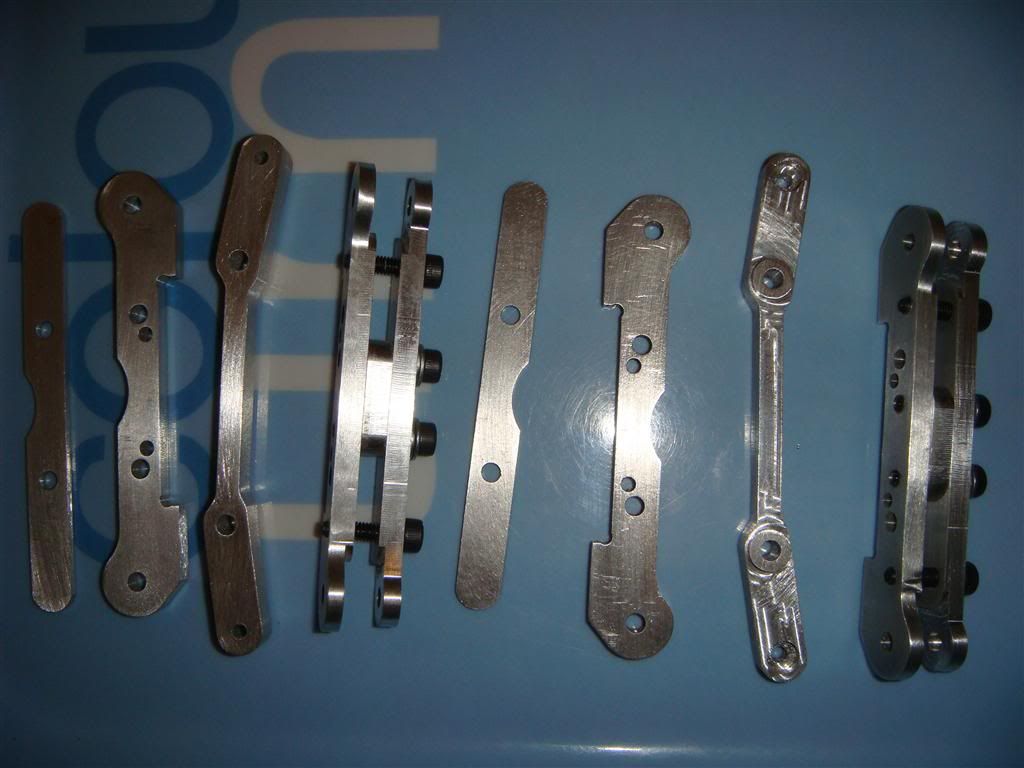

Got the wide brace kit for Ext. FLM dogbones from Alza racing.
And the new roof. Also received yellow springs for shocks.
I send alza a picture that i liked and he put that on the roof.

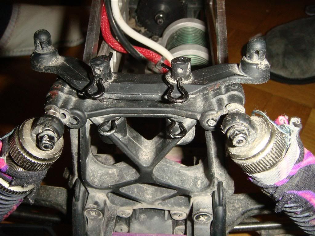

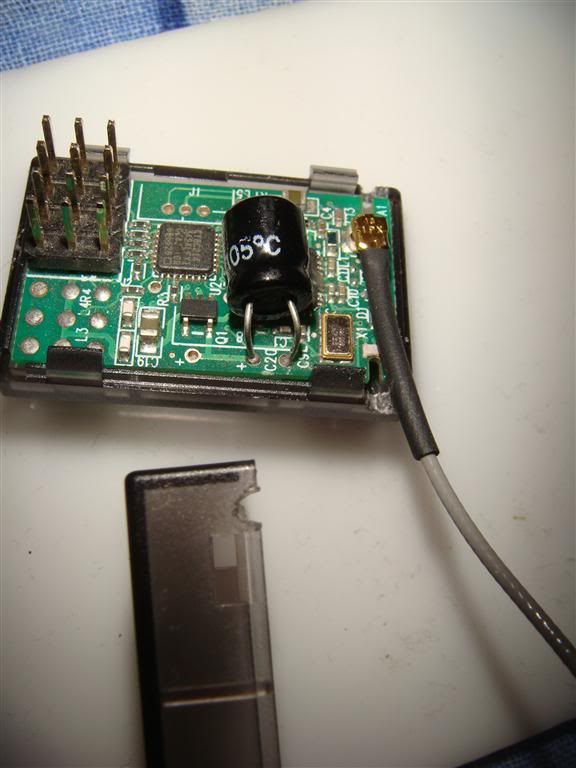

Antena was torn and had to wait for new one. I protected antena now with shrink tube as it was damaged right on the spot where it goes out from receiver.
Hole on receiver was made a bit bigger so shrink tube can go thrue.

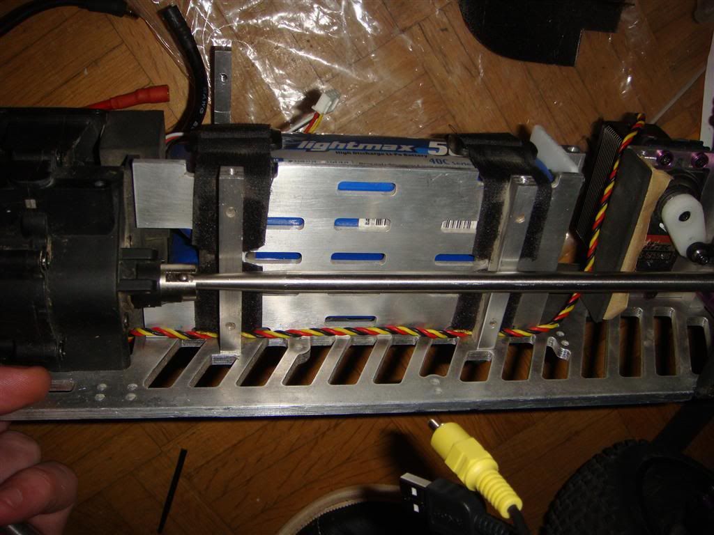

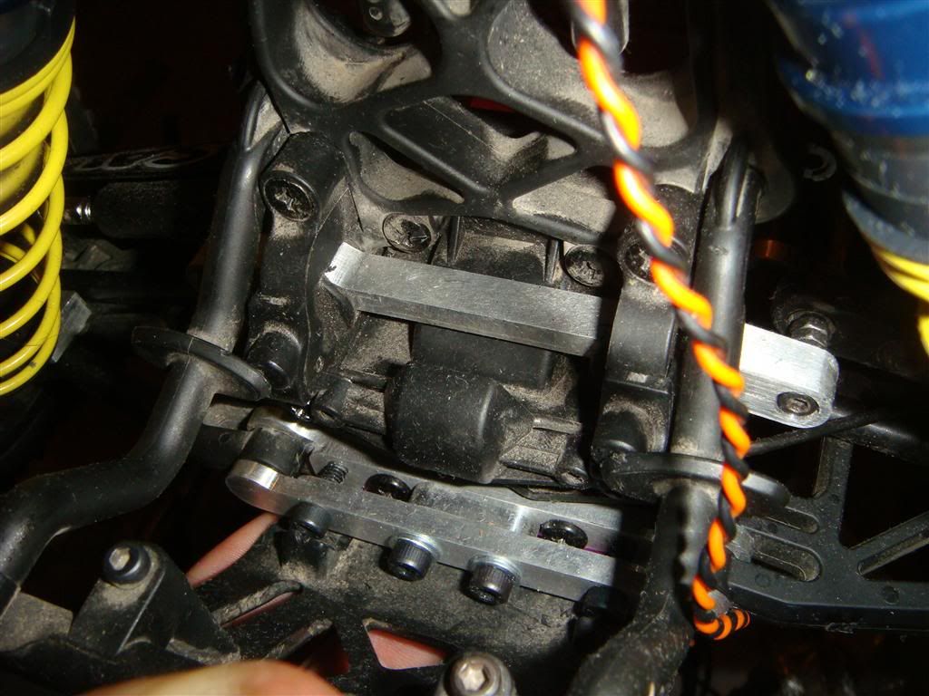

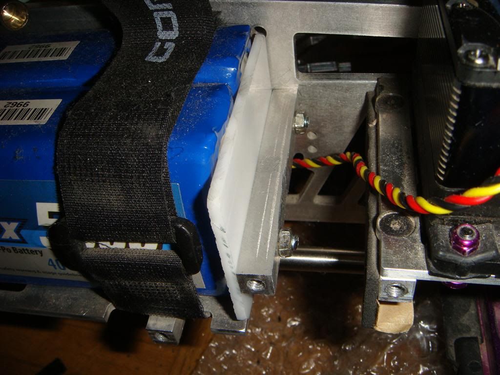

Next on the list was some kind of lipo protector or whatever you wanna call it.
Brace i had there was slowly leaving marks on the lipos wich was not good.
Now lipos cant be hit anyway and they wont get damaged! White plastic part is doing the job great.
Alza wide brace kit and FLM dogbones.
Wide brace kit does the job and widens the truck for aprox 30mm.
What i dont lik eis FLM dogbones or should i say PINS.. those are to short.
Should be longer on each side fro around 1mm to aprox 2mm.
When i turn wheels in 1 side, there is only 1 pin on dogbone tuching output axle cup. should be 2 pins. So i will get these to the man so he knocks them out and puts longer PINS. I dont know why FLM didnt do this when they where making them.
Upper arms where made from two SS upper arm kits.
Also changed the center cups for stronger ones
Servo wire secured nicely between lipo plate and braces.
Here the antena tube wich i secured with few shrink tubes up and down.
Dont mind the mess around the receiver, one day when i wont be too lazy i will cut and solder all the wires to correct lenght.

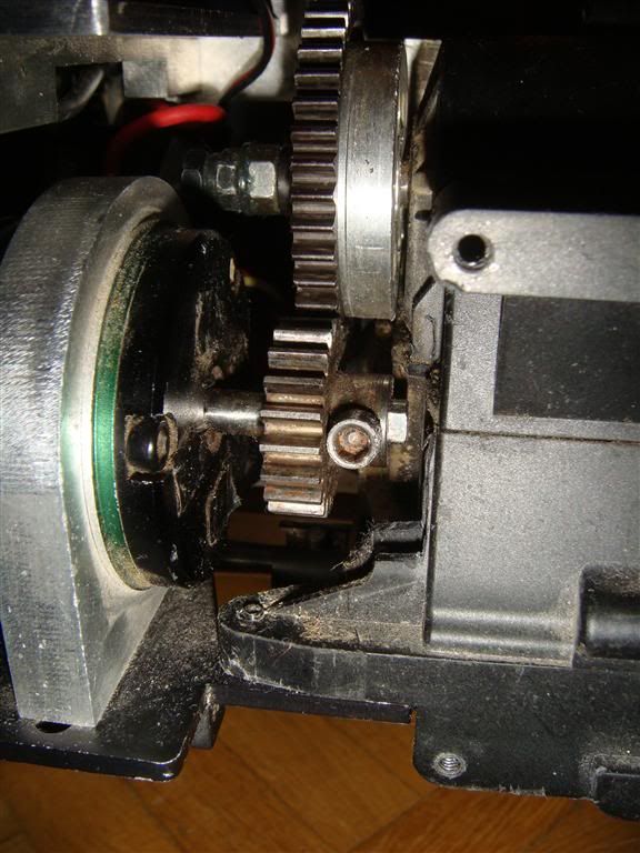

Next is motor grub screw. Stock one is PURE rubbish.
So take one M4x4mm screw and just grind off a little on the hex screw head, so it wont hit the motor pinion when securing it on.
I also cutted a little off on tranny, so if motor pinion ever comes lose and it hits the tranny it wont get stuck.
Also using 2 nuts on slipper locker kit. Third M5 nut is just working as a shim/spacer.

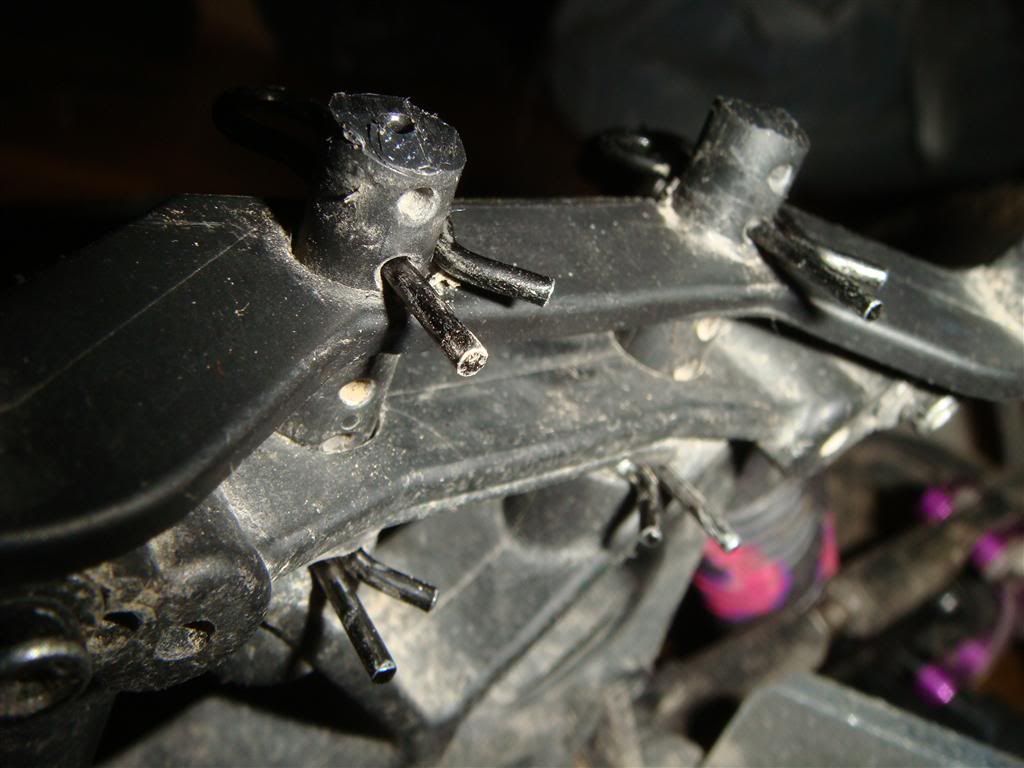

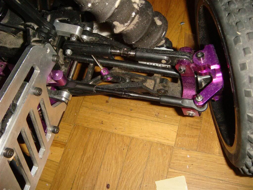

For steering i used longer shafts Stock are M4x70mm i used M4x80mm from HPI and other plastic parts are stock for now.
Here you can also see how i mounted upper arms.
I must say i dont like the way upper arms are extended as there is less meat in the plastic parts, so i need longer shafts/screw for upper arms.
