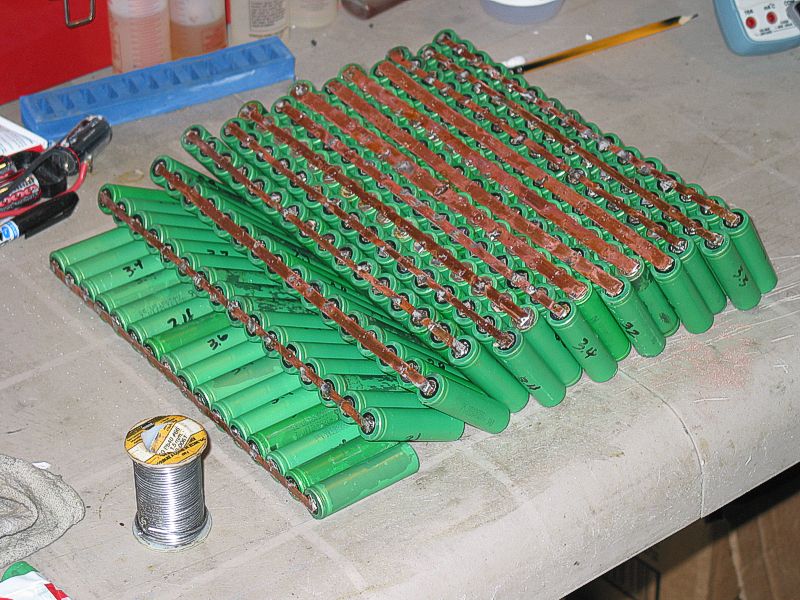

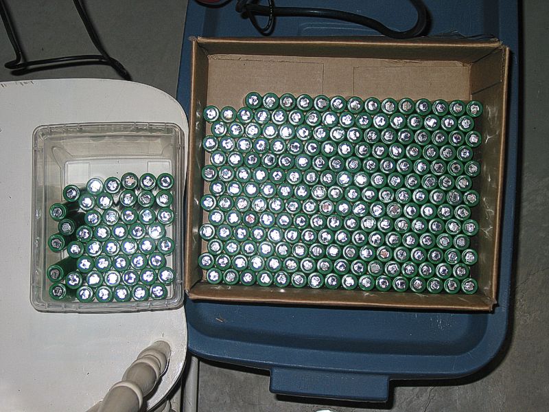

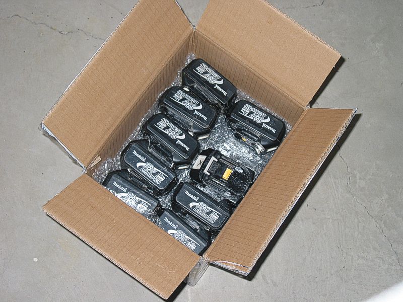

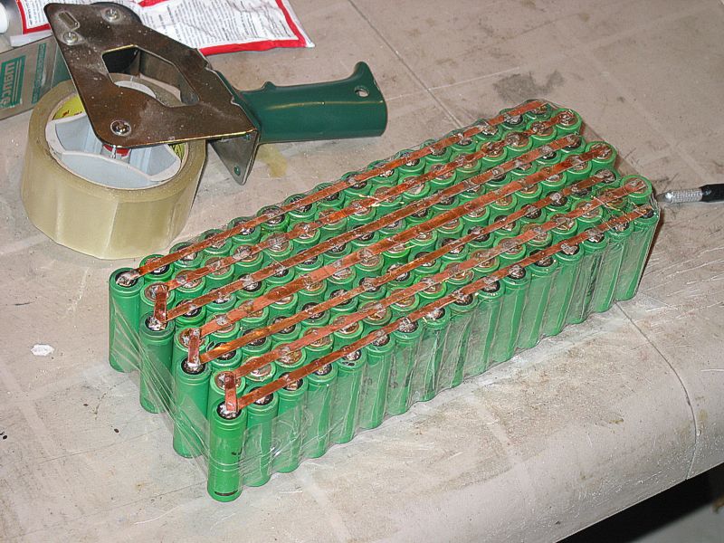

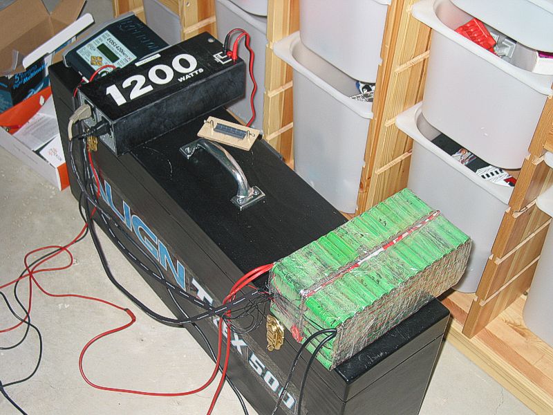

It's because I didn't put any pics. And since I don't want someone to say that if there's no pics it didn't happen. Here's some pics.
The used Makita batteries, 30 of them
The cells all separated, there's a few more in another box.
14 strings of 16P done
One block of 7S16P done
The two blocks of 7S16P connected in series, 7S balance connectors installed and getting a nice balance charge on the new Hyperion 1420i
I'm waiting for the large heat shrink tubing to come in to finish this pack nice and beautiful.
