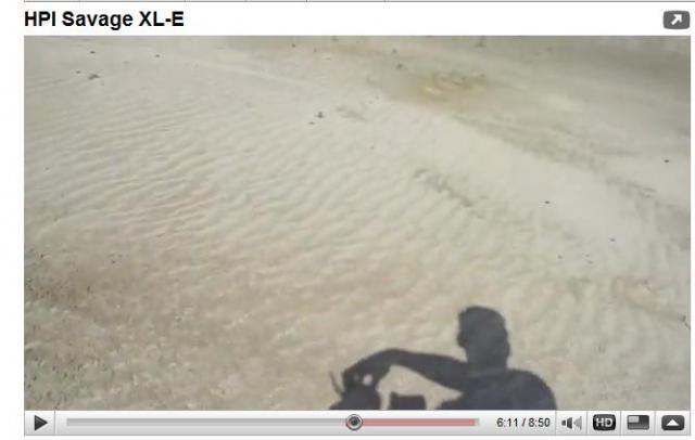

->Finally some video<-
Love this setup (did I mention it already?), no bigger mods will be made - this one's ready (sure!)...

Great video, that bash spot is Tits ! I was woundering how you mamaged to shoot video and drive and at 6:11 I seen your shadow, LOL. You have your hands full.

Awesome! Kill to have something like that by me even within driving distance. And the riding the half bowl was great!
Now to this very odd radio handling lol, credit for doing both driving and taping at once my man!
