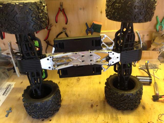

And...

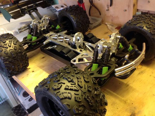

08.15.2015, 02:51 PM

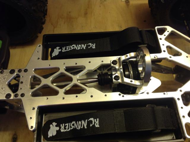

08.15.2015, 02:53 PM
She pretty ...

08.15.2015, 05:42 PM
Looks good! What wing mount are you using on the rcm towers? Were they direct bolt on or did you need to do any mods to make them fit?
to make it...
or break it...
Silent...But Deadly
  (#125)
kjf73
Posts: 23
Join Date: Jul 2015
Location: West Coast Denmark
08.15.2015, 05:53 PM
Mugen mbx-6..bolts right on no mods :-)
  (#126)
RC-Monster Mike
Site Owner
RC-Monster Mike's Avatar
Posts: 4,915
Join Date: Nov 2004
Location: PA
08.16.2015, 12:12 PM
Truck is looking good, Kristian!
The shock towers accept Mugen wing mounts as well as Hot Bodies lightning/trophy series including the light weight V2 mount directly., Jeff. :-)
