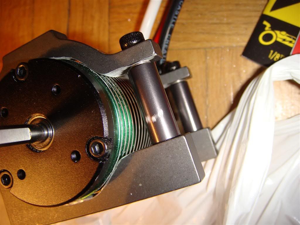

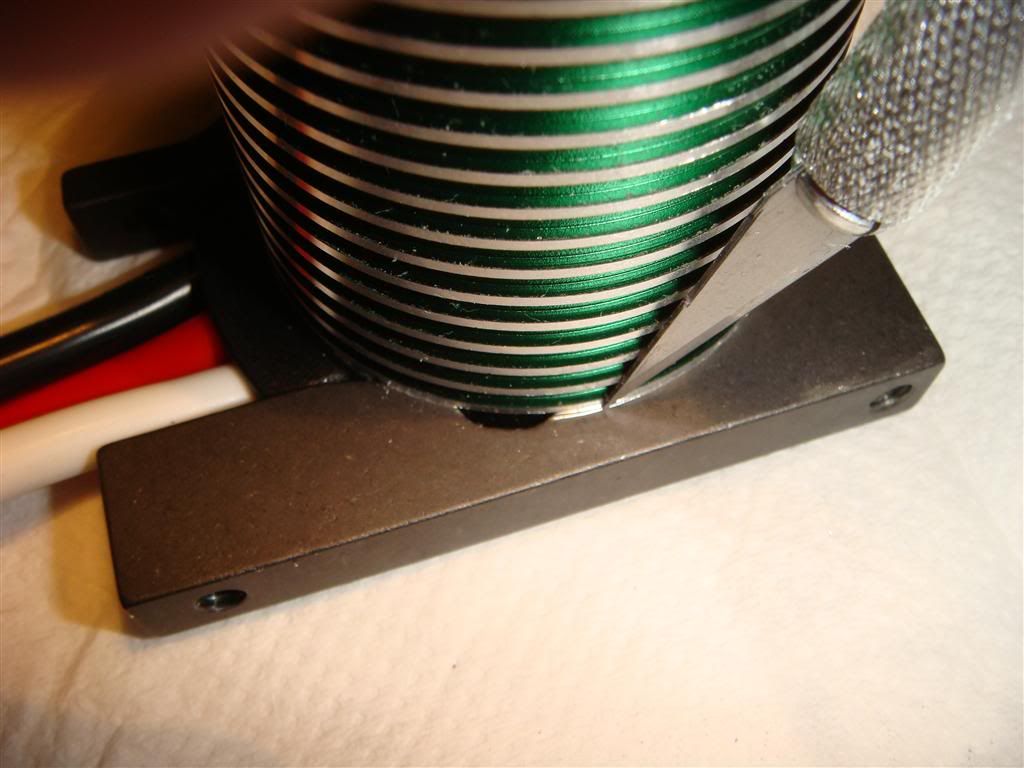

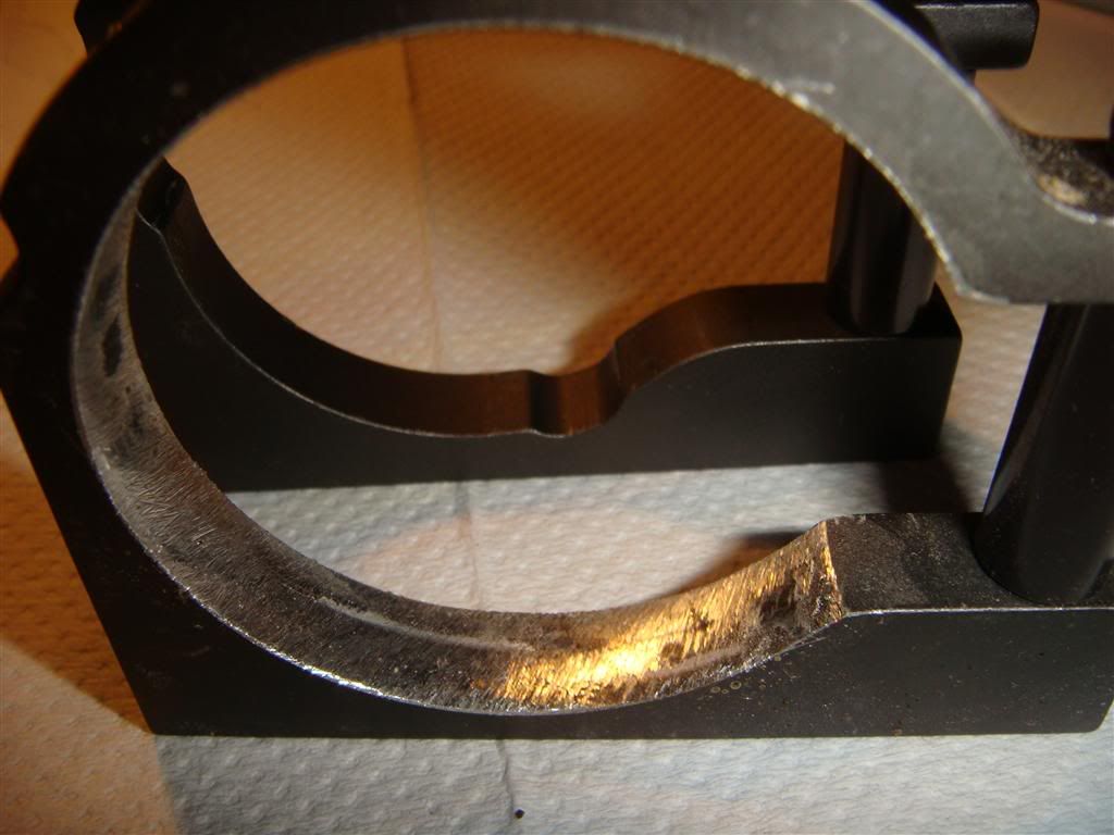

Yes , just shave a little alu. of the Clamp and u should be ok with CC motor...
Here a few pic. how i did it...
And these where shaved for evena bigger motor...

Thanks for the pics knez... does it matter if you take of a little too much in parts? obviously its going to be hard to get perfect....I see you are also usnig a washer... Is it all a tight fit???

Yes,i am using 2 washers on each clamp,tightened the screws step by step... clamps fit the CC motor perfect.
