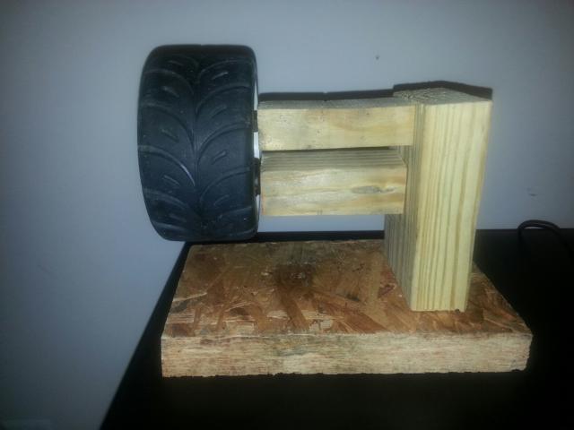

The saying is those that can't play, coach. I say, why buy when I can build. I needed a way of balancing my wheels so I built my own wheel balancing rig. Functions perfectly and I hope to get all 4 wheels balanced tomorrow.

Here is my wheel balancer. Using some spare parts from a DM1 roller and some 2x4 I had lying around...I built this. Not much to look at but works great and the best part...is was free. That is a win win.
