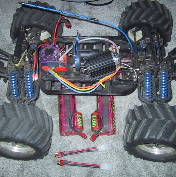

08.20.2005, 09:24 PM
ehers a pic of the job i done
wut do you guys think??
  Send a message via AIM to Shadow350Z
crazyjr
crazyjr's Avatar
Posts: 3,794
Location: georgia
08.20.2005, 11:56 PM
Looks good shadow. Hey serum. How do the wires change polarity if they're too hot? By traveling down to the esc? Or, Are you just kidding the kid? If you are serious, thats a new one on me
dabid
08.21.2005, 03:00 AM
I think that your gravity powered motor mount won't work, but if you get Serum's magical methane cloud working for you..........:D

08.21.2005, 05:46 AM
if your wondering why the motor aint mounted cuz
the set screw on the pinion came loose so i had to put blue loctite and let it dry
