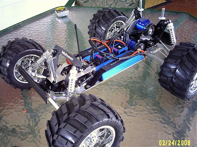

Try this.
http://www.rc-monster.com/forum/showthread.php?t=9954
Name:	alexandertk (Medium).jpg

yea triggeraa you've got those aluminum gears which i may very well get haha how's it hold up to dual venilons...and guys this truck is huge like trig's actually same car just way less modded...I am not looking to set speed records but i do want good run time and decent speed also wanna be able to run like i said 8 cell packs up to 3s possibly
i think i'd want at least an l can motor so it wouldn't be struggled too much and because from what i see you don't have many gearing options on this truck
http://www.hobbycity.com/hobbycity/s...ess_Motor_(FIN)
this +
mm+8cells ok?
