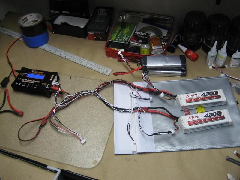

I used BrianG's page as a guide.
I use my harness to balance/charge two 3s packs as 1 6s pack;
http://www.scriptasylum.com/rc_speed/_lipo.html
here's his guide/pic for a 2 2s- 4s set-up
<a href=http://i87.photobucket.com/albums/k137/darrajsam/bottomline.jpg target=_blank>http://i87.photobucket.com/albums/k1...bottomline.jpg</a>
I used a "bottom" line.
