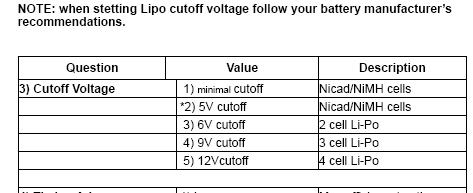

I am going to config my EP boat, CC's HYDRA-120 seems to be a good fit, but I found its specs are confusing:
Q1)
Spec says the Hydra supports 6S LiPo with external BEC, but inside its manual, the HIGHEST Cutoff Voltage is only 12V for 4S. See the picture below
Does this ESC support 6S LiPo auto cutoff? How to setup the right voltage value for cutoff?

I had one in my lst2 project and the only way to get to a higher voltage cutoff is to use a castle link and set it in the custom cutoff voltage

I dont belive it has the auto lipo but you can set the cutoff voltage for a 6s lipo. I had mine set at 15.4volts for my 5s lipos.
I was upset when I looked at the instructions and seen that it only went up to 4s cutoff and said that anything past 3s would void warranty. I talked to castle about it and he told me it only voids warrenty if you go past 3s while useing the internal bec(OK). So I told hin that it only had up to a 4s lipo cutoff and the box said that this esc could handle up to a 6s lipo????? He told me that the only way to adjust the cutoff past 4s was to use the castlelink and go to the custom cutoff voltage and ajust it there up to a 6s lipo. It does go up to 6s but I only was useing a 5s lipo. This esc didnt have any issues push a 9xl feigao in a 14 pound truck. If you plan on going with more power than that I would suggest putting a heatsink on it and/or a small fan!!!
