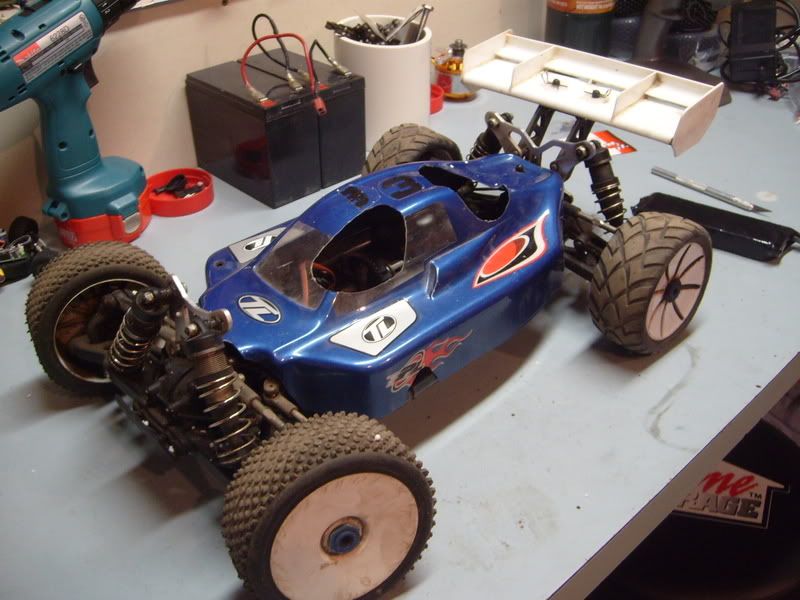

I got it today. There are quite a few missing parts but for 120 bucks it aint bad. I'll see if they guy can find the missing bits and peices...

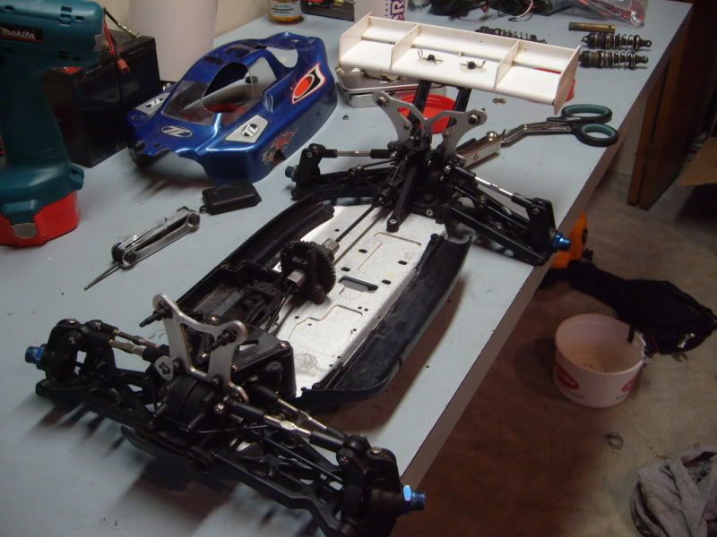

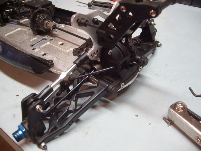

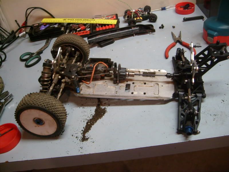

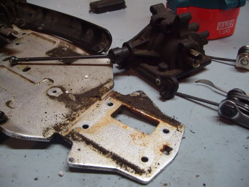

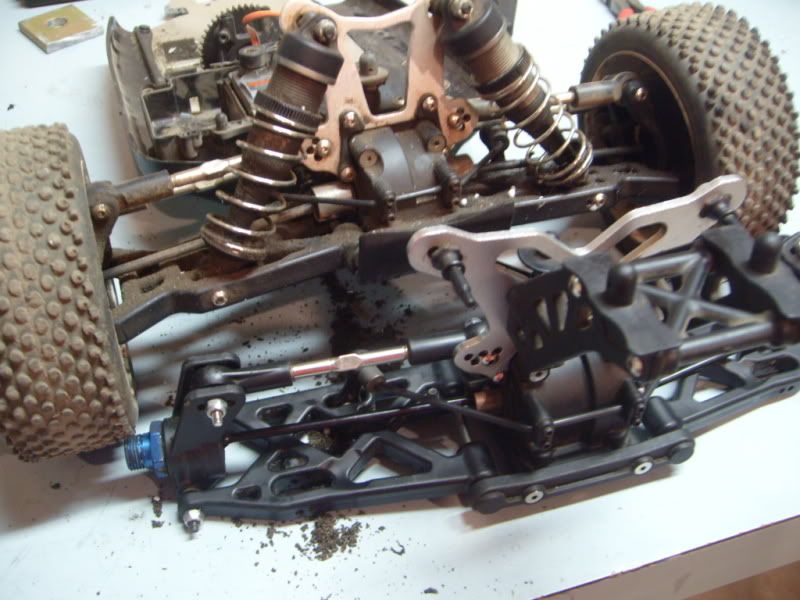

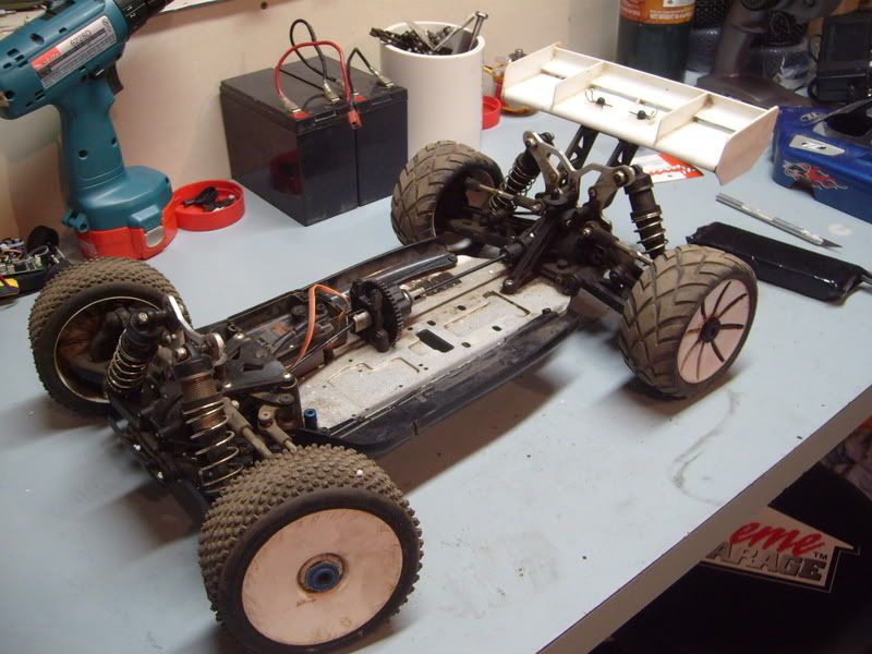

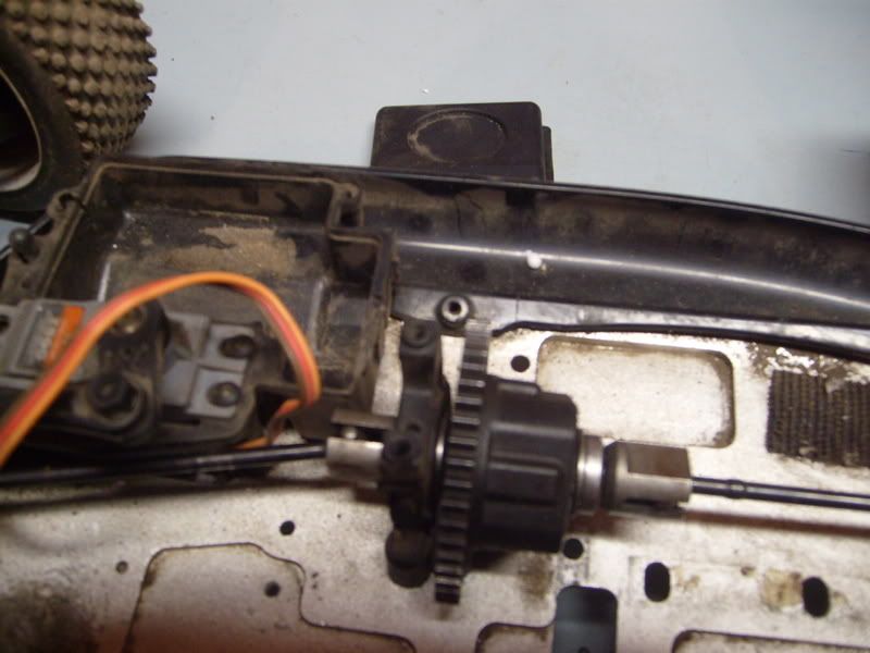

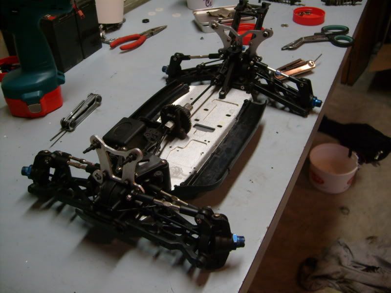

Today, I got the 8ight cleaned. I'm done except for the shocks.

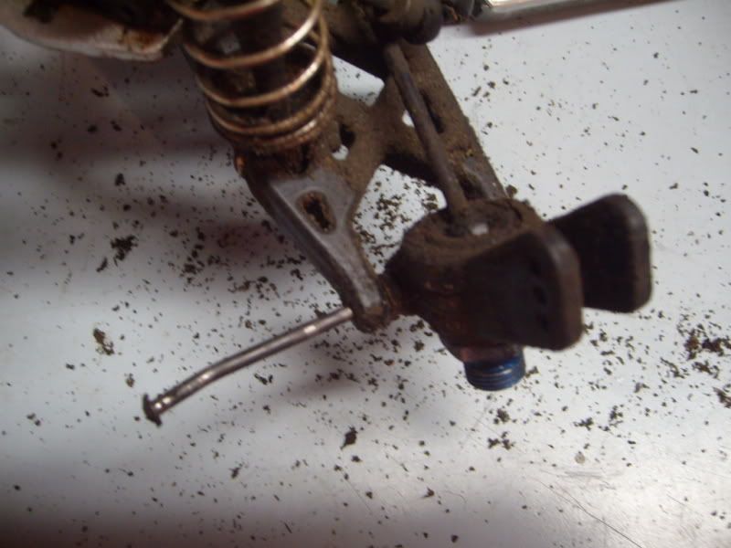

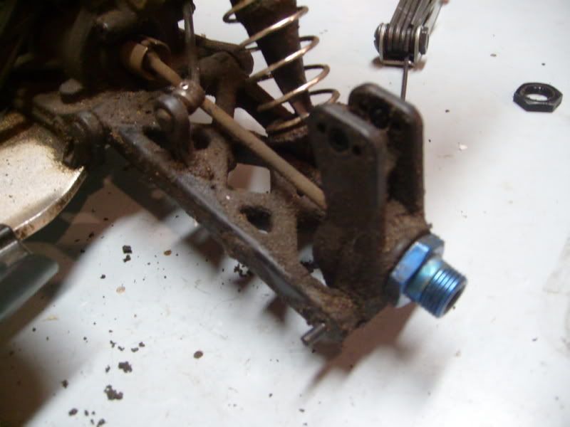

This hinge pin was bent. I was able to bend it back, but I can see it being a problem in the future.

Those outer rear hinge pins bend easy. Get the ones for the 8ight 2.0. They are thicker, but it is really easy to drill out the hold in the arms and hub.

good job with the cleanup what did you use?

I took it all apart and used a rag for wiping and a hobby knife for scraping. With a few parts I took a small peice of cloth soaked in oil and rubbed it down.
I'll use the 2.0 rear hinge pins next time I need to pick some up. Thanks for the info. I got the shocks finished and filled with 45wt oil. It's a little thick but it should work good for onroad bashing.
