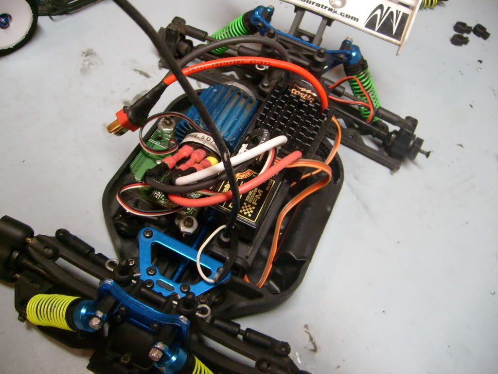

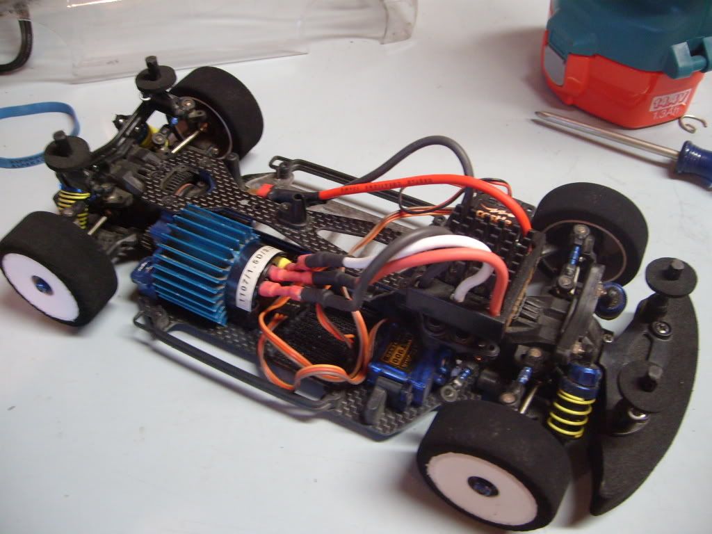

I remember seeing quite a few people run Neu's in their rc18. It might take a little modding or an aftermarket mount I guess.. I have had a Neu in my old recoil and my vendetta st. The 1107 I had in my detta was best.. holy crap... 8500kv custom wind on 2s. I had to trim the chassis a little and the motor almost touched the servo.... insaine...
Heres pics of the detta and recoil
Same setup in both in the pics, but I had a 1105/1....5y? in the recoil with a cheap ass suppo 40a esc. It worked, and worked great. Kind of funny having a $10 esc powering your $100 dollar motor in a mini.
