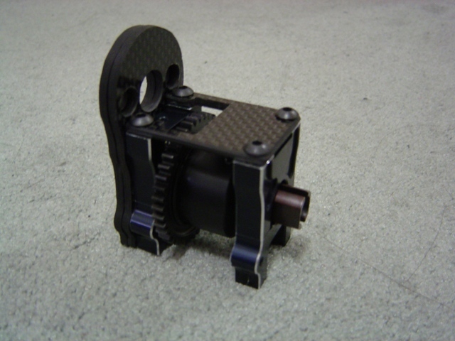

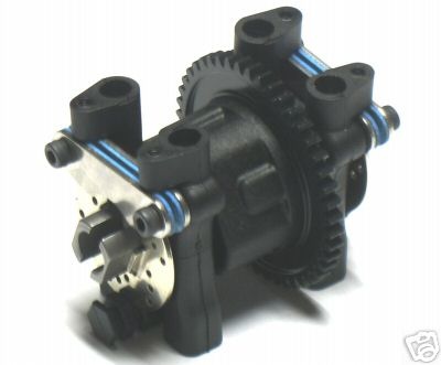

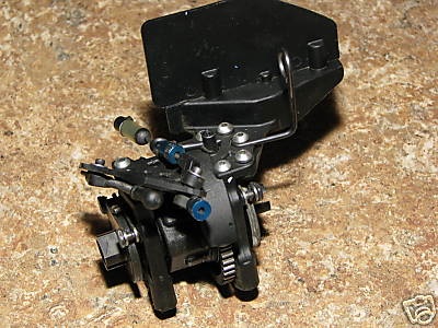

Hey guys need some input,
I have done some reading and read that the Xray 808 center is a good upgrade for 4wd or revo stuff. never heard of xray though
But I see Losi muggy and Losi 8ight centers.
What is the best for center differential, stronger more popular ?
Parts availability , good for brushless , and stuff
Advice, your experience, suggestions ? ? thank you

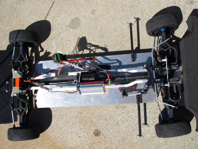

My build is below custom 1/5 Emaxx/revo /Losi brushless All4wd Rally car
Pics
Losi 8
muggy
Xray 808

I like the losi Muggy ones, the 8ight and sportwerks parts are all interchangable just the 8ight uprights are different. These usually are easy to find as well as cheap.

Yea that makes sense, I forgot to mention the Wheel base is 20 inches, so no wheelies on this beast
a drifter guy said he likes rear diff.
so whats so cool about the emaxx diff Bulkheads is you can loosen one side and remove the Center and swap front to rear
My concoction is
Muggy/LST gears,
Aftershock Alum housing
Emaxx bulks
Revo shafts
and changing to Revo rear arms for Front and Back
1/8 wheels 4.4" tall
NEW Question: Is there an issue with power/Speed change from an emaxx tranny to the more direct Xray or Losi Centers ??
I would like to toss the Huge Emaxx trans and drop in a losi center, but unsure about power change ? I'm probably over thinking again. ANy Suggestions/Thoughts ??
Thanks

If you go with a center diff or spool the only issue to worry about is changing your gearing. Power won't be an issue.

I want to toss the Big emaxx tranny as I doubt it durability against a 5S Lipo
Also want loer CG.
Looks like I find a Losi or muggy and Make a motor mount for it
