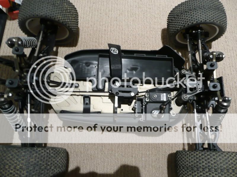

Has anyone ever had issues running the stock 48t spur, with the Losi battery tray, and having the spur rub through the rear battery strap??
its way too close for my liking.
I'm thinking of moving it into the rear position, which requires me to drill a hole in the chassis for the from screw mount.
brushlessboy16
brushlessboy16's Avatar
06.30.2009, 08:31 AM
Just get the Rcm battery tray.It will protect the pack better and allow you to adjuSt mounting position.
primus95
Posts: 80
Join Date: May 2009
07.01.2009, 01:29 AM
Thanks BrushlessBoy but for $60 for RCM tray & shipping to Australia, I think I'll be drilling a hole in the chassis and moving the Losi tray to its rear-most position. All hole line up except the front one.
I can almost buy a 4s lipo from hobbycity for that price.

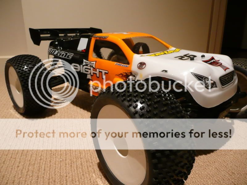

Here's an update on my 8ight-T - getting through the build
Body all painted and stickered up
I finally got to drive it today and all I can say is . . . .Oh my f*#king god!!!!!!!
With a 5s1p Neu Lipo this thing is crazy powerful. I was running 14/48 and it would wheelie easily @ 40+ MPH . . .my poor wing got a belting
I did some long speed runs through short, muddy grass and took temps when the battery hit LVC with a Raytek Laser temp gun:
Motor = ~145 (not 100% sure where to measure - hotest part was near where the wires come out the can)
ESC = ~100
Battery = ~ 100
What a machine . . .I'm absolutely stoked!!!!!!!!!!!!!!!!!
Thank you to everyone thats answered all my stupid questions throughout the build process.
OZ-RUSTLER
OZ-RUSTLER's Avatar
Posts: 201
Join Date: Oct 2008
Location: Sydney, Australia
07.12.2009, 03:27 AM
Nice looking truggy Primus. Great work on the body.
primus95
Posts: 80
Join Date: May 2009
07.12.2009, 04:55 AM
Ahhhhhh, its dead on the second run, I'm so gutted. I've been scraping money together for months to get this going and the ESC has burst into flames seond run :(
