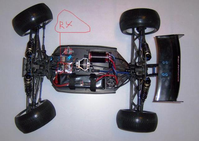

Give us a layout? I remember my 2.4 DX3R twitched very slighly when I had a really big power cable right next to it, moved the RX further away and whabam, no more twitching.
e-rev project
02.24.2010, 02:26 AM
this is the stock rcm photo, mine is identical
tried a hs-5625 servo

For giggles, try disabling the BEC and using a receiver pack. Spektrum receivers tend to be sensitive to noise on the power line. If that doesn't help the problem, then the power supply (BEC) is not the problem.
Other than that, keeping low-level signal wires (antenna, servo/throttle cable) away from high current wires (battery, motor) is good practice. This type of noise should not affect 2.4GHz, but you never know.
