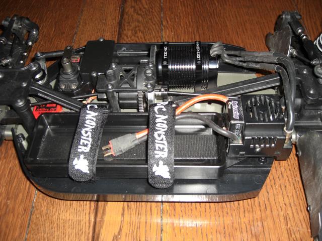

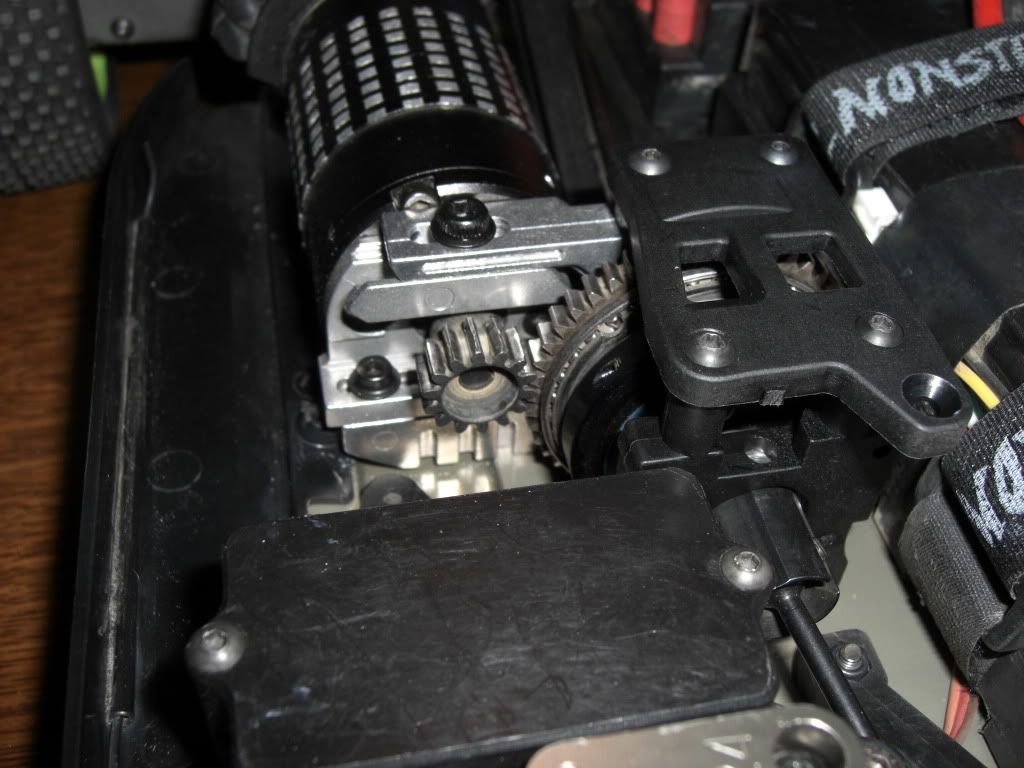

Finally made time to finish putting together my RCM/D8 kit and here are some pics and again thanks Mike for making such a sweet kit!

Looks good! A lot more pinion room than the cut off stock radio tray gives ya.

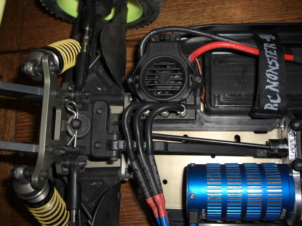

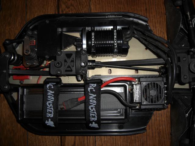

The latest changes to my D8. Some free pieces from HPI after simply writing to them about the unpainted Vorza body and body mounts, they sent those and a whole sack of other pieces, the rear brace with the wire guides built in, the brace didn't fit so I cut off the wire guides and glued it to my rear brace also sent the center diff top brace and the front steering/diff brace. I'll install the body mounts after the new body comes in.

Looks pretty good! how does the body fit?

Rite now I use the jconcepts illuzion body and it fit's well enough, but I think the Vorza body will fit better because the sides are a little higher.

How's the weight balance, left to right, George. I have an opportunity to pick up a D8 and would want to go electric on it but noticed the motor is WAY out there on the right hand side. Just curious how it's running.
georgec
georgec's Avatar
Posts: 376
Join Date: Oct 2009
Location: Nashville,TN
03.15.2010, 06:20 PM
The balance for me so far seems quite good, I run 4s 5000mAh batteries so it seems to offset the weight of the of the motor. Front to rear seems good also. Although I have only ran a few laps with the D8 in this configuration it felt very stable in turns and jumped fairly flat. First race of the season is this Saturday so I should know better how she works in race conditions after that. Will post results Sunday!
Wish me luck.

George, what brand is that blue motor?
nitrostarter
nitrostarter's Avatar
Posts: 3,156
Location: Gramercy, LA
03.15.2010, 07:17 PM
Hobbywing
