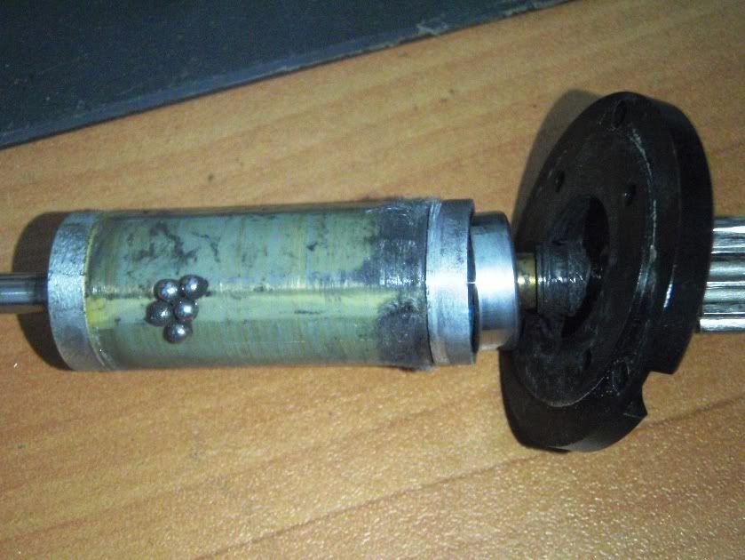

I really tried to do my best, cleaned it after every run and adjust the mash to be at optimum.
But it happened... I blow the front bearing of my motor on the track while in the air.
I hope the Rotor is still OK, going to test it with new bearing.

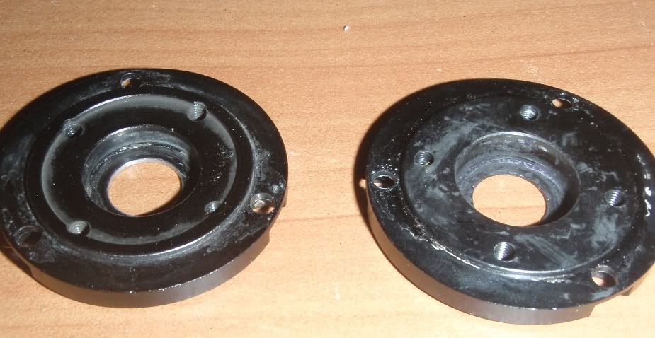

I replaced the bearing with new one but the same failure happened again, I didn’t perform any kind of maintenance this time.
I suspect that the front cover of the motor might have something to do with it.
After the 1st bearing failures I replaced the front cover with new a cover from Castle (got it with Rotor under warranty). I compared the cover I got from Castle to my old cover and found out that there is a different with the bearing housing. The bearing housing on the new cover is thinner and has more room for bearing play.
Look at the picture below, the cover on the left is the one I got from Castle.

Wow, 2 times front bearing ??? You are total unlucky man, sorry for you :(
The second bearing fail after how many batteries ? They suppose to hold a lot of time... Did you use the new rotor ? Maybe your first rotor is unbalanced, and do a lot of vibrations, resulting in the bearing failure.
Moreover, the bearing is suppose to be glued in the end bell to avoid the play you mentioned...
Anyway the 2 accidents are maybe linked, maybe steel of the pinion get in the bearing, is your pinion prematurely used or ?? You are doomed ...
Contact Castle support, their are very reactive and will take car of you. Good luck.

Bearing failures are extremely rare on the 2200 -- we use a high quality NMB bearing on the 2200 motors.
If a bearing failed after just one run -- immediately after another bearing failed in the same setup, I'd be a little suspicious of the setup, and I'd be concerned about the original rotor. If the rotor is bent (even a small bend) the bearing will fail.
Did the rotor get replaced as well?
The new front end cap doesn't change the bearing housing dimensions or tolerances.

Benji
06.15.2010, 01:51 PM
Yes, I replaced the Rotor with another one I got from Castle, I dont think it was a new one. (see the thread about it).
http://www.rc-monster.com/forum/showthread.php?t=26172
The bearing failed again after ~1 month.
I have so many issues with this motor: Rotor failure and Bearing failure X2.
I don't think its an issue with the setup, I'm running 4S geared to ~35mph.
