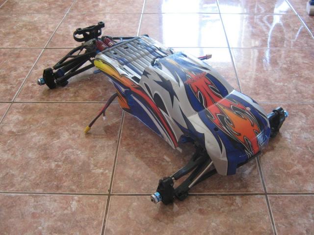

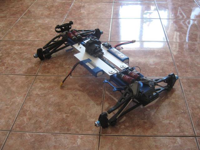

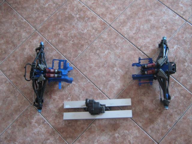

Hy there... for the first sorry my bad english.
I saw this thread of a 1/5 on road car made from traxxas parts... http://www.rccrawler.com/forum/showthread.php?t=145172
This is a video of what I hope to get http://www.youtube.com/watch?v=lGm-tL2xGvs
The motor will be a 2800kv 36mm74mm http://www.hobbycity.com/hobbyking/s...hless_Inrunner
The esc is a hobbyking 150A http://www.hobbycity.com/hobbyking/s...dProduct=10370
Two 3s 5000 turnigy
13 cm diameter on road wheels
Now I want to make a sway bar for the front axel.
What do you think of the motor?
If i get 100km/h im a happy guy

Motor is not gonna last long.. way too much rpm..
08.07.2010, 06:37 PM
If he runs it on 3s... Yeh, needs to go to a 1600kv motor for 6s.

That 2800kv motor will not push a 1/5 scale car to 62+mph successfully....
The video you linked was using a CC/Neu 2200kv motor. The motor is a man compared to the child of a motor you want to use.
N. Rustler conversion
08.08.2010, 03:14 PM
Indeed, the setup here seems a little 'confused' for what the OP wants to acheive. A 1/5 scale onroad, on 6s lipo, that would be a great candidate for the MMM & 2200v motor- a 2800kv motor on 3s is barely suitable for a 1/10-1/8 onroad.
I would suggest a hobbywing 150amp esc, ~1600-1900kv XL motor and 6s for a fast setup, bit cheaper than the MMM and should hold up alright.

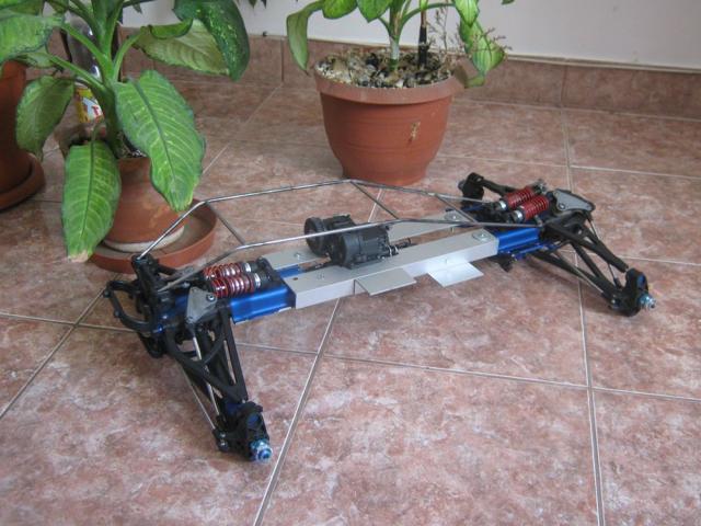

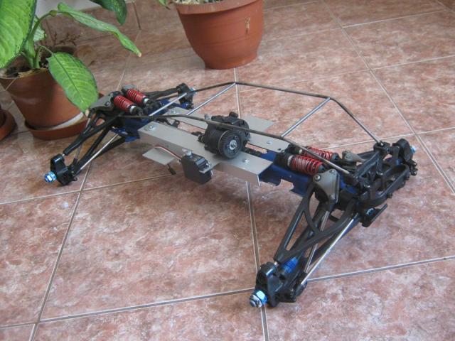

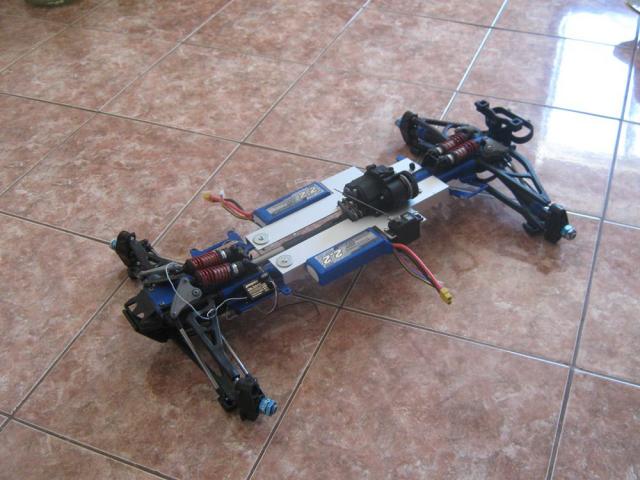

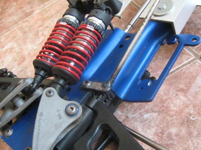

08.11.2010, 08:03 AM

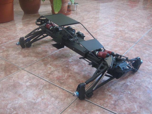

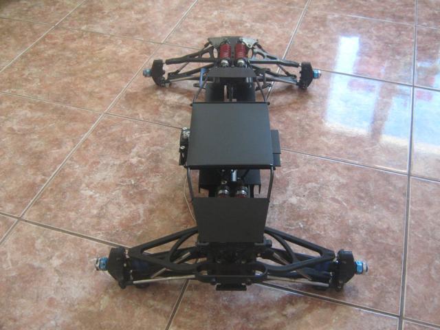

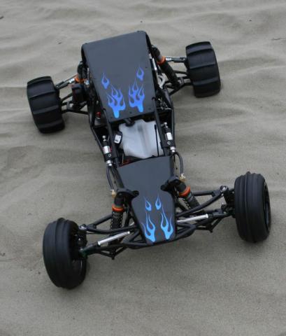

OK i changed my mind... I will make it a baja tipe car...maybe a sandraill tipe car.
So i started on the roll cage.I will be more complex but I need to figure out how I want it to look at the end.I like the black sandraill in the picture I posted.

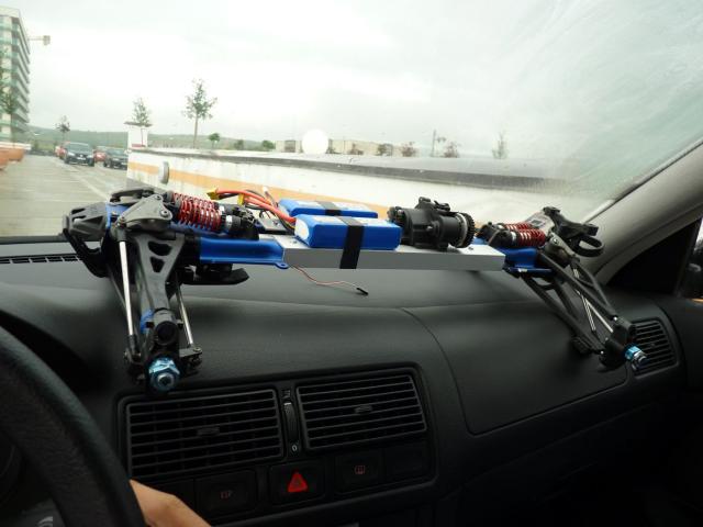

08.14.2010, 05:09 AM
Made a short video of my progres... http://www.youtube.com/watch?v=vxSIrvibbtg
I will use the 1900kv motor and 5s lipo.

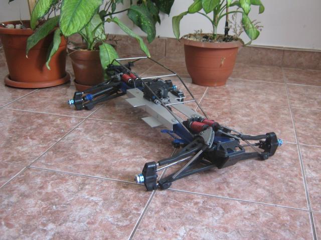

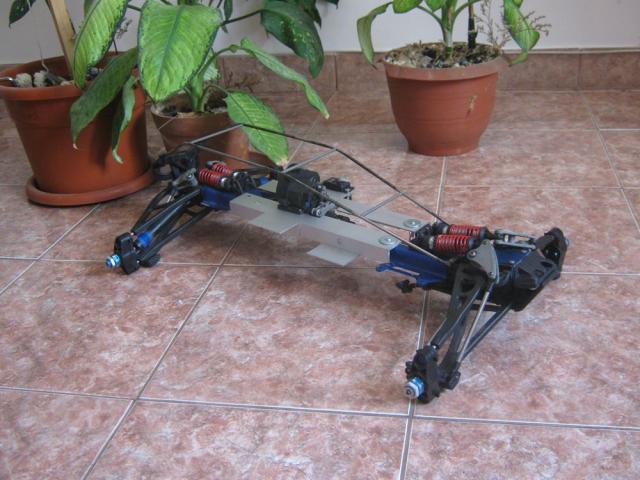

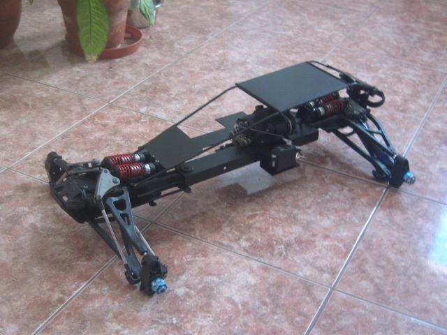

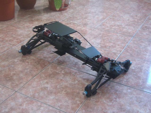

09.05.2010, 11:57 AM
New pic!
ID:	9312   Click image for larger version
ID:	9313   Click image for larger version
09.05.2010, 12:28 PM
Thats looking pretty cool so far.
