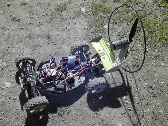

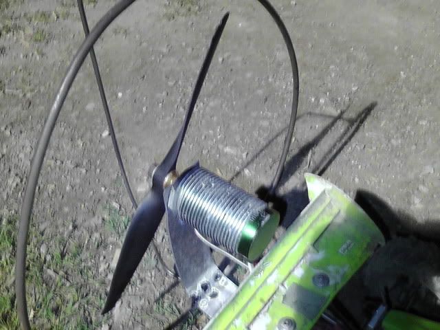

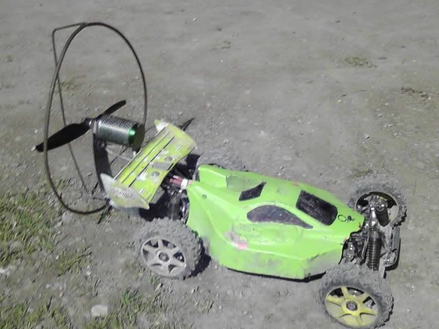

at this moment I making one:
-1/8tt ofna hyper 8 pro chasis
+castle neu 1717 motor
+mamba monster esc
+3-6s 45-90c lipos
+10x10 or 12x10 plane propeller
soon photos/vids

today I finished the project .......... and the sound of the propeller is fucking awesome ....... generates more noise than a glow motor ..... is crazy

whats the max rpm at full throttle? you may be overtaking the useable rpm of the prop with a motor like that on there. as long as its below 12000 it should be alright though.

wow, that thing has a bunch more kick than my EDF-powered projects. Buggy chassis much lighter than monster truck.
how do you like the handling with all that weight behind its rear axle? my TT-01 handles like crap with its fan hanging behind its ass Even if it handles badly though, there's nothing like building something unconventional and taking a break from the norm.
A 1717 on 6s is 35k rpm, quite a way out of the efficiency range of a direct drive propeller (the air version is a heli motor, after all). My EDF setups have smaller blades and lower Kv motors, which is why I can crank them to 26k rpm and still have them thrust well.
Oh well. As long as you're having fun.

Try a wood prop. You'll get more thrust at higher rpm because it won't flex as much under it's own force. There will be higher A draw on the system as a result so watch temps.
