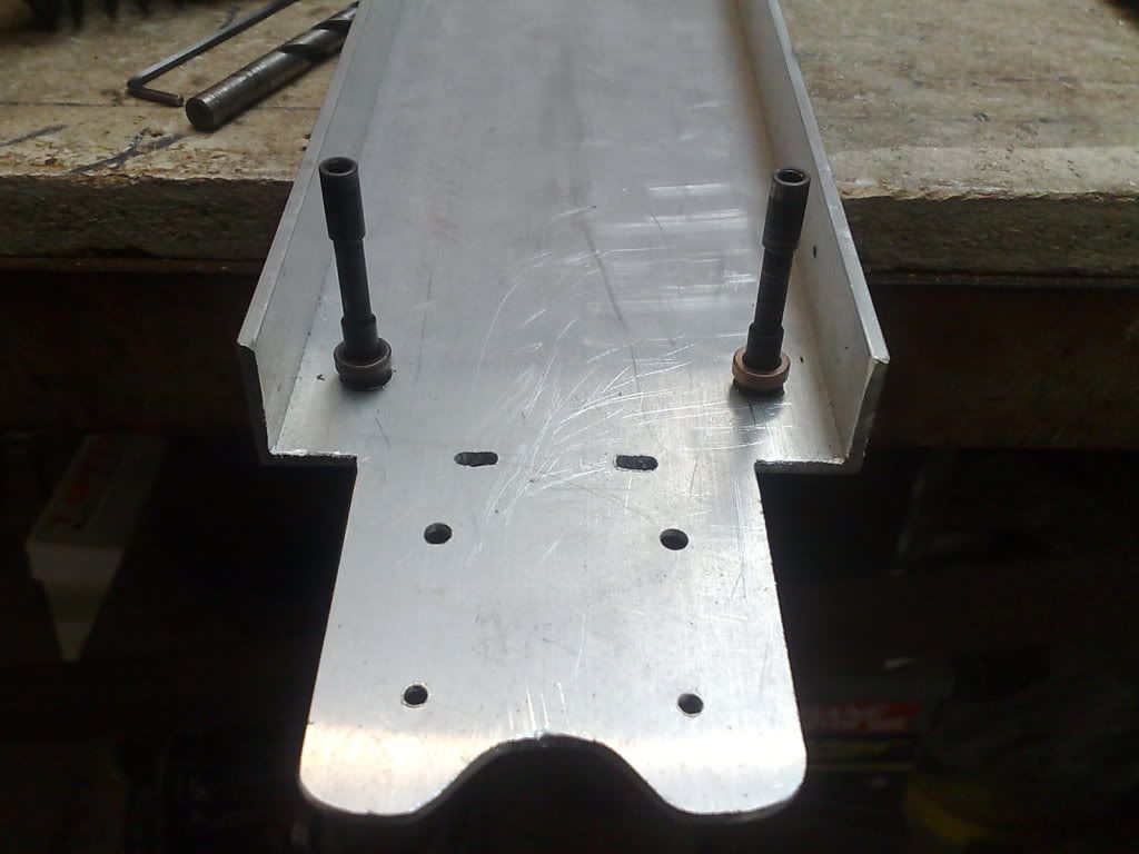

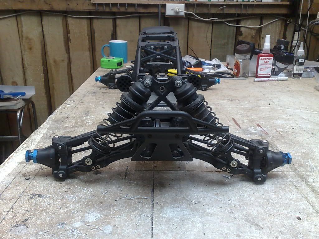

Ok guy's i built this about 5 months ago.
It's based on a Muggy with a stretched chassis to meet 1/5th scale length, I picked up a Muggy as a roller and the idea started from there.
ESC = Hobbywing 150amp
Motor = CC 1717
lipo's = 3s 5000mah in series
And this is where it all started......

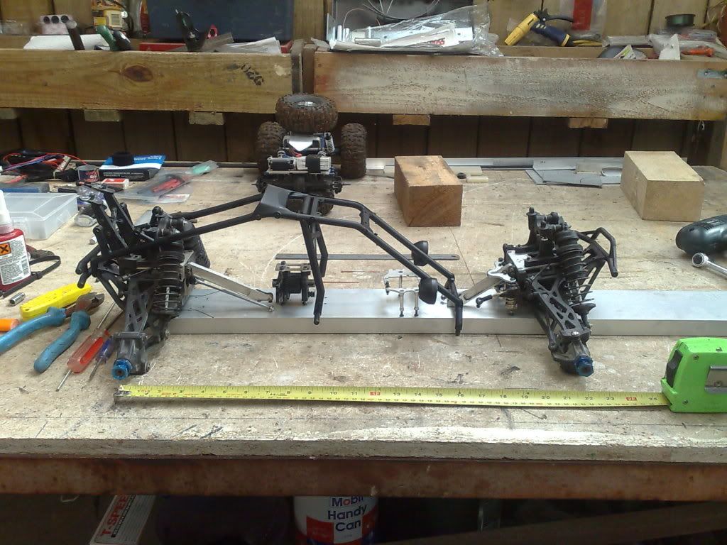

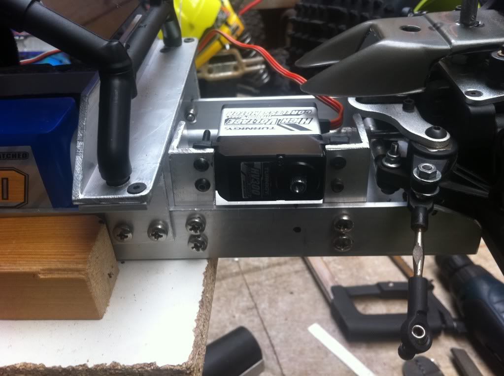

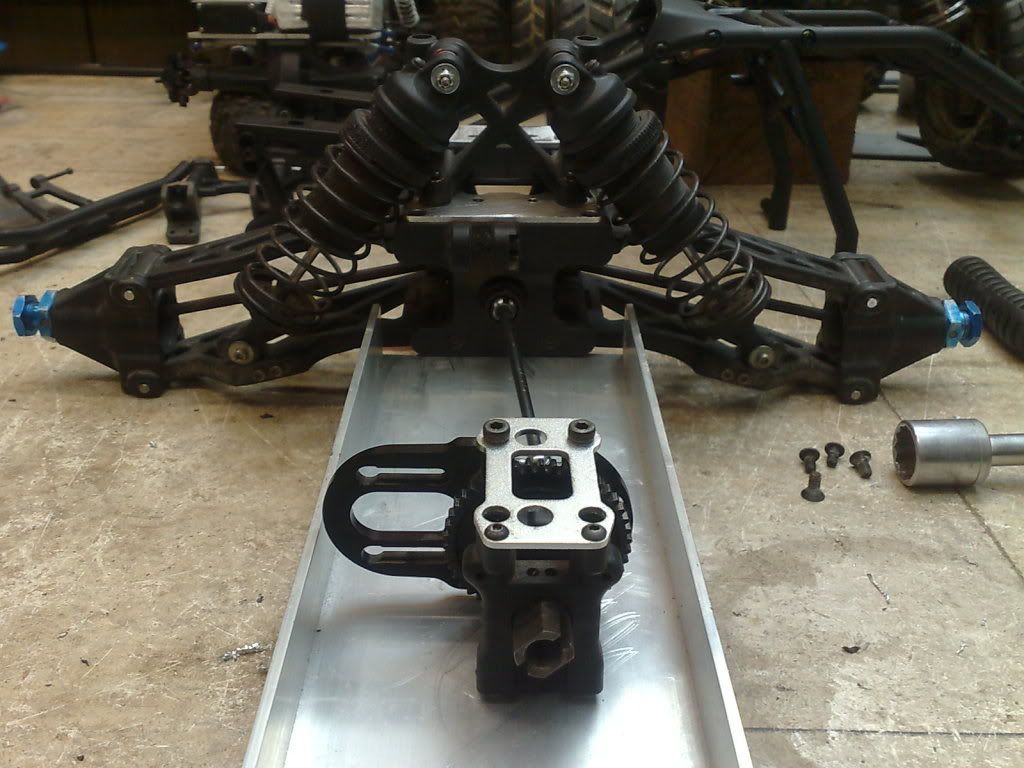

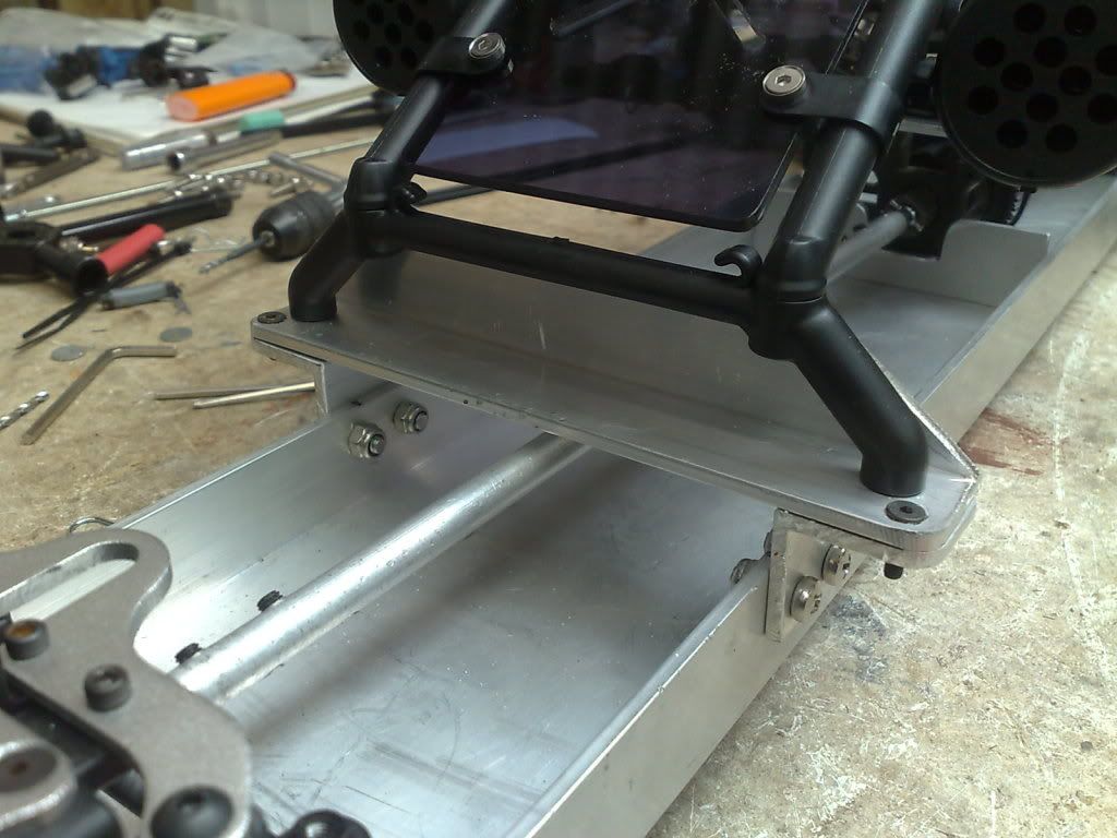

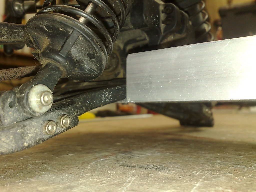

Here is the front of the chassis
The back of the chassis
The centre diff mounted
Front mounted up
Some close up's
The Baja rear bumper mounted

Starting to take some shape at this stage

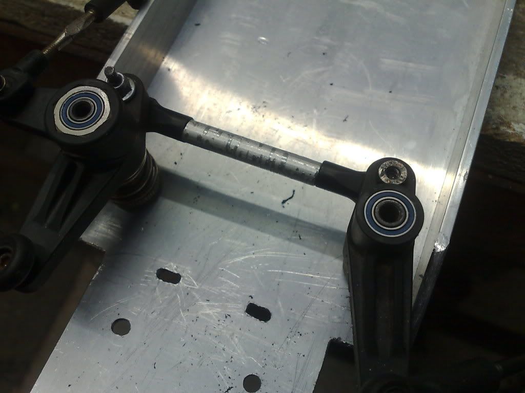

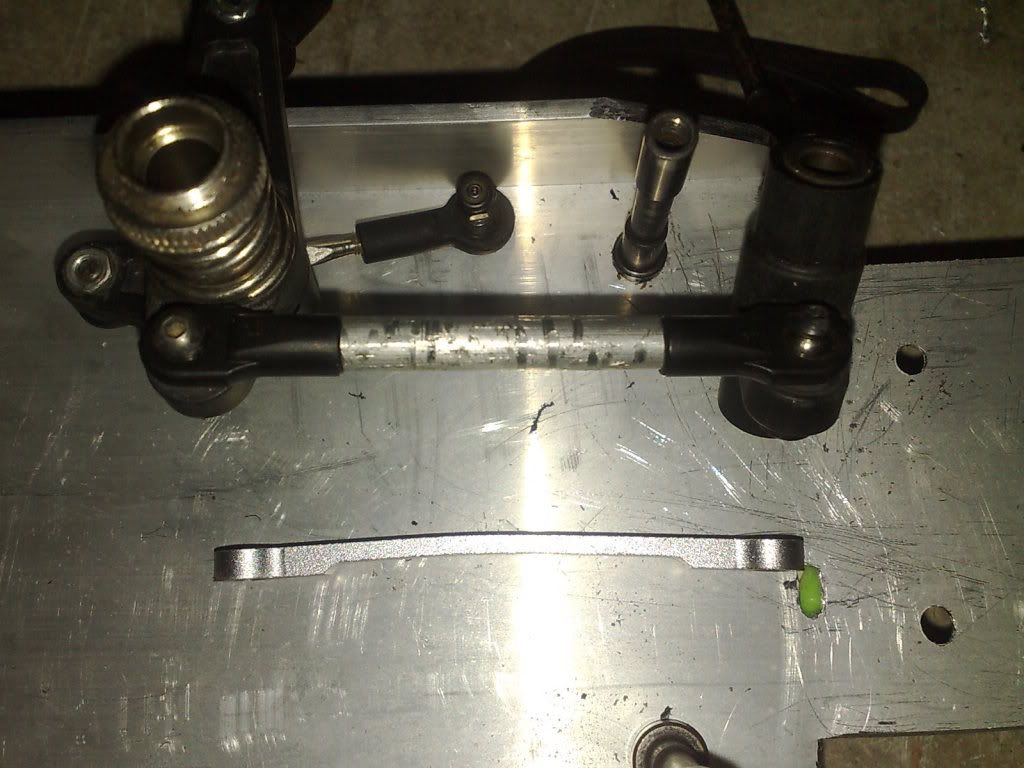

The muggy link is as you can see very thin and easy to bend so i made my own link, much bigger.
The rear tower was very short so i got one that straightens the shocks out
v8hatch
Find all posts by v8hatch

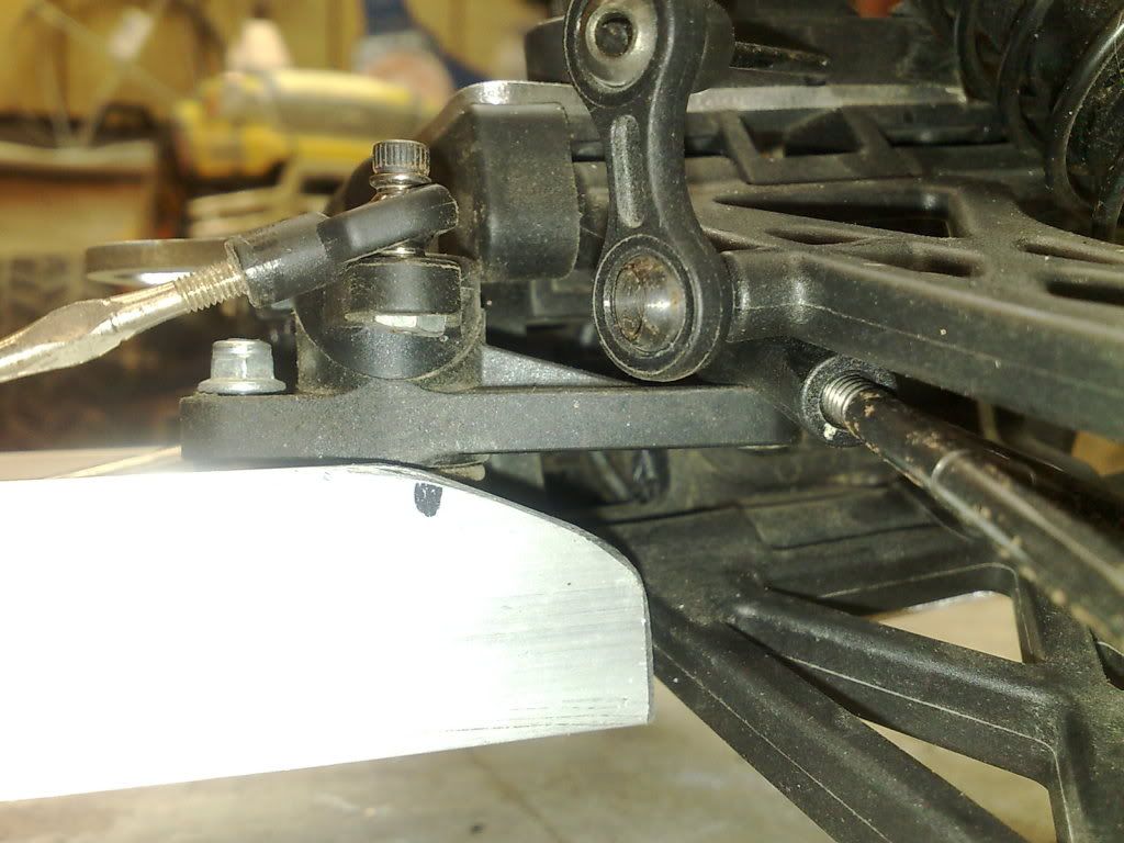

HHHhhhmmmmm bearings much better
Mounts for the front of the boll cage
much bigger than my truggy

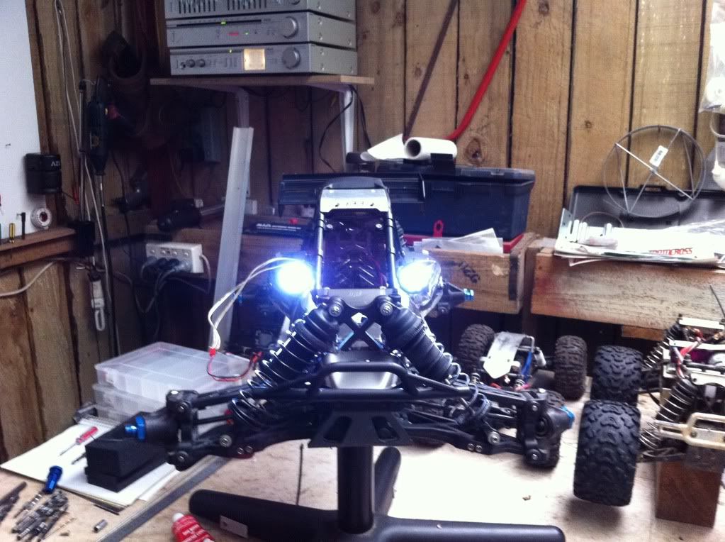

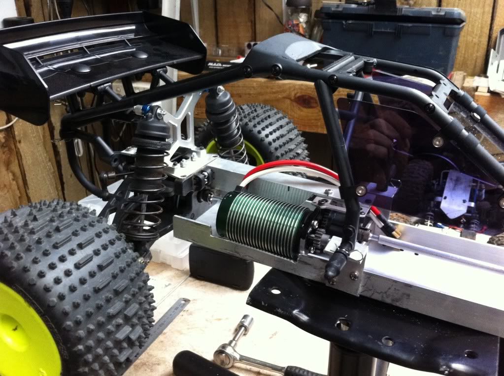

Ok motor fitted up
Some lights

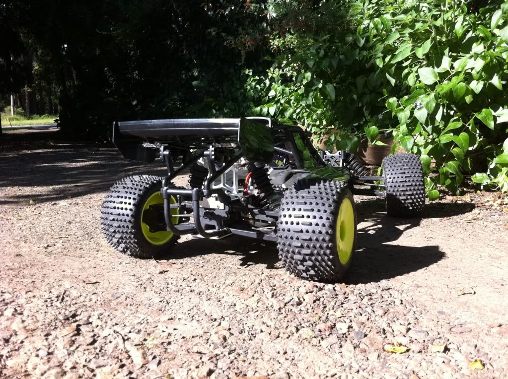

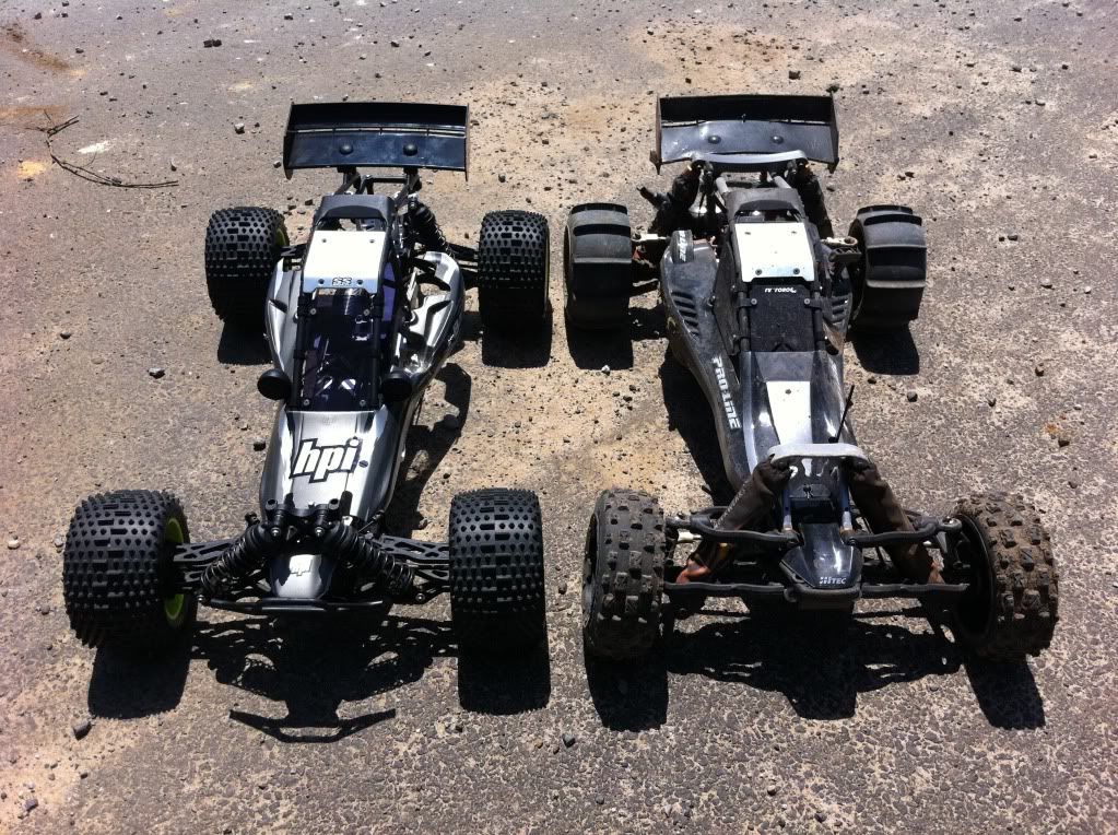

Sitting next to a real baja 5B
v8hatch

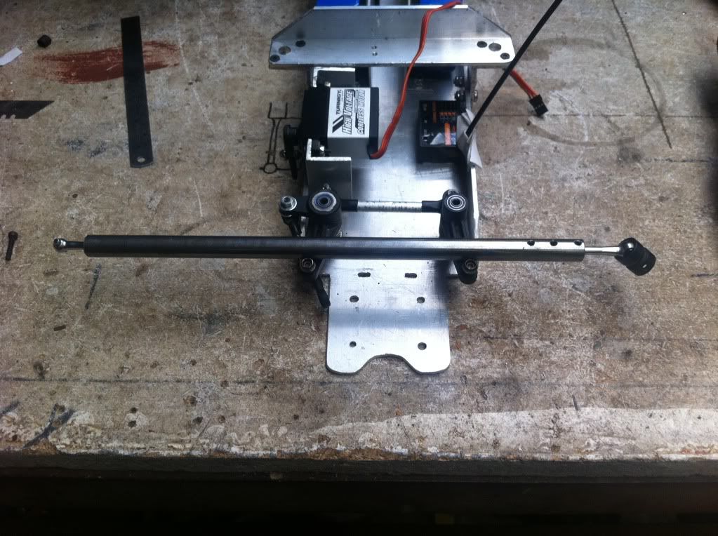

The front alloy prop shaft did't last long so a 12mm steel one now sits in it's place.
Got a 33kg servo that can handle up to a 3s lipo from HK for about $80 delivered.
