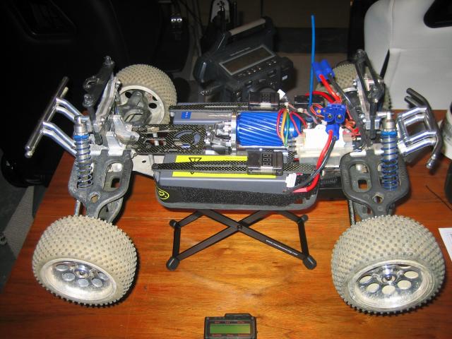

After six years I decided to start tinkering with my old CF G2 Gorilla Maxx chassis.
I really never liked how the Plettenberg Bigmaxximum sat hi and off center so I decided to go the Center Diff way after much reading on this forum and bugging the hell out of Mike
In the end after having spent hours designing a weak mount, Mike convinced me that his universal mount was the best (easiest and most effective) way to go.
Here is the (almost) final product geared way too high but hey, if ain't broke...break it.

tinuss
tinuss's Avatar
Posts: 137
11.20.2012, 06:26 PM
Looks good and a Sexy motor !!!!

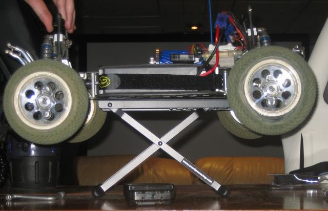

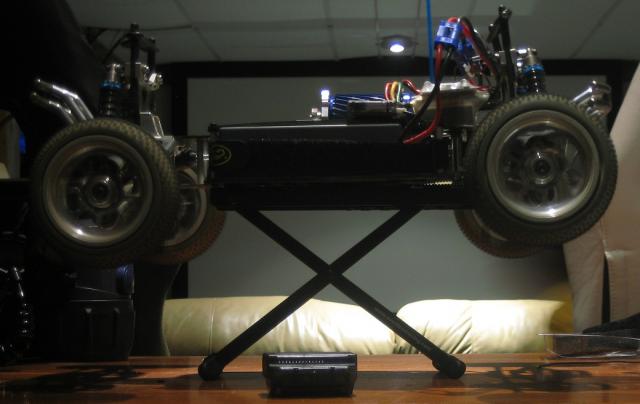

Here are some more pics of the (almost) final product...
PS. The gearing is WAY too high, I barely hit 8,000 RMP and look at the ballooning.

Gearing Calculation
agw
Gearing Calculation - 11.20.2012, 10:08 PM
As I said earlier....way too high... 102 MPH???
Differential Ratio: 2.85
Transmission Ratio: 1
Other Ratio: 1
Spur Tooth Count: 42
Pinion Tooth Count: 15
Total Voltage: 19.50
Motor KV: 2600
Tire Diameter (inches): 4.7
Tire Ballooning (inches): .35
Motor Current Draw: 100
Motor Coil Resistance: 0
Spur/Pinion Ratio: 2.8 : 1
Total Ratio: 7.98 : 1
Tire Circumference (inches): 16.96 inches (430.9 mm)
Rollout: 2.13:1
Total Motor Speed: 50700 RPM
Vehicle Speed: 102.07 mph (163.95 km/h)
Effective KV Value: 2600
KT constant: 0.52 oz-in/A
Motor Torque: 0.27 ft-lbs
Final Torque: 2.16 ft-lbs
Final Power: 1950 watts (2.6 HP)

BTW I took the truck for a test run and there was a little cogging but barely perceptible. Went up to 11,000 RPM which was about 23 MPH and felt crazy fast but I loved how the front was lifting without loosing contact with the ground.

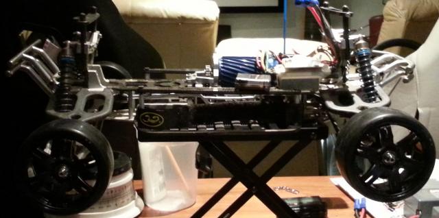

agw
11.28.2012, 09:58 PM
Originally Posted by Klausen View Post
I run Traxxas 17mm hex's with Proline Badland, on the original shiny 2,5 MIP cvd's. I had to mod the Traxxas hex's a bit by drilling from the backside, to make them go far enough into the cvd.
Nice looking truck!
I ended up getting HPI 17mm Hex which use the same size pin I already had (2.5 X 12) and a set of Sweep belted tires already mounted on black wheels. Not as nice looking as the aluminum ones but they feel really solid. I doubt the would balloon at all.
Given the smaller radius, the new theoretical speed is now 71 MPH. Let's see how hot the Schulze gets before I hit 50mph
