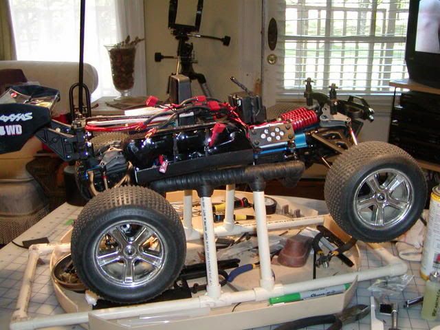

Guys, I just picked up a stock revo roller that was setup for electric but never completely finished. I am wondering if anyone has any setups that involve 12 or more cells using the STOCK transmission. Every converion I see with nimhs uses the E-Maxx transmission. I want to run 12 or 14 cells, here is what I have so far:

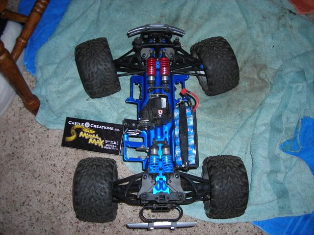

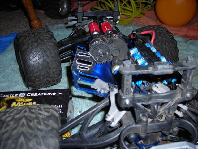

Here's how I did mine. I'm running (14)IBs. It's two (7) cell flat packs shrink wrapped together to form a solid brick. +10 on the RC-Monster mount, it works great.

It doesn't affect the flight at all, several of the members have theirs set up this way. I was a little concerned at first, but lots of runs have now proven to me that it doesn't affect it. You have enough weight offset with the motor, heat sink, servos, ESC, etc.

Have you tried running a Revo with the batteries offset? I have at least 20 bash runs and probably 10 hours of track time on this set up so far and I can't tell any difference from when I had it as a nitro model or any balance difference from my E-Maxx. Like I said before, I'm not the first to try it this way. The main advantage (and the original reason I went this way) was I don't want to deal with two lipo packs when I switch. I'll be going to a 4S set up in a single cell. If you want to make two trays and deal with two batteries, have at it.

I run my batteries the same way Cajun does - in one 14 cell brick pack. To help keep the cells from rubbing on each other possibly wearing away the insulating jacket, I seperate each row with a piece of 1/16" thick craft foam. I then seperate each cell in each row with a piece of paper folded in half and cut to size. Once you heatshrink the whole thing, it works well and gives me a piece of mind. I don't want a cell blowing up in my face because the negative "can" of two cells rub and short out cell(s). :)
And, maybe I'm just not a good enough driver to notice, but I have not seen any negative flight adjustments with the weight on the side. You have to remember that the motor, ESC, and steering servo is on the other to offset this and the tranny itself has off-center weight.
