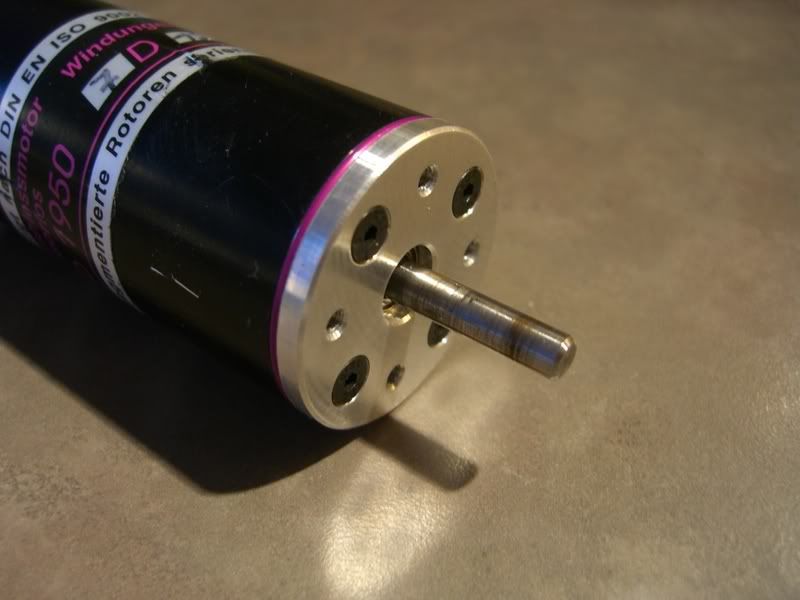

Ask Mike for his Lehner frontbell cover. You'll never have to worry about stripped holes on your Lehners ever again.
Daf
Daf
That sounds great! Do you have any pictures?

It looks like this.
Works like a charm.
to make it...
or break it...

Wow that looks great!
I will definitely ask Mike for a couple of those!

I agree, only use blue lock-tite... the red stuff will ruin your live!
I would also get that Lehner front bell cover as well, that should fix your problem.
