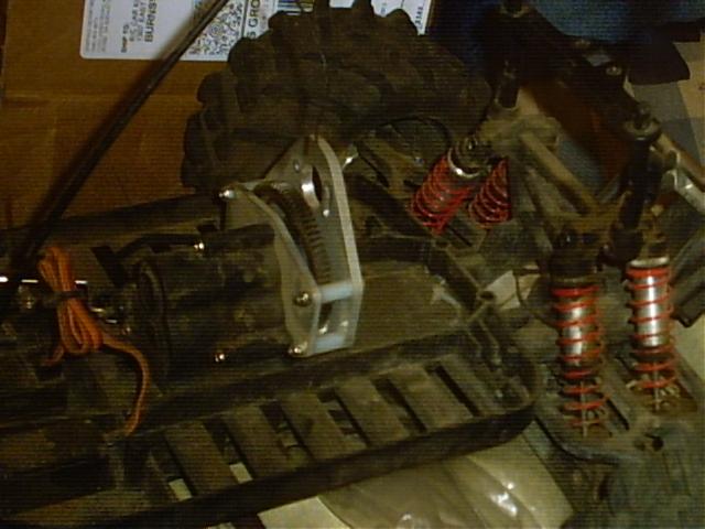

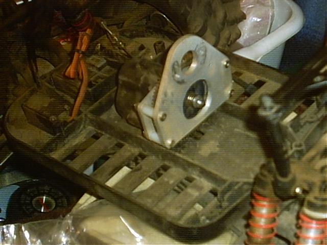

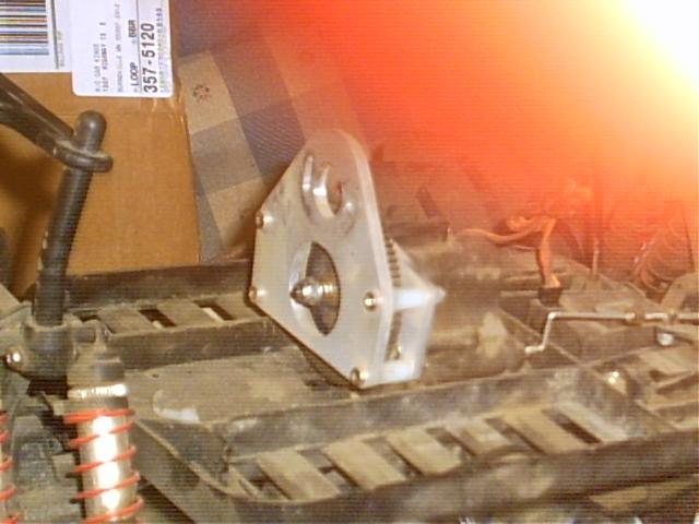

heres that motor mount, I took the best pics I could. I think it may be tall enough to mount above the reciever box, you could then mount the batteries behind the tranny, pull off the g-maxx holders and lose some weight, its here if you want it.................

bluonyx
10.27.2007, 12:54 AM
I went out and did a little measuring and it should clear the radio box with no problems. Got 1/2" to spare. I'll try it a few times with the g-maxx holders, if it doesn't work out then I'll buy the holder that finedesign has. Sending you a PM. Thanks!
