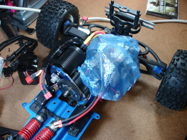

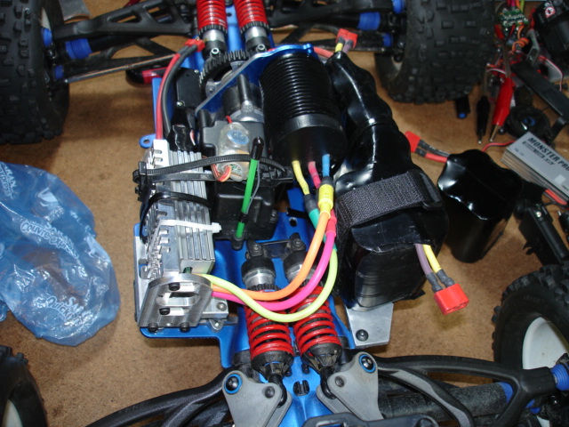

Hey guys, thought I would show my setup for winter driving...
This thing hauls @$$ on hard packed snow (with top layer of snow), and the ESC stays pretty dry, only a few drops of water from snow, nothing to worry about. The runtime seems to be about 20 mins in snow driving with 7s1p pack, and geared for ~42mph. It really cleans the truck up too!

is the truck off balanced because of the a123 cells?
the truck looks great btw!
very clean.
i guess thats what snow does to your truck

That's one hell of a machine, nice setup. Love the way the quark's mounted.

Yeah, it is pretty nice, nothing special though.
The A123 pack does not put it off balance, although, if I pull full throttle and let the tires balloon up there is a tendency for it to veer to one direction, consistently.
The Quark is mounted awesome, i know! I was playing around and found the you can switch the motor mount to the other side of the bottom plate (RC Monster revo mount) and mount it the other way. Really handy, it should get alot of air come summer.

what motor is that ? It can't be pulling to many amps if you get 20min runtime on a 1p of A123 cells right ?

The 7S takes care of that. The energy is there, it's just put in voltage over current, that's it.
I see you found a good use for the motormount!
It amazes me too how well snow cleans up stuff. Cool stuff.

Very Nice ZPB! I like that alot!
Is that a Cap mod that I see? A much smaller one than your completely modded Quark. Just got a new ESC huh? I like that heat sink. Would the Quark do 8S A123 without giving out the smoke?
I'm surprised this much power doesn't blow the lower tranny output gear. I think that's probably the weakest point IMO.
You do have center cvd's I see, so the stock Revo drive shafts must be pretty tough.
I've been looking around for a nice ubec/bec circuit. Does anyone make a version that has a broad operating range? Like from 4S to 12S?
Are you running the stock receiver? Cute little stubby Anty!
Aaah the Badlands! I've been looking at those too. Weight savings!
Nice Battery setup! Twin plugs. You can bring it in after a run, then charge it through the unused one. Good idea!

Yes, it's fairly high voltage, equal to 6s lipo. The 1512 motor is probably only drawing max 45 amps on the low traction surface, but it's different... kinda of a constant current draw from constant wheel spin.
The Quark is a new one, I got it from AAngel... he modded it before he sold it to me. Yes, it works great too with the low temps of -10*C (14F), and the heatsink mount it's on. I have never tried 8s A123... i think it would most likely cog like everyone else is saying happens on 6s lipo on the Quark. About the BEC, doesn't the Kool Flight UBEC go to 45volts? IIRC?
The Badlands are doing great in snow, i was surprised how well they grab, but just enough to still allow for some nice drifting. Also, after a run, once dried off, the rubber is so clean that it becomes sticky, very sticky... when you put it onto a clean surface and pick it up, you can feel it grabbing into the surface.

Nice Setup and smart way to protect your ESC.
