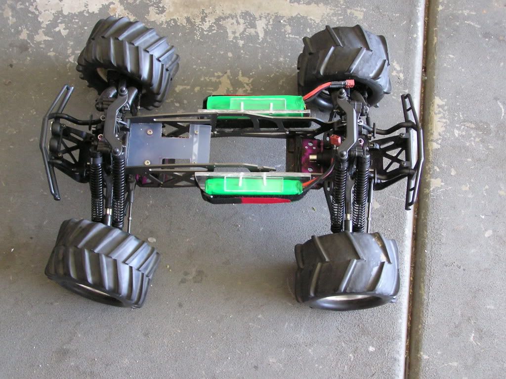

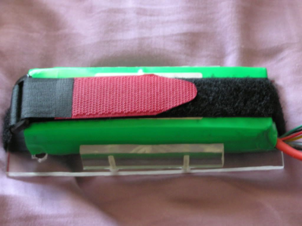

I got some Lexan today and made battery tray things and a motor mount.
traxxasbasher13
06.01.2009, 08:22 PM
I got my battery trays assembled and mounted. All I need now is a Motor, a servo and 2 RCM 8mm drive cups.
Here are some pics:
What do you guys think?
