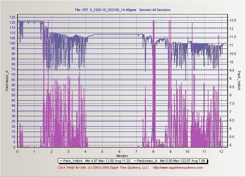

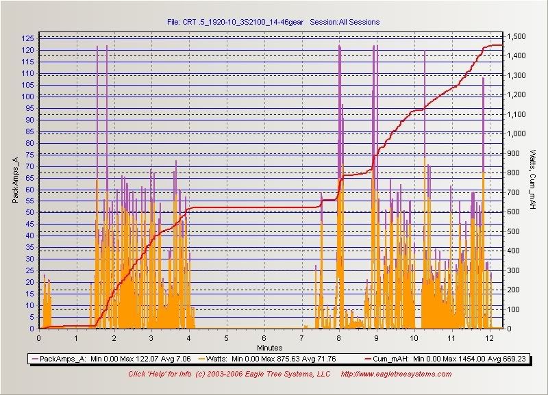

Eagle tree data - I think I need to add some puch control... Not liking these voltage dips
Does that open for you properly? Its just showing 0 values for everything over 18 min run.... ?????
Anyway, here is mine. I just ran it, and its using way more amps than I thought. I have a couple huge spikes, I'm not sure from what, but generally it easily runs 65-70A. I was thinking it was going to be no more than 50-55A. May need a better/bigger batt. It was quite warm after the 1st run.
Setup is a LMT 1920/10, MM, Align 3S 2100 20C lipo, 14/46 gears and 1:10 scale road rages. 2020g with the heavier 1/10 tires. Was doing about 42mph+ on radar, but was hard to get a good # as I was alone and LVC was kicking in on top end I think (no wonder w/ amp load.)

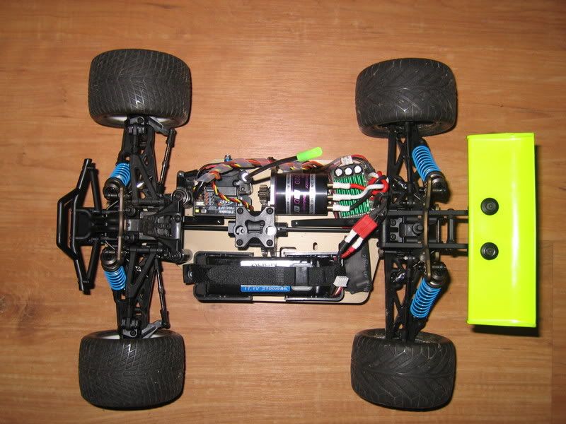

Here's the truck, never mind the mismatched tires. Waiting for the buggy dirt hogs to come in.
Decided to get a Neu 30C 2500 3S batt, and another 4S for spd runs. Needs a stouter batt I think. The 20C 2100 isn't quite upto it. May try to move the MM behind the motor. Don't really need the BEC, but its nice for 6V to the servo.

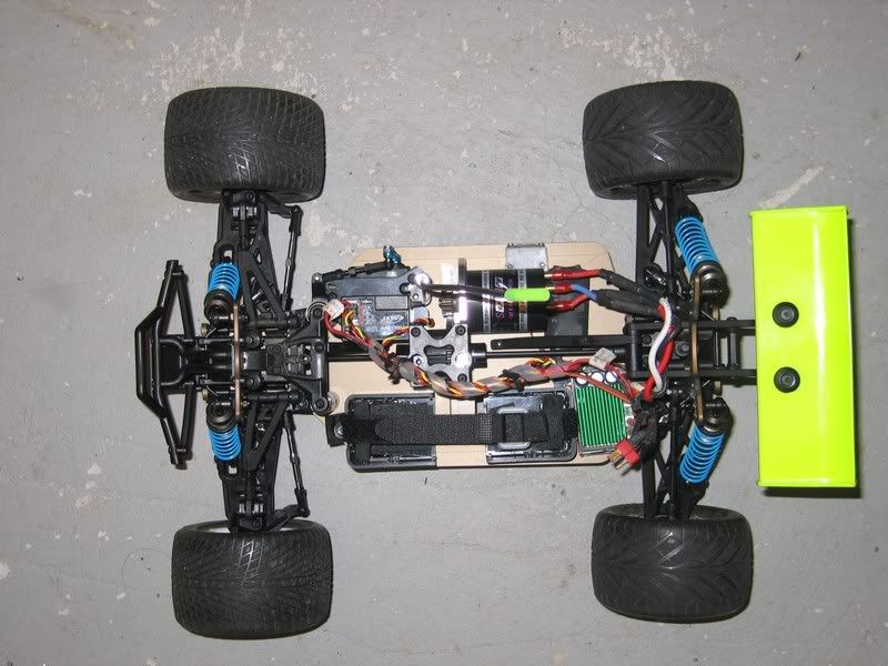

One more pic. Moved things around a bit for a better layout. Drives excellent, just stresses the current batt to much. Drove ~13min WOT in a parking lot. Runtime should hit my goal w/ the 2500 batt. Can't wait to get it in.
