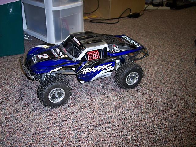

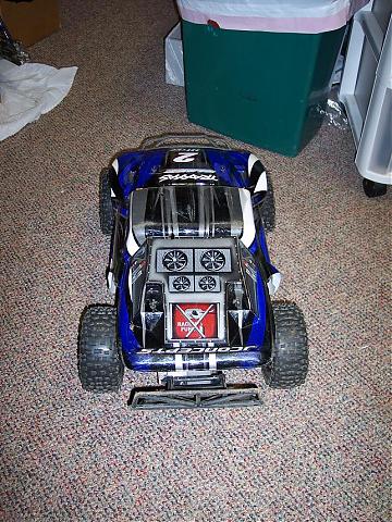

well i raised the front and rear mounts up to the higest possible, i put the wide offset grey hexs on the rear to match the front, i used the traxxas nitro star 5 spokes (all front offset) and of course with badlands tires.
this was my solution to cutting and blowing up the stock tires (even with a tirmmed body) so now i should have 10X better traction, no more pushing, and no more tearing up tires, i may not look the best but it will definetly work.

the badlands hookup amazing, the extra 3/4" of width is nice also, it does get pretty squirly past 35 due to the tires not being taped but the front tires make a huge difference turning, and the rear end isnt near as quick to swap around on you coming out of a turn, so im very happy with after driving it this mourning. and im starting to argee wiht yall and the more i look at it the more i like it.
i am thinking about taking the rear bumper off so when i land a bigger jump a little nose high it wont send it cartwheeling.
