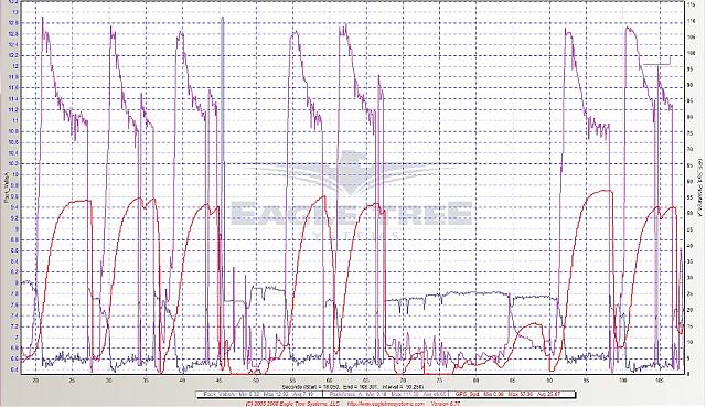

I figure that sometime a few more amp draw charts for the Novak 3.5r might come in handy for someone...so here's a couple more.
1:10 buggy with standard (but belted) tires, 12.44 overall gear ratio, 2s 5000ma 20c battery. 60-63K rpm
Gets the buggy to 55mph max speed, good stuff

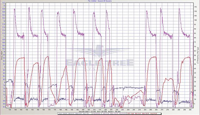

I'll use this as the 'before' Neu battery baseline...A Reedy 20C pack with maybe 25 cycles on it (yeah, real scientific, lol). Anyway, this is the gearing I'm sticking with now, not so low that it belts into the GTB ESC 65K RPM limiter, not so high that it just draws more amps but doesnt go much if anything faster (just drops revs, not enough torque). We're talking a choice of 3 pinions here, running the middle choice here considering what I found.
Hopefully the bump to 25C will result in better voltage stability, I like the way that it seems 1/10 of a volt can give ~2 mph looking at the second from last run in this log on my setup.
Now for that package in the mail....
