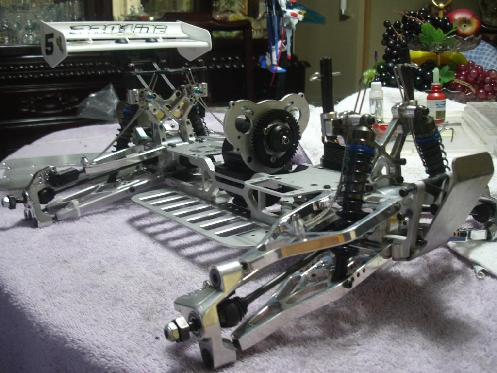

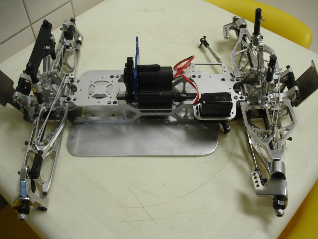

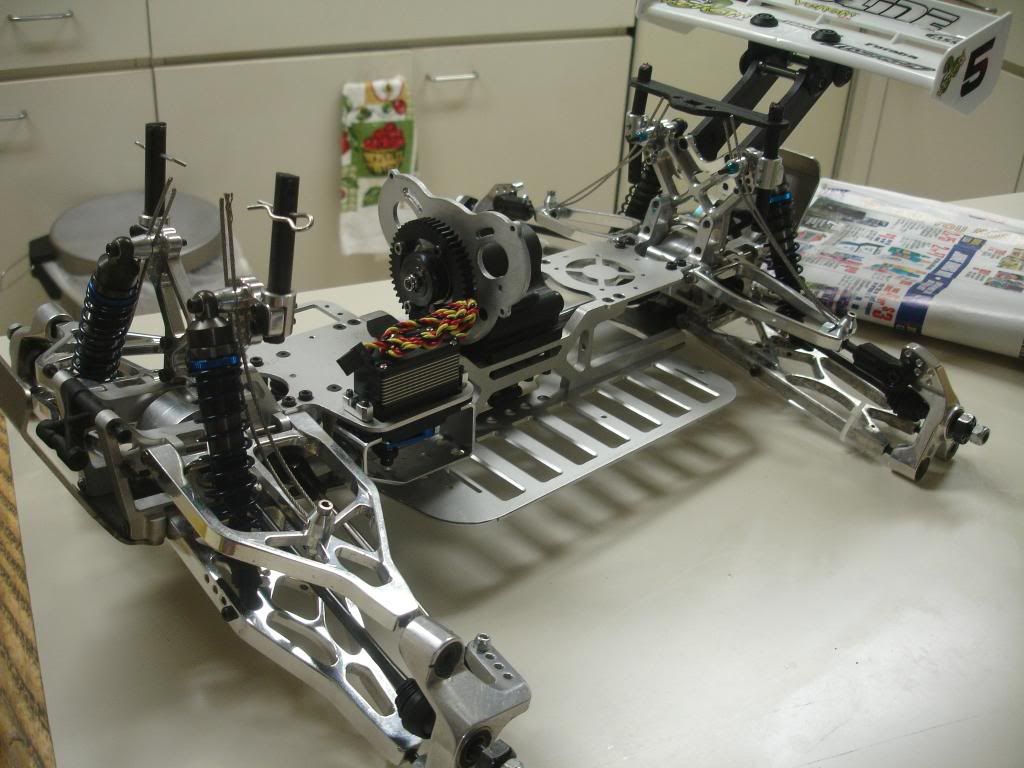

Well, I ditch my original plan of using my thunder chassis for this build. Instead, I bought a used Gmaxx chassis.

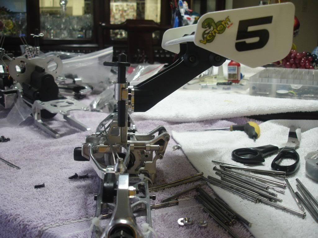

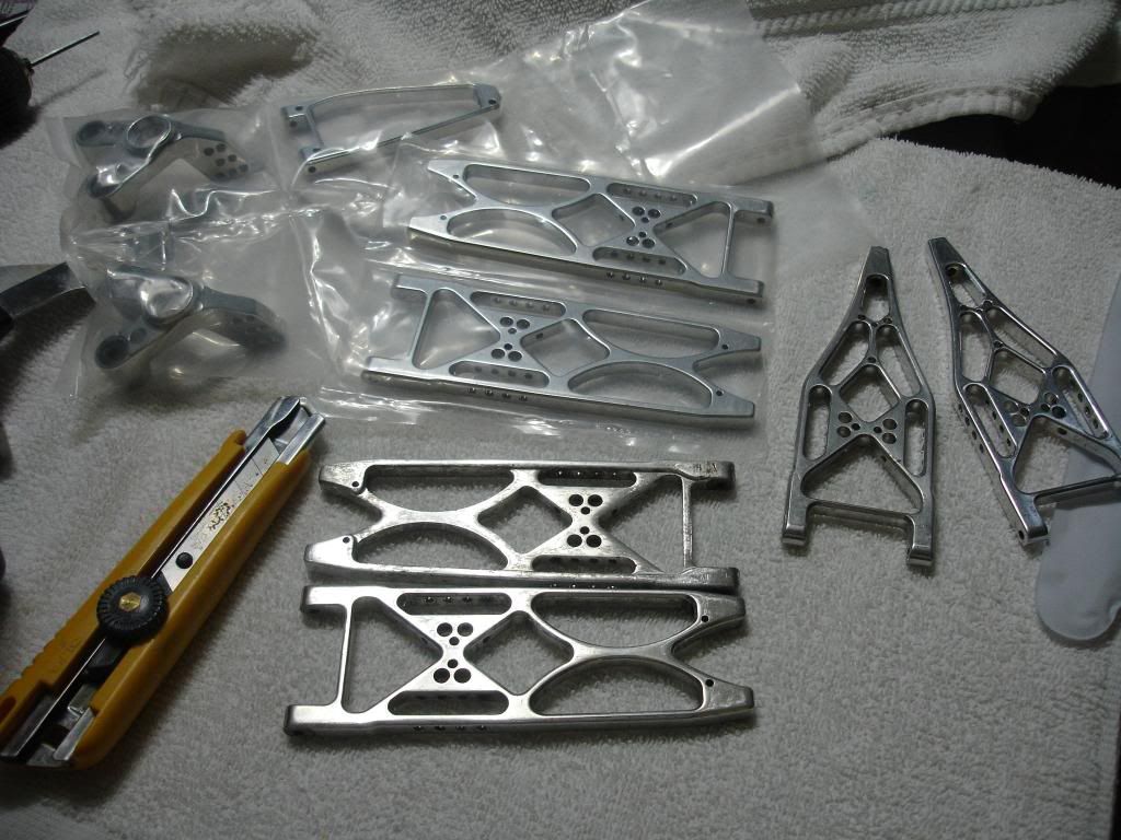

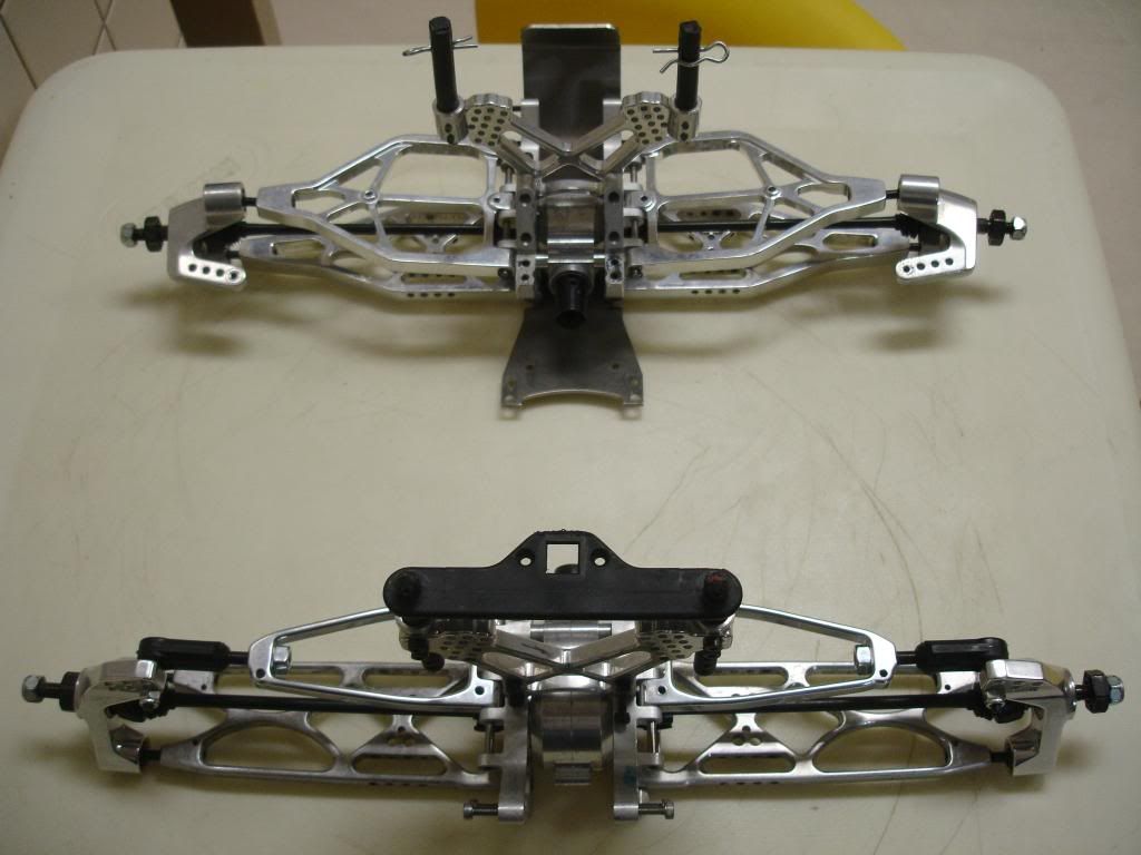

Racerx suspension for the rear;

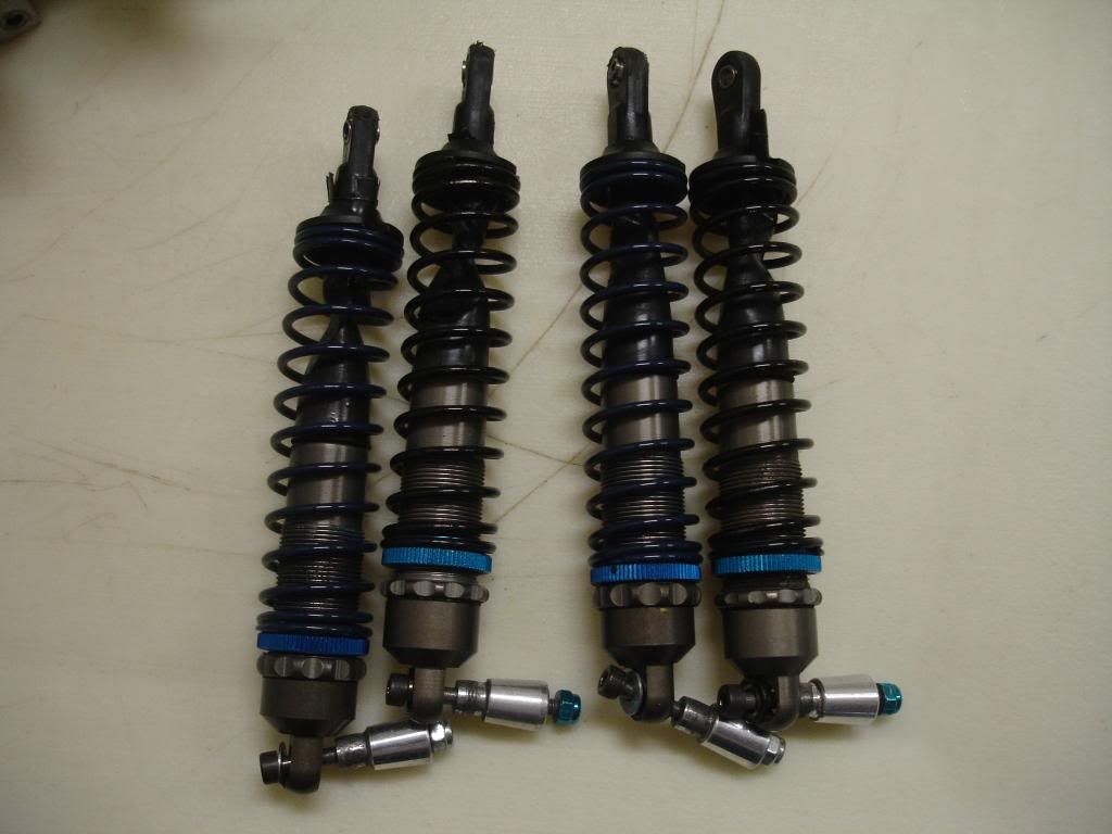

UE racerx shocks:
Assembled front and rear suspension:
Rear with MMM:

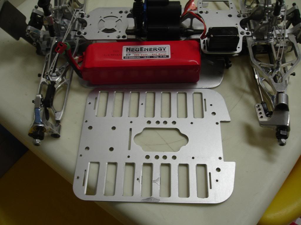

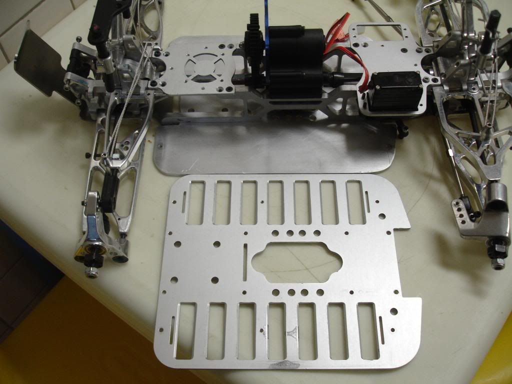

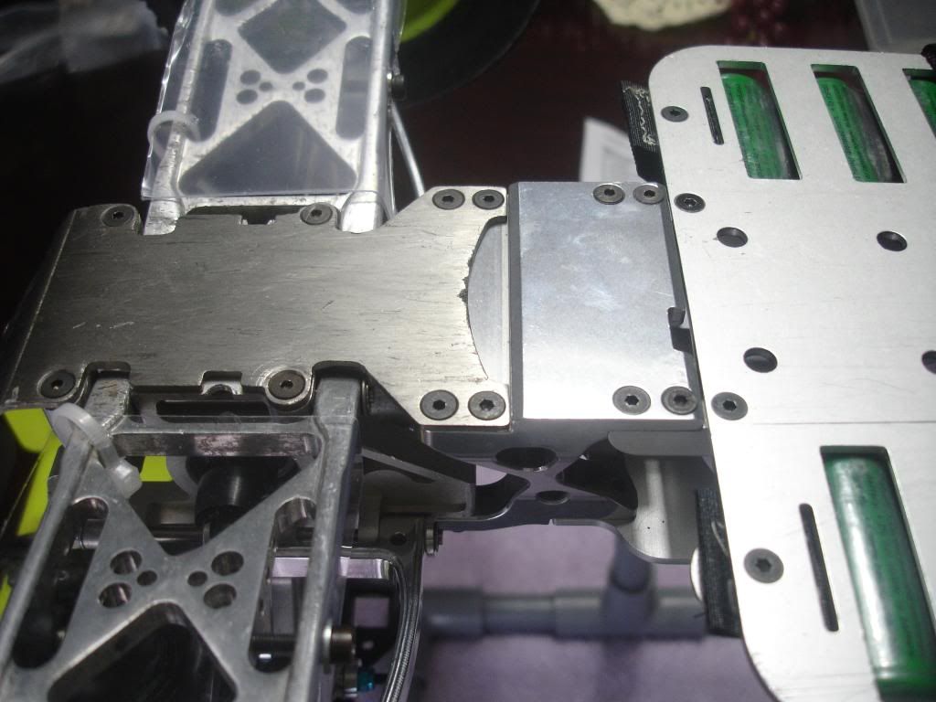

Gmaxx with original chassis in foreground. I made the bottom plate from 3.2mm 6061T6 aluminum.

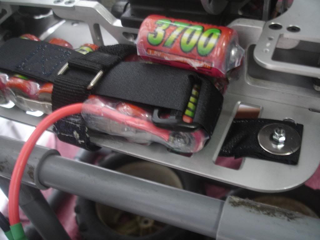

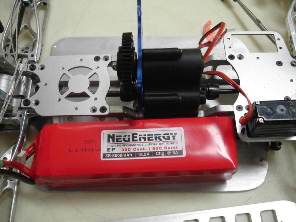

Neuenergy 5S1P 5000maH:

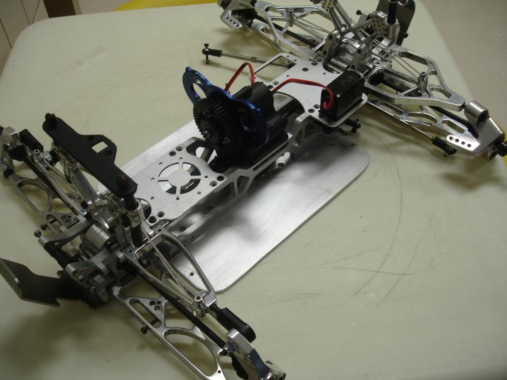

Various chassis shots:

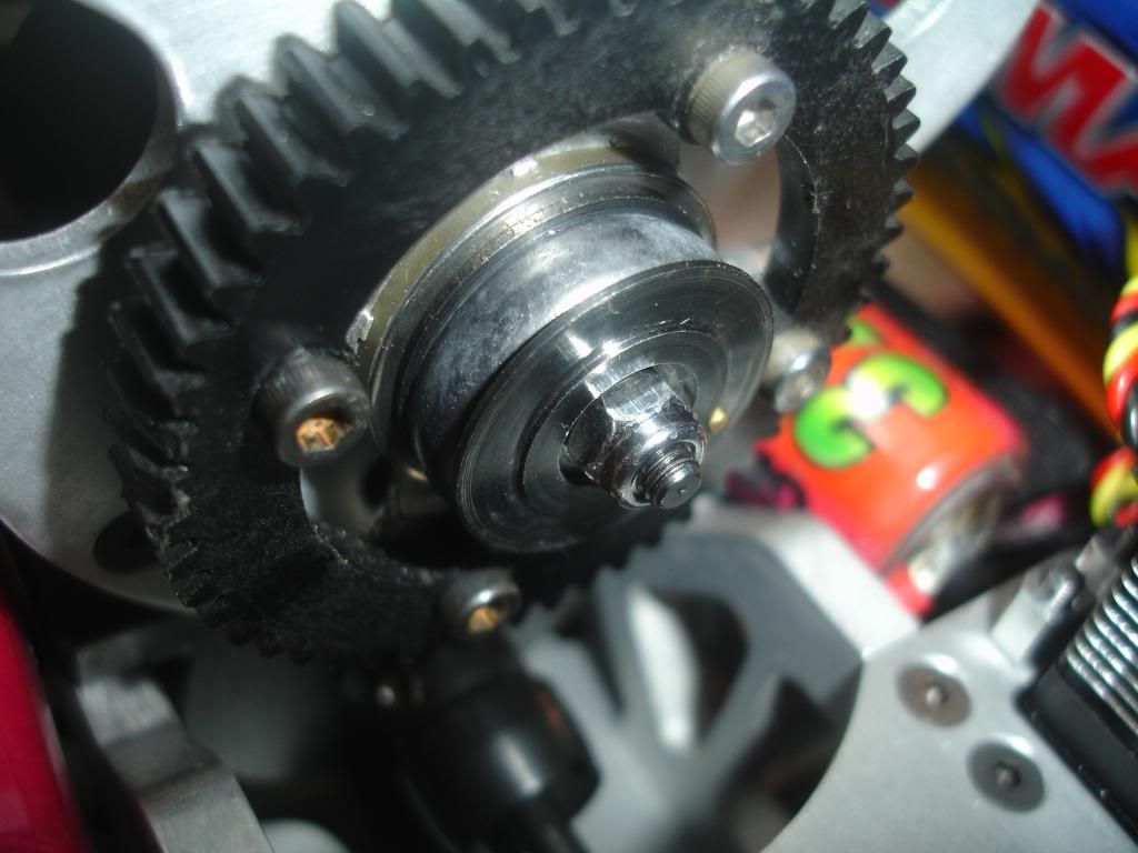

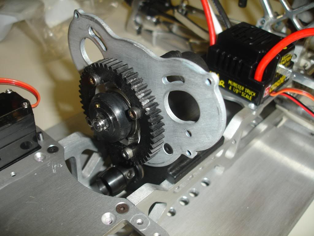

Ofna 51T spur on Strobe slipper. I made a sprong from a faucet rubber gasket/plug.

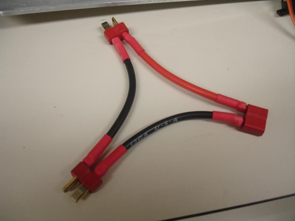

Series adapter when I go 2 x 3S down the road:

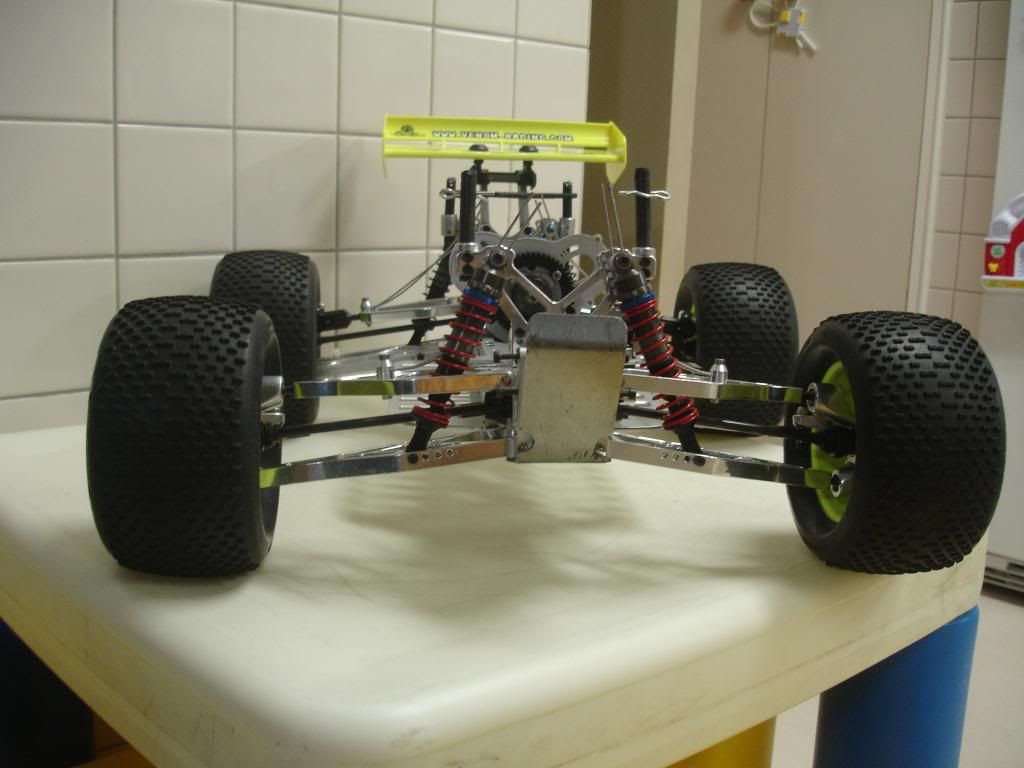

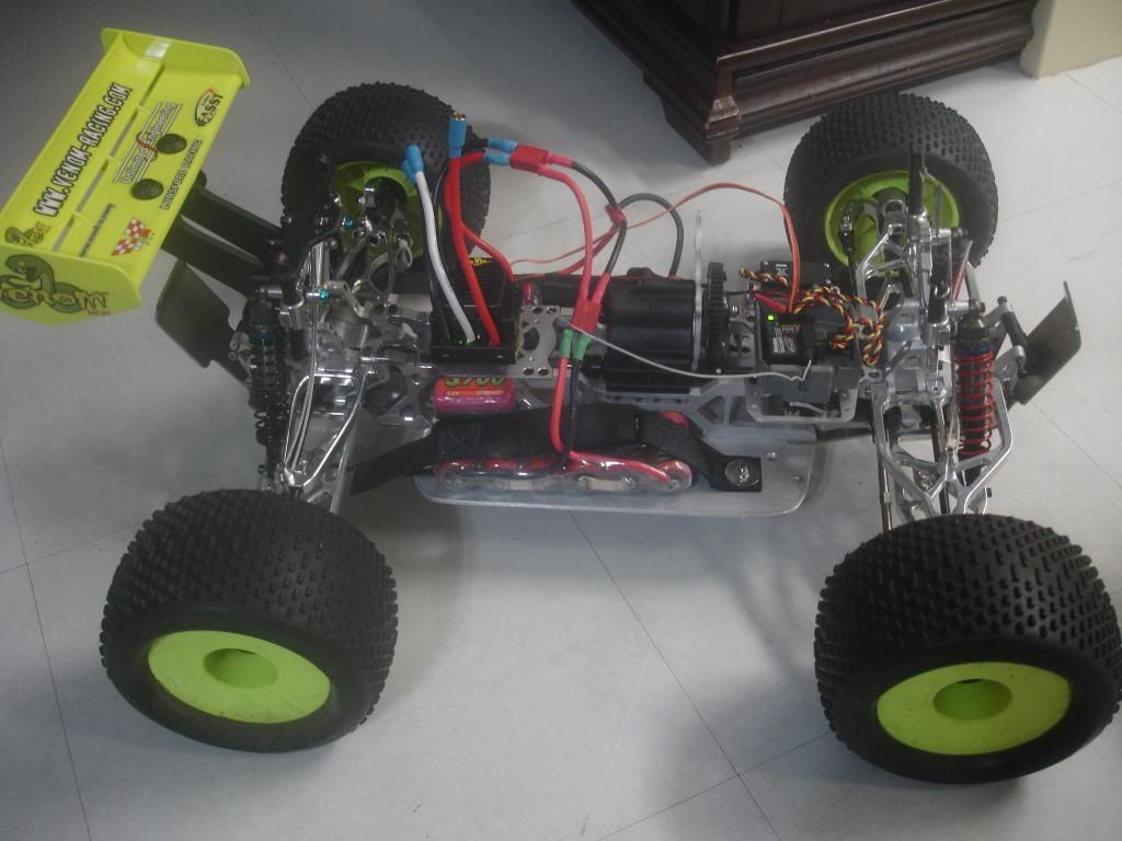

More pics. Made some changes too. I decided to use the gmaxx chassis plate instead of the one I made because I returned the 5S to the store and will be getting 2x 3s 25C 5000maH.
I flip around the tranny so the motor will be towards the rear. I'm still waiting for my UE monoblock for added length. Still waiting for the motor (Medusa 36-60-2000Kv) and batteries from DMA.

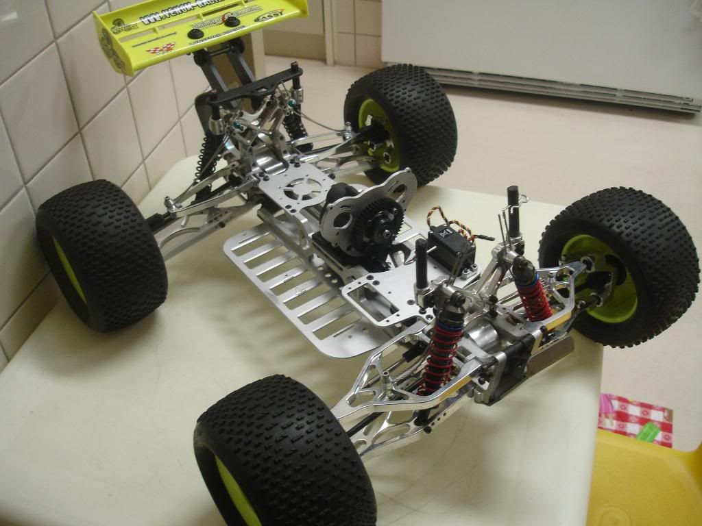

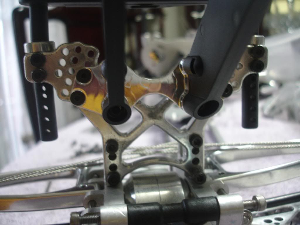

Diemaker Dave wingmount with Mugen MBX5T wing and wingstay:

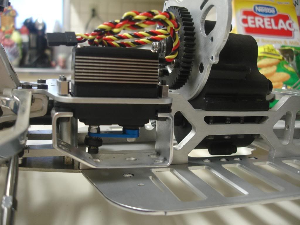

Hitec 5955TG steering servo:
Lexan shield on Racerx lower arm:

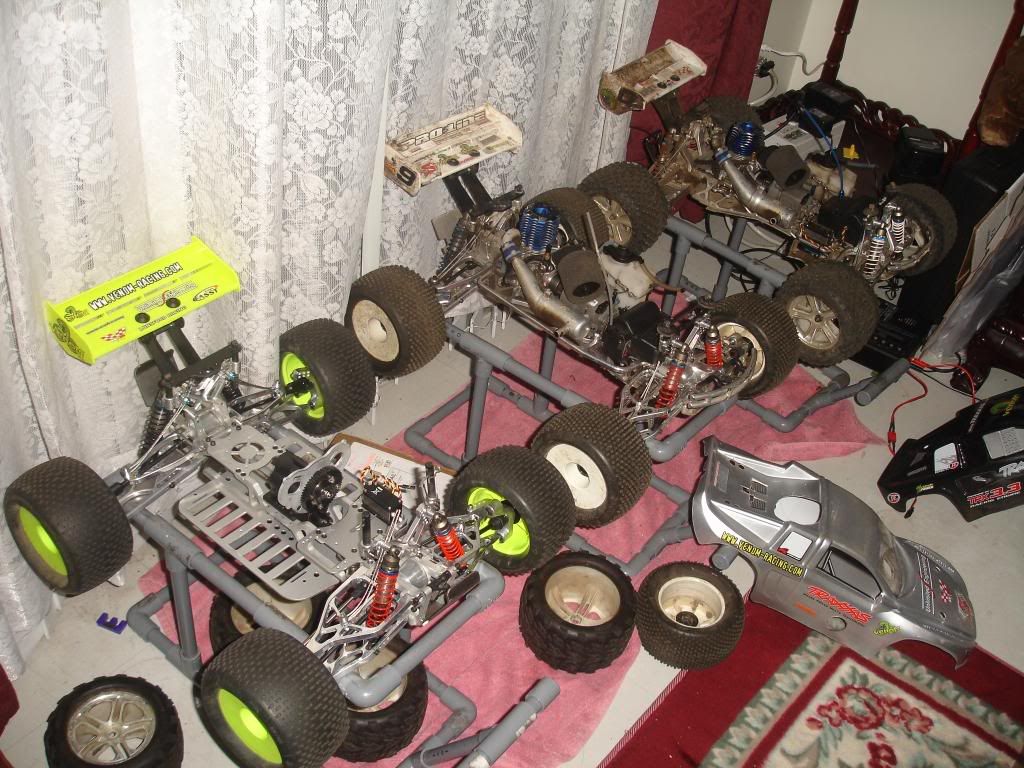

My trucks from left to right; Emaxx, supermaxx, Predator:
Once I get the monoblock installed on the Gmaxx, all 3 trucks will have the same length but the predator will have a longer wheelbase due to the UE setback arms.

I returned the 5S and exchanged it for 2x 3S so it will be more balanced. I didn't realize how big the 5S was until I received it :(.

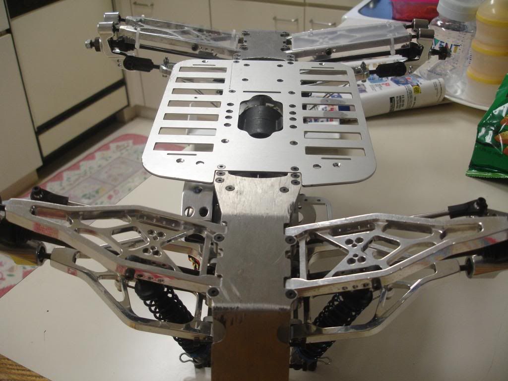

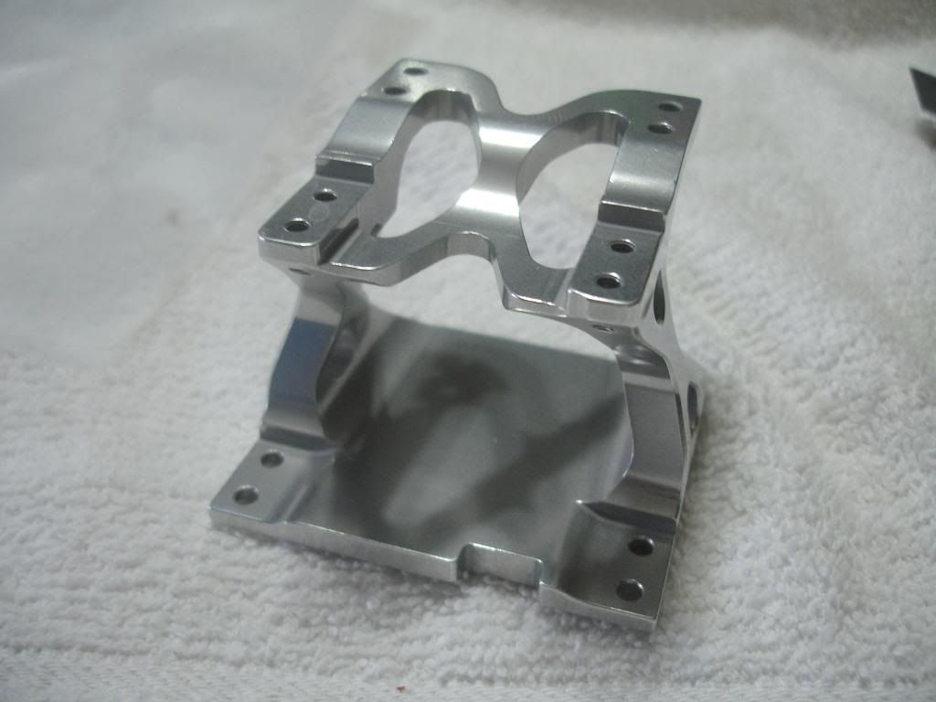

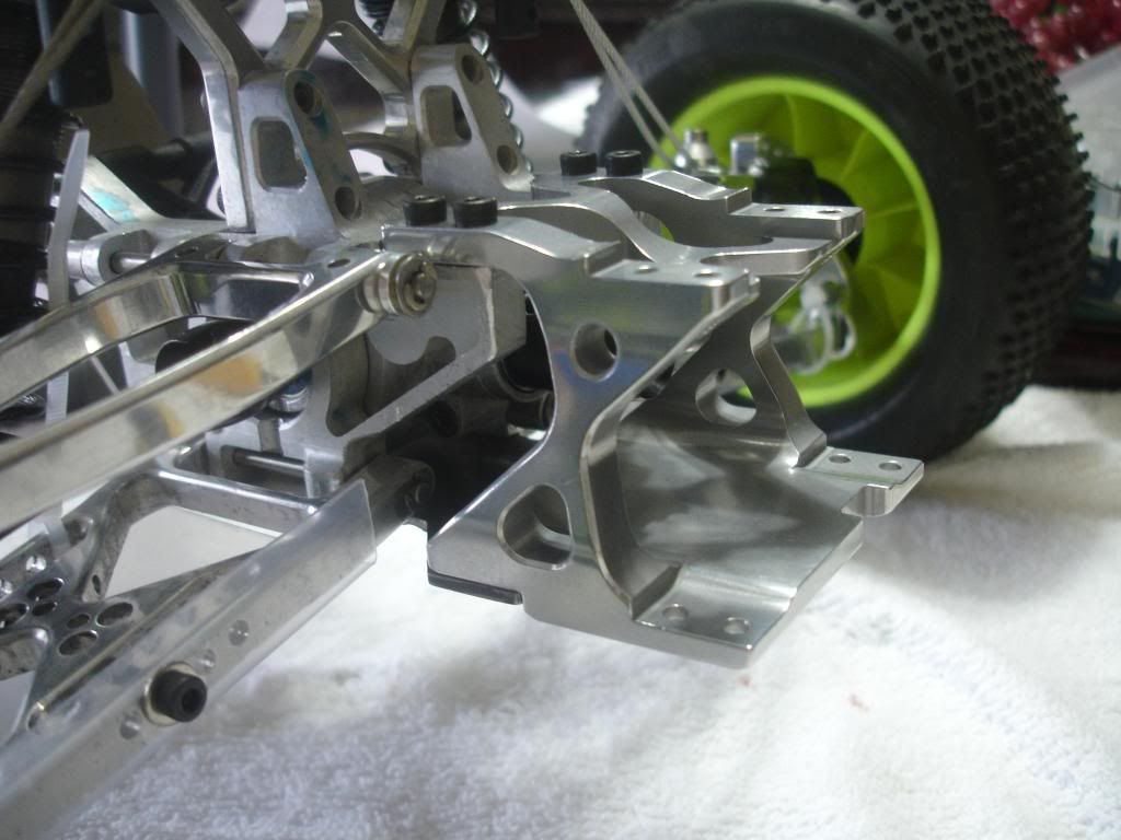

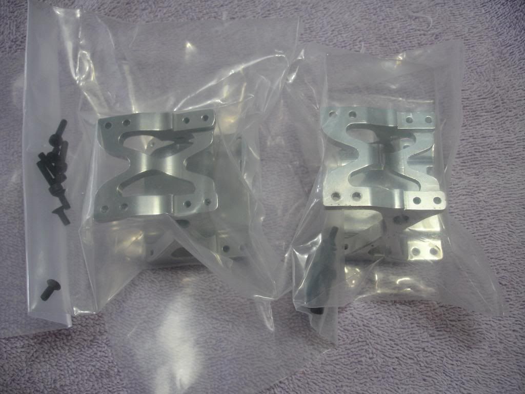

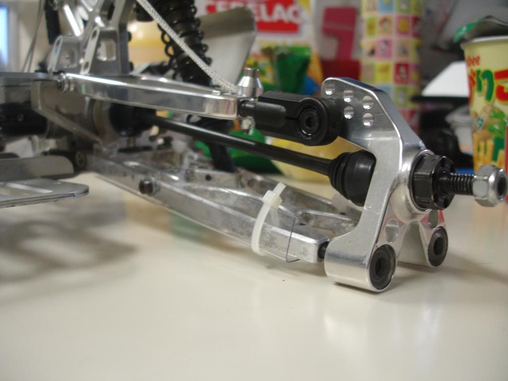

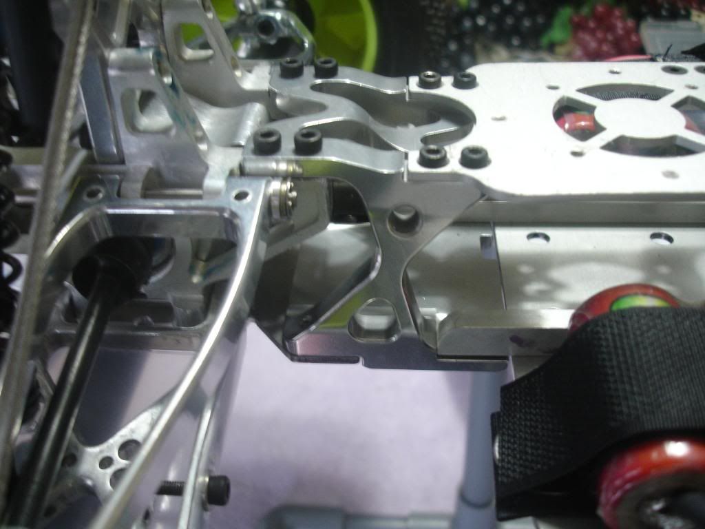

I just received the UE monoblock today and got it installed. However, I made a mistake. I was thinking about using the 100.5mm Thunder chassis titanium dogbone because of the additional length of the monoblock but it did not work. It was too short. I did not realize that I needed a longer than 100.5mm dogbone because the Gmaxx chassis allows the dogbone to be more horizontal compared to the angled way on the thunder chassis. I'm glad I have a 105mm (actually need 108mm center to center of pin) titanium dogbone (I don't know where I got it from :)). I had to use 2 little o-rings on each drive cup to keep the dogbone snug.
Pictures:
UE Monoblock. I bought 2. Let me know if anyone is interested in buying the other one.
Installed Mono:
Home made battery strap:
Strobe sprong made of a sink faucet gasket and flipped over slipper plate :cool: :

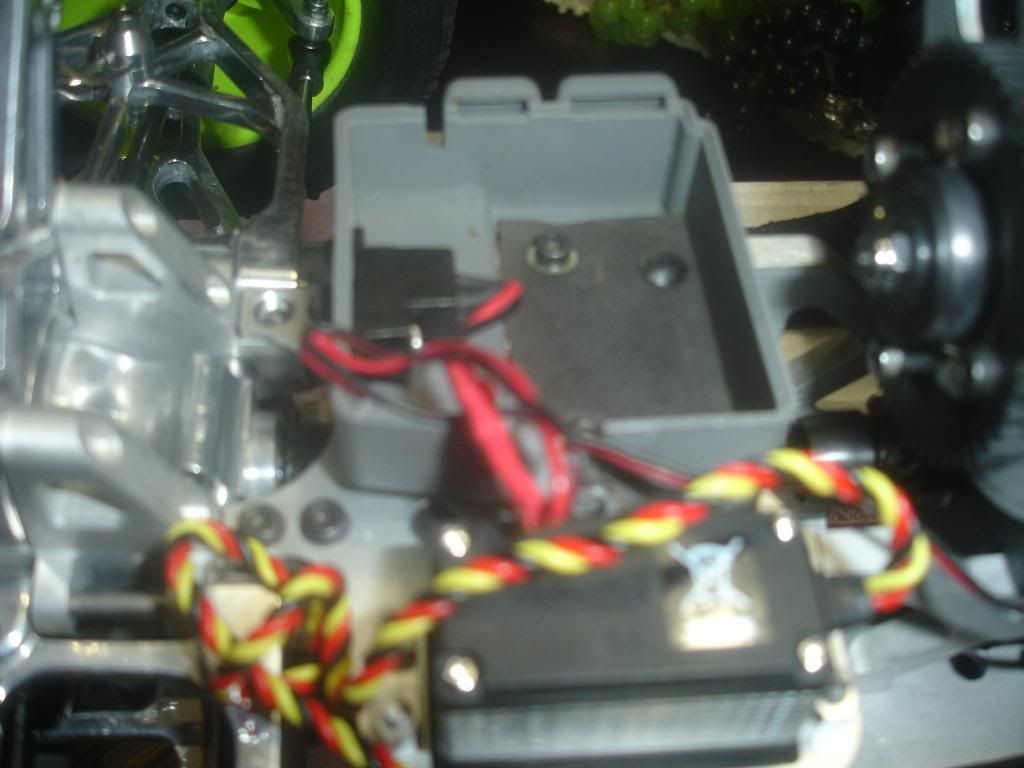

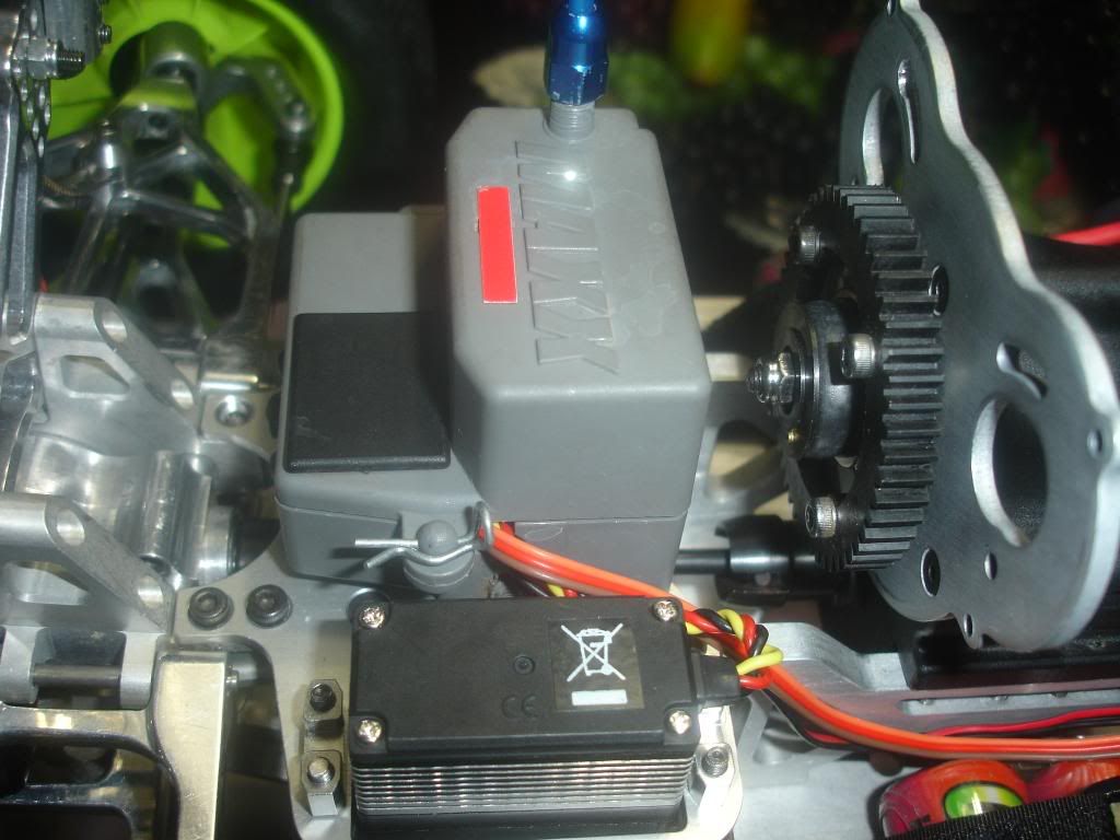

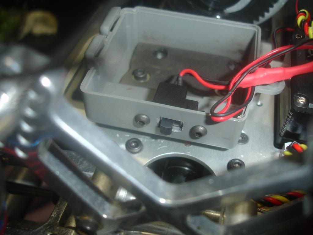

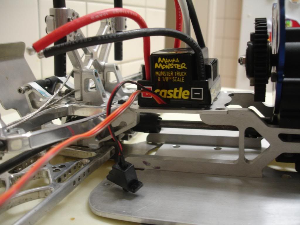

I modified a tmaxx rx box for use on my Gmaxx:

I do like the homemade sprong, so much cheaper and just as effective, Im willing to bet.
Only thing I might suggest is to shorten the battery wires, and the wires of the series harness- less dangling wires is always good, and looks cleaner.

I agree with the dangling wires. it's not done yet so to speak. I will be shortening the wires and tucking them in using zipties .
