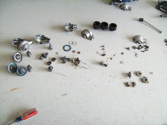

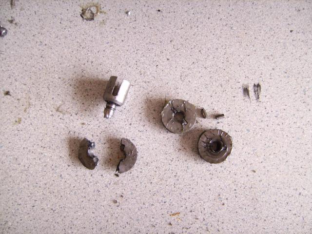

I'm having a small problem with the diff pins in my lst2, and looking for what you guys have run into and what you did to fix the problem. As the pics show I keep shearing the diff pin into 3 pieces. As you can see one side gear and diff output is split in half. I believe that one was from landing a jump under power, but the other two I believe just broke.
SETUP: LST2, TDR hub, and motor mount, neu 1515 2.5d, 6s Flightmax 5000 30c, MMM V3, Losi Muggy pin spike tires, 23 pinion, 64 spur gear, gear flip, XXL tranny gear set, sway bars, lowered ride height, RCRaven springs, 35 weight oil, aluminum bellcrank, BAC link, Hitec Steering servo, no extra aluminum or weight added to truck.
