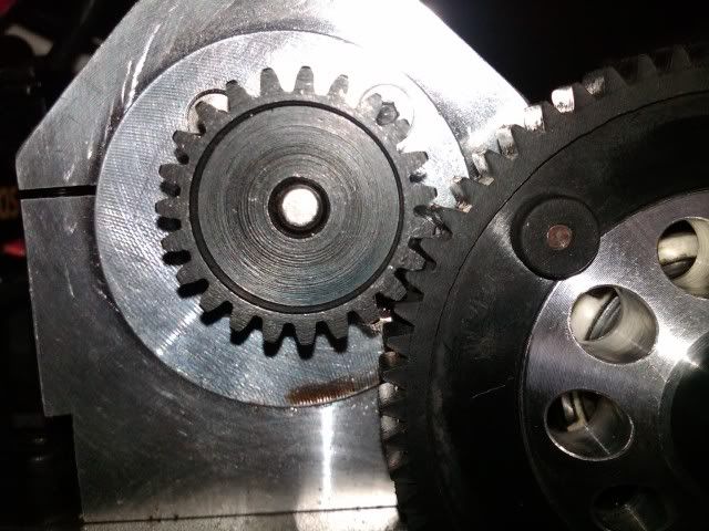

I think you are fine on the racket its making. Mine is the same way, some motors are just "notchier" that others.

But I wanted to show you what my gear mesh looked liked because I'm still bothered by how tight and "notchy" my motor seems. My mesh could stand to be a kiss closer, but it's still in the realm of "ok". I've had it closer before, and it made NO difference on the notchyness of the motor.
I also uploaded a video of what the truck sounds like when moving slowly. THIS is what concerns me, as my ERBE has the same motor and it doesn't do anything like this. I'm using a Mod .1 pinion w/ the Losi Spur 63/23T.
Check it out and let me know if it still seems "ok" to you guys.
