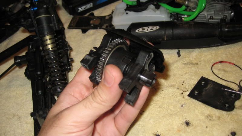

In any case center diff is cleaned and filled with 30k.

I put in an order today for a bunch of small parts that should fix most of the loose ends. Also got around to taking the rear diff out as the out drives seemed a little wobbly. As expected the bearings were bad. So bad in fact, that they fell apart when I took the out drives out of the diff (which also happened to have no fluid in it).
After adding bearings, o-rings, and gaskets to my buy list I investigated the inner rear hinge pins and holders, all of which need to be replaced.

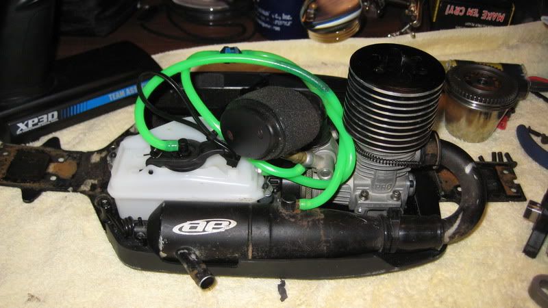

07.14.2009, 01:05 AM
progress update pic
