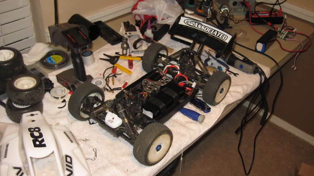

Turnigy batteries came in today and both needed another layer of heat shrink. After I got them wired with dean connectors I tried out the iCharger 106B that also came from HC today.
I'm thoroughly impressed with the charger. Zero problems with the charge control software (more than I can say for my Cellpro 10s). And no more having to run my batteries down in my truggy or buggy, it comes preprogramed to discharge or charge a battery to storage voltage (cellpro doesn't have). Does all battery chemistry's (cellpro is limited to all lithiums). It's also 1/3 the size of my cellpro 10s and about cost about half as much. It only lacks the ability to charge above 6s packs.

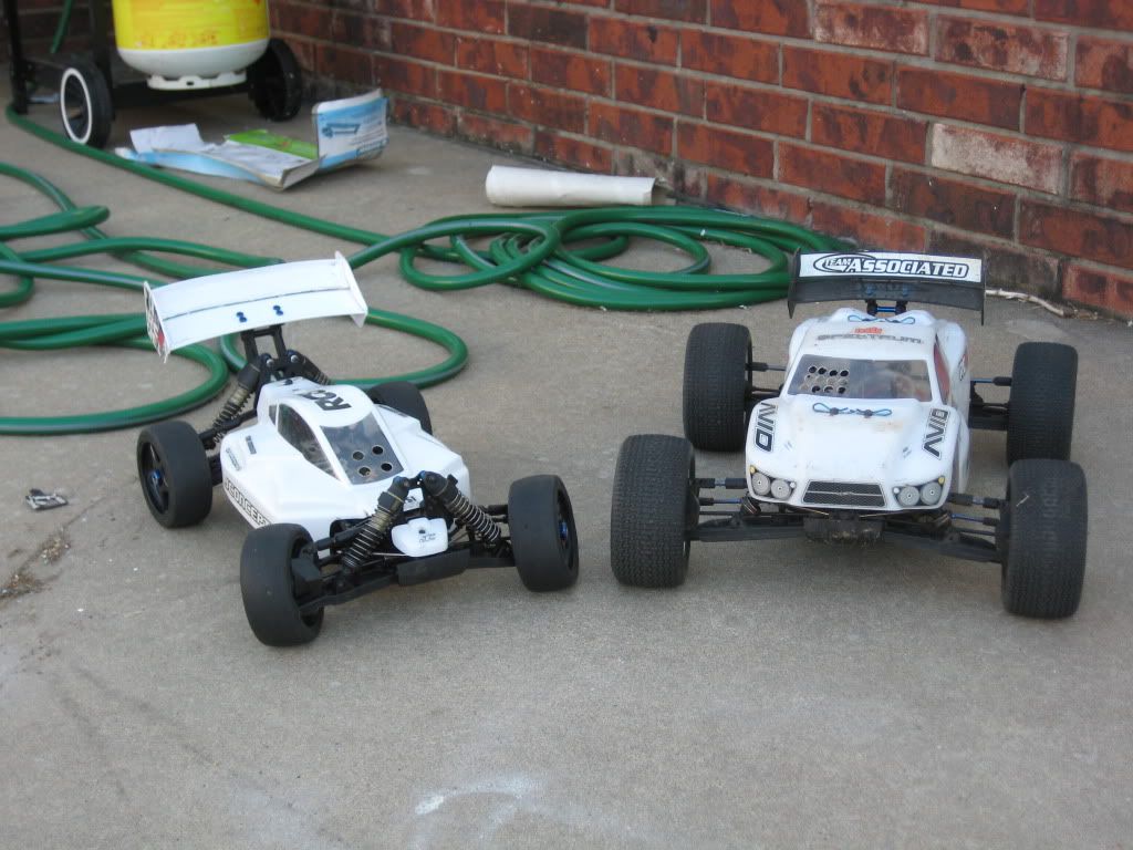

After charging up one of the Turnigy batteries I strapped it in the buggy and went out to test. I think 17t pinion is going to be a bit high with a 4030 1700 motor on 5s. Had plenty of speed (too much for track use) and the motor got up to 115* faster than expected. I didn't have much day light left so I picked up and went inside to test the "Store" setting in the charger (it's still doing its thing). Had a very good afternoon
