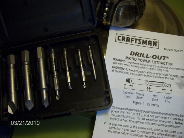

All of us run into this situation once in a while and it will happen try to get yourself an easy out set they sell them at sears or try ebay get nice sharp bits and remember you will use it more than once,then get some small vice grips and remove when you have the a grip,always start with the smallest bit and slow precision

Swift- yeah thats what I was thinking. Im going to hit up sears tomorrow and see what they have. Hopefully that way will work out!

If the hex is flushed up against the chassis; you can try to use the method with the dremel,making a slot like Hautz mentioned which is easy but have enough head on the hex to do but it sounds like you went at it and its worn; opt to use the easy out if you can drill nice and center smallest bit and slow

Well I got some of those extractor bits from sears today and that did the trick! Was pretty painless and works good. I cant believe I hadnt bought these earlier!
