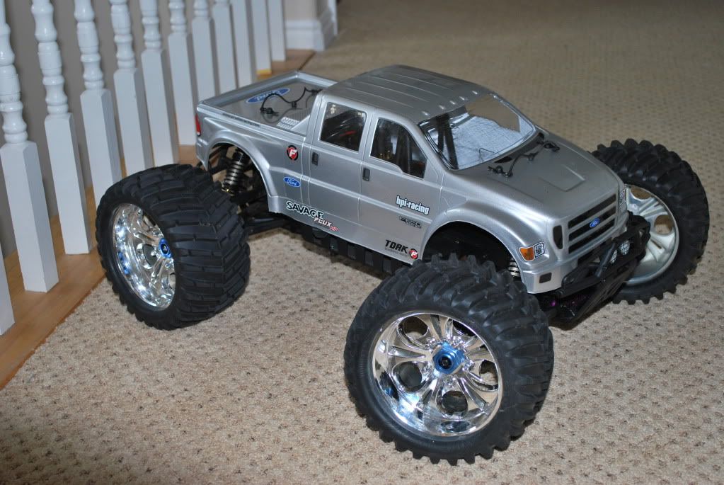

Well here is the new Flux XL
Desert Rc
Posts: 361
Join Date: Dec 2008
Well here is the new Flux XL - 09.14.2010, 07:23 PM
Well its not new....ran a couple times. It has 1offrc XL chassis, 7955tg, xl axles. Charging some lipos now.

Well its been fun. he dogs have enjoyed chasing it around the back yard. It does feel quite a bit more "toy-like" then my Losi Lst XXL. I also feel that the size needs more motor then the 2200kv. I have know idea how people run that motor in the 5t conversion. All in all its a decent runner and I am happy.
I did break a steering knuckle in the rear by just doing a wheelie in the grass and pulling the rear in a weird angle. Kinda shocking actually. I just flipped the rears around for the time being. If anyone has a suggestion on the best aluminum hubs to get. Not really a huge fan of the HPI purplebut I am kinda interested in the suspension upgrade they have. Worth the money??
I think its time to fix the LST....plus it has the Castle 1520 in it. I miss that motor. Wish I could fit it in the Flux.
