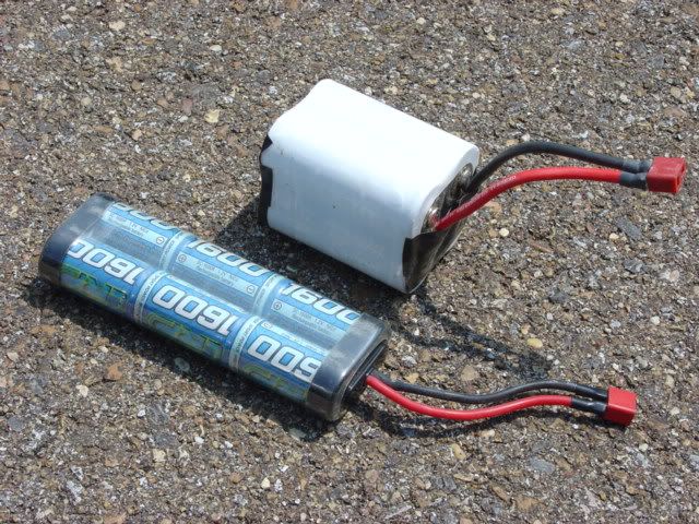

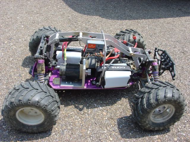

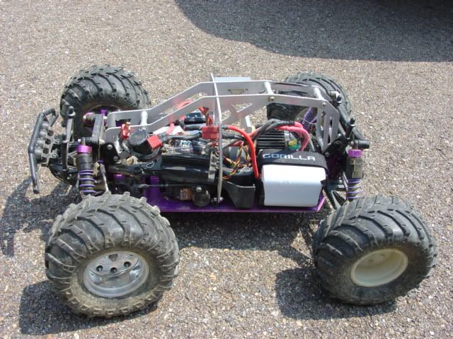

I'll get some video after I get the truck fixed. Here's a few pics of the truck and a pic of a 1s2p emoli pack next to a normal stick pack. You can see in the 2nd pic how the front left shock cap has popped off the shock.
Just to clarify, but isn't that a 2S2P Emoli pack? I see 4 cells in it, looks like 2 pair in series and then both pair in parallel, correct? And it's 7.4V, 6000mAh, correct?
Nick
COOKIES!
Nick's Avatar
Posts: 1,310
Location: England, York
06.15.2006, 02:51 PM
He has 2s2p on each side of the truck. So he is running 4s2p, altogether, I think.
~ Nick.

Yes, it is two packs of 2s2p. Sorry for the confussion. Each pack weighs 430 grams.
