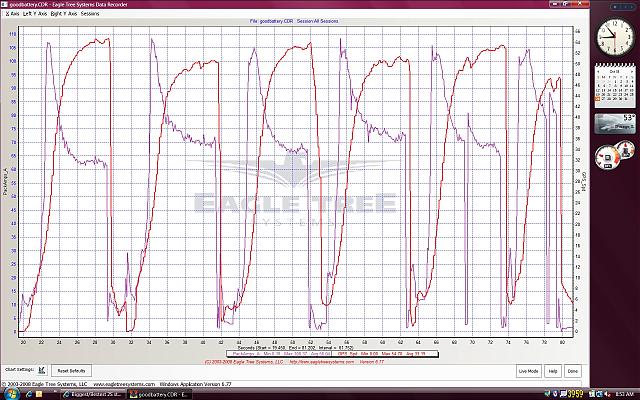

A little followup on the Neu battery...it's a winner!
Very first charge of this battery tested, and compared to my somewhat used Reedy battery, it sure is better (yeah, kinda unscientific comparo)
Average of 4 tenths volt under load better, and new top speed of 58 mph, thumbs up from this tester
