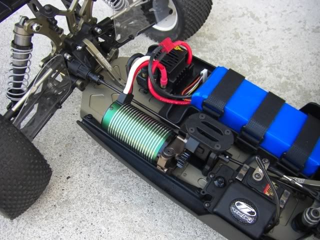

Yeah I already have the lipo, turned up a couple of days ago on the font doorstep, well packed from Hobbycity. I have thought about ordering a 4s aswell to play/race at the track and have the 5s just for bashing around at the park. For some reason when I put in 4s yesterday I was getting results of over 45MPH, today when I inputted my data I get 42MPH I think it is 4s for the track and 5s to bash for me then. I will check my temps reguarly for a while against the ambient temps, running surface and batts used so I can get an idea of where the sweet spot is for gearing. I may order pinions from 13-17 and try each during all seasons.
Anyways, heres how she is sitting at the moment while I wait for some new CC 6.5 Bullets.............She be a work in progress

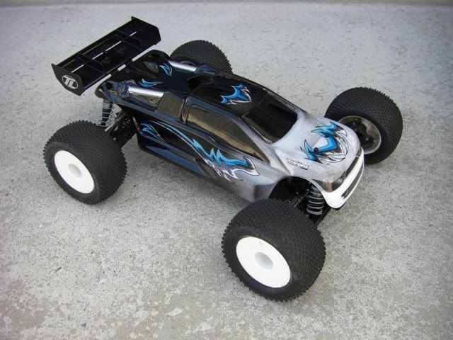

very nice, heres a link to mine LINK , Love that truck, right now i have a 1.5d and phaltlines on it (street fun) 1y on 5s was the best though, I smoke the neighborhood kids street cars with my truggy, nitro burners and nimh rollers, pathetic lot

Awesome, that's what I'm looking for. I do like the centre Alloy brace from GH racing , I may look into that when Mikes slipper comes out and someone says it's good for the 8ight, after beating on it

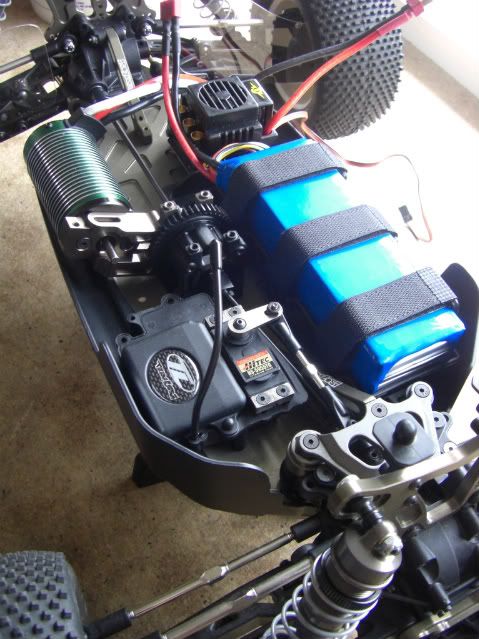

I received my CC Bullets today and soldered them into place, a bit of heat shrink later and I was ready to rock and roll. I must admit I was kind of nervous giving it a blast after seeing vids on You Tube and the likes. Well, plugged in, tested gear and walked out onto the road (we live in a small cul-de-sac)..............gave it a little finger and feathered the throttle to see how she would go, "oh boy" I dribbled in my pants with excitement.
This thing is unreal, I cannot believe I came back to RC's a few years ago and went into Nitro. My old truck has nothing on this beast and it is an absolute BEAST It is alot faster than what I remember electrics to be, running my Tamiya Subaru Brat around with a Technigold in it
Here's a couple of pics of how she was sitting as I finished having fun
A big thank you goes to alot of guys on this forum (George16 who showed me the way) for posting about your trucks and what you have done..........it has really helped this brushless noob feel confident in what I have done I am not going back to nitro now, that's for sure
