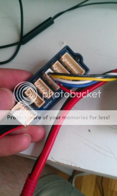

My batteries just arrived from hobbyking!! THis should work right? Hobbyking tab in this hyperion balance board? It fits easy. Like it was meant to be.

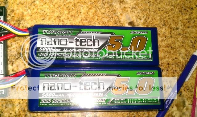

Okay! Check it out! My batteries did arrive today instead of on Monday. So not as good as it could have been but not bad. Really shipping wasn't as bad as I initially said. They look great!

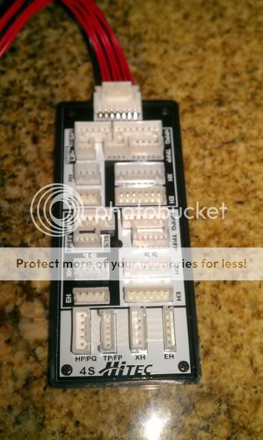

Going up to my local hobby shop was a good decision. They had a universal board that I could open and try out. It plugged right in. But it was 18 dollars.

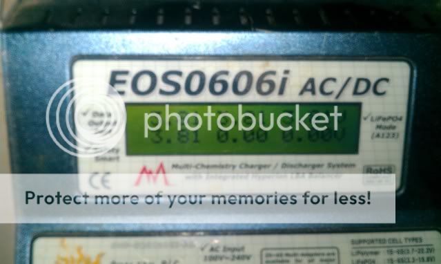

Notice that the cells in pack one are all in sync! Pack two has one cell that has 3.82 all the others have 3.81 Haha its perfect!
-Zack
