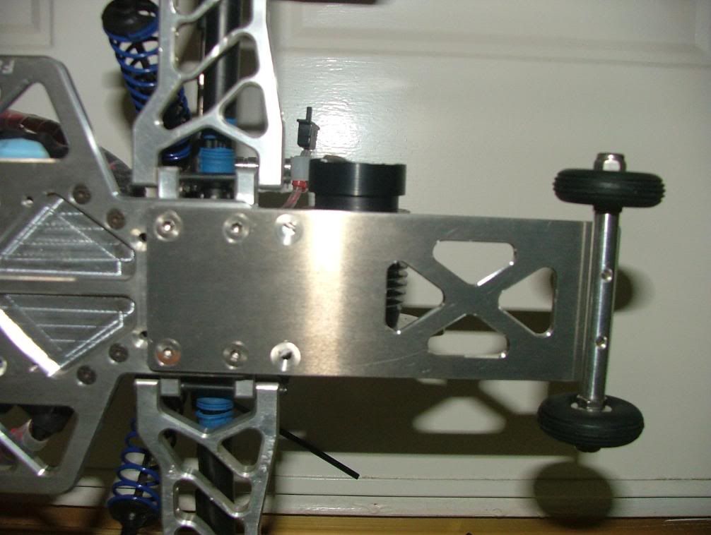

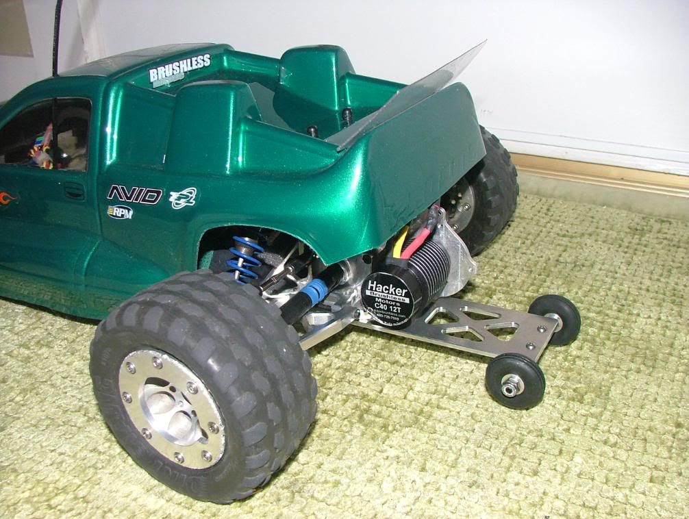

Pics will be up tomorrow, looks just like a new emaxx with a purple finned motor and a quark 125. Now my use of a lsp body may be a first? I picked up a few of those bodies for 12 bucks a piece, so they will be on alot of my trucks.

Looks good man. Whats up with the scuff marks on the motor?

I like to do my test runs without a body (I am a dumbass). It had alot more power than I was expecting from a l can motor!
