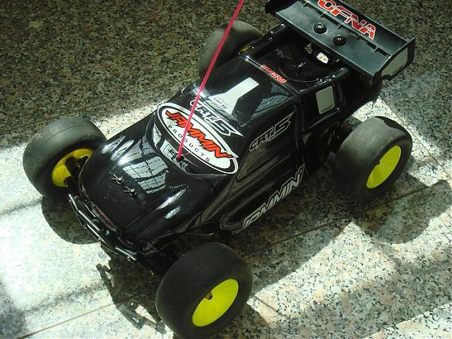

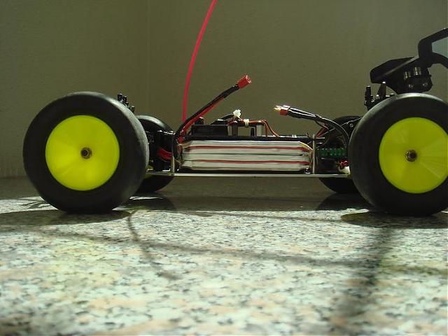

Very nice, hippie!
I just got mine out yesterday and the rear left turnbuckle shaft got stripped out of the ball link( at full throttle the car got out of control and flew like fan in the air).
I'm using 1930/5(4180rpm), a Mamba Max, 4s1p 2500mah Evo25, 13/46 gearing and slick panther truck tires with the standard crt.5 rims.
Definitely a crazy ride!

Looks great. That thing must be crazy on 4s . what body is that & how do you like the fit ?.

That's the nitro rustler's body. It needs alot of mods( not really) to make it fit.
