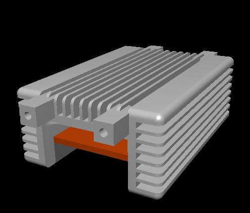

WOW, nice job A4! holy crap, that sure is nice! Is it accurate for measurements?
I REALLY like the top cover, I was actually playing with the idea of having something like that. I like how you made the clamping a little narrower and made fins on the outside from the FET's.
The way you made it, it would be much easier to mount the board in there compared to my design.
So.... is your design all do-able? Like as for the parts you have there, like the button, the acrylic cover?
Keep it coming, make something like my second design with the heatsink on the bottom... :027:

A4DTM
05.13.2007, 07:30 PM
Originally Posted by zeropointbug
:018: :018: :018:
Fairly accurate. the width is fine, and I used stock length and height. as far as the shim placement, no idea. My controller's still in my truck, and don't really feel like unmounting it atm. when you get your controller back, if you take measurements on fet distances, and ect, I can easily modify my design.
the button, I could resize to any dimensions, I'm not sure where to buy rubber buttons like that.. if you could get the button of the stock case, that could work as well. the LED cover, I figured you'd just steal it off the stock cover. as far as making the entire top an acrylic, I have no idea. and I believe if you mill acrylic, it would look frosted, correct?
I was playing with the idea of making the bottom have "tabs" that would screw into the center diff holders. so instead of using the stock diff mount brace, the controller would act as the brace, so if you have metal diff holders, heat could be disipated through the mounts and down to the chassis. I hope that makes sense
Also, do you know what kind of fin pitch (heatsink) is capable with the typical CNC machine?
I honestly have no idea. I have no experience milling myself, I usually just ask whoever's going to be milling it, what the minimums are.

aah, what's the matter A4? to tired? :005:
That's cool. Yeah acrylic would look frosted if it were machined (i think). But if it weren't, you wouldn't need the led cover, just the see through top cover would do...
I would like to make a case that would be sealed from dirt and debris, that to me is another killer of controllers, minerals all over it, insulating it thermally...
NOTE: AAngel, that alum. oxide paste you made, is it permanent? Can it be taken off?

A4DTM: Would you mind emailing the CAD file to me, I would like to look at it a bit and modifiy it.
I am using Alibre Design Pro. PM me

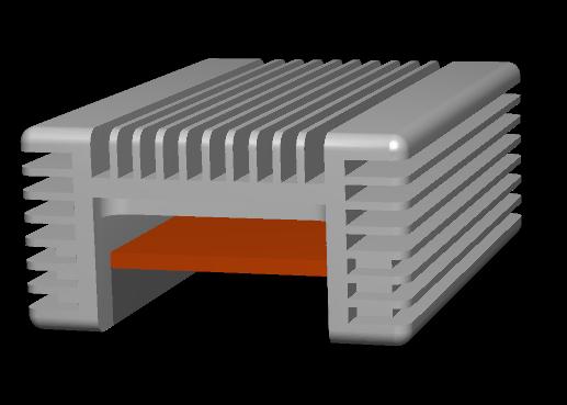

I have been playing with several designs for this case, I am wondering if I should integrate some screw hole mounts with 50mm centers (stock EVX) onto the sides of the case?

New design, doesn't have motor mount holes yet.

ssspconcepts
ssspconcepts's Avatar
Posts: 834
Location: Aubrey, Texas
05.16.2007, 07:46 AM
Originally Posted by A4DTM
zero, I hope you don't mind, I got bored and played w/ your design some. thoughts?
I'm sold. Put it into production and I'll buy it.

05.16.2007, 11:51 AM
SSSPCONCEPTS:
Would you rather have the flat bottom, so you can use RC-Monster heatsink/mount.
Would you rather have integral heatsink on bottom w/ mount screw holes on each end of case?
Also: Does anyone know the dimensions of the RC-Monster heatsink, the length?
Thanks

05.16.2007, 11:56 AM
integral is better IMO
where can we sign up for beta testing?:005:

05.16.2007, 12:24 PM
I agree!

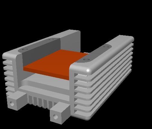

05.16.2007, 08:04 PM
Would you guys seriously want one? PM me if you are serious about getting one. Mike hasn't replied back yet about it; can he machine this even?
Here it is with motor plate mounts on it.
hehehe, this thing will prob give the Quark a 200 amp capability with a few extra capacitors on the system. :027:
