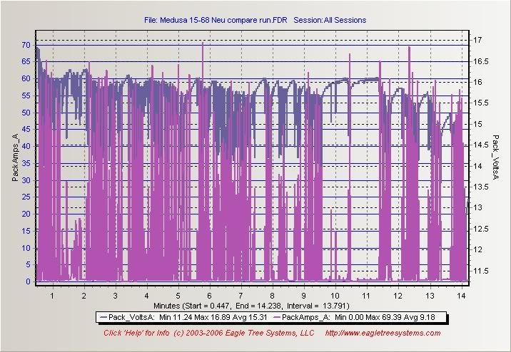

Well just to make sure I was thinking right I just did two back to back runs on my E-maxx one with the Medusa 36-50-3300 and one with my Neu 1512/2.5D both on 5s A123. The Medusa was running a 15t pinion 68t spur, the Neu on a 24t pinion and 68t spur. Both setups show 33mph on the Top speed calc @scriptasylum.com.
Data from the medusa run.
Data from the Neu run.
As for driving the Medusa felt a touch faster and maybe a bit quicker off the line, the Neu felt like it had a bit more midrange torque, better for racing?? or too much maybe?
I plan to move the Medusa to my EMT now, still on 4s(fits the truck well) and this should be a nice setup I think, and kind of what I think I would do with an 1/8 scale buggy if I was going to race at less then ballistic speeds. I'll do some more swapping around and see how the Medusa does on 4s in the truggy.
I'll post back with some data later tonight.
Need to mod my motor mount for the Medusa, might not get to it tonight.

05.12.2008, 07:48 AM
Thanks!
WOW! Only 9A of average amp draw.

No problem! This was a comparison that I was very interested in myself. I was amazed that the two motors were so closely matched. But it does appear if you want to save weight go with a high quality smaller motor with higher Kv and gear down a bit.
The only thing I still worry about is weather or not the bearings will fail early with such high RPM (45+k). I have a few hours on it though and it runs as well as it ever did
