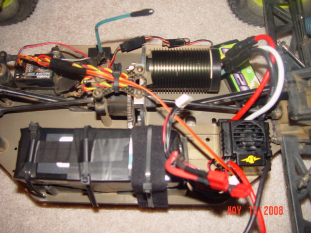

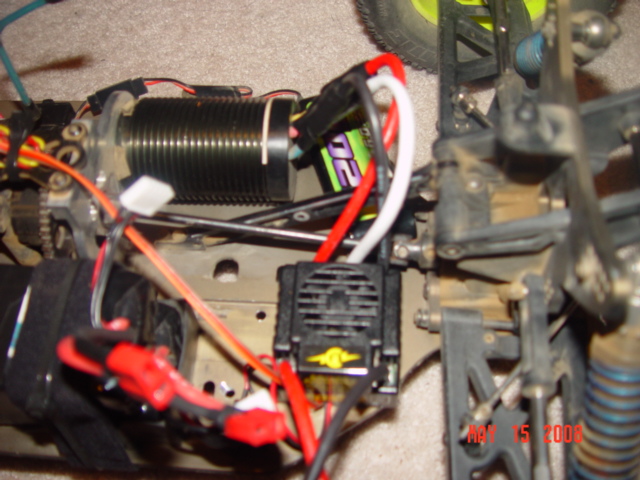

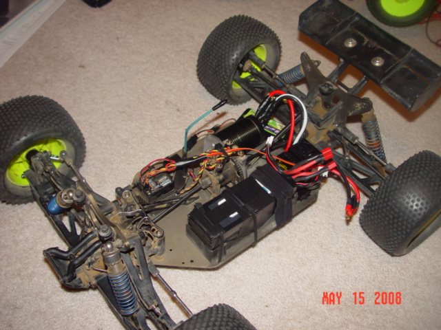

I will post some pics with my set up, It rained here all day so i didnot have the chance to run my truggy again outside,i osberved that other escs that have bec ,if it goes on a higher voltage like 4s and above would have to use an external pack just like my mamba max esc i used it in my revo on maxamps 8000mah 4s lipo and been ran it on the track many times without any problems and no heat /thermal problems with my NEU 1515 1y 2200 kv by disabling it's bec by taking the red wire out. This is what the tech staff support told me that 2 guys tried to put an external rx pack and disable the monster's BEC by taking the red wire out and so far no problems being reported but guys ,i'm doing this at my own risk and if you guys wanna do this it will be your own risk .I'm just sharing what i observed in my truck.The tech staff are still finding what the real cause of the problems.I have passion in this hobby and i thought you guys deserves to know my observations to help this "monster bug issues" because you guys are always willing to help everytime i need help here
Brushless Jammin Truggy on NEU 1515 2.5 D on Monster mamba max with maxamps 5000mah 6s Lipo
Gorillamaxx Revo CF version on Mamba maxx ESC with NEU 1515 1Y on Maxamps 4s 8000mah Lipo
luvsrc
RC-MONSTER BRUSHLESS FANATIC
luvsrc's Avatar
Posts: 306
Join Date: Feb 2006
05.15.2008, 09:51 PM
Here are some of my pics
this is the truggy that broke our track record in terre haute, this was with monster pro and maxamps 4s 6000 mah lipo http://www.youtube.com/watch?v=zZOQZgckCC8
