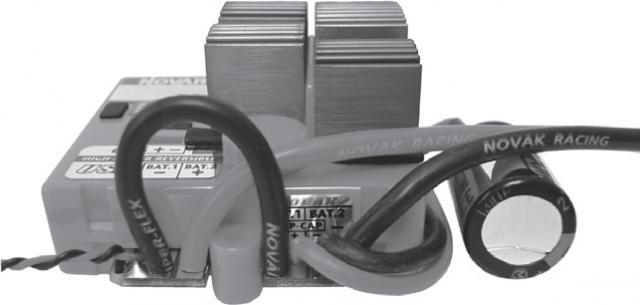

If you are using a single 4s lipo with the normal dual battery leads, are you also using a jumper plug connected to the un-used input? Heres how you should have it wired up:
Just pretend its a hvmaxx esc with one motor.
Otherwise, how do you have it wired up normally? I wired my old hvmaxx esc up to use a single 4s lipo back in the day, and it worked fine; I can only imagine something isnt wired correctly. If this is a newer hvmaxx pro (black heatsinks), then check the esc's LVC setting too.

Ok, yea I dont have it with me.. but mine is very similar to that.. something like this:
But Its like that, but maybe the otherway round.. sorry its not great
That is the way I got it.. that works but will do the stoping. I tried it the single way-As far as im aware 100% correct and esc wouldnt go on.
Its in a RC8 Conversion cheers
Guys
10.19.2009, 05:51 PM
Bleh, trouble with my diagram is it isnt 100% accurate in terms of where the wires come from and go to on the battery wire wire. However, if your setup looks like this *see attached picture*, then that is correct and it should work fine.
Q. how did your friend have the esc wired up when he was using it? Im gonna assume he was using both battery input leads with a pair of 2s lipos or pair of 6/7 cell nimhs? If it worked alright then without any external BEC or other mods, then either the internal BEC has become damaged, or its not liking being used on 4s lipo with the suggested wiring setup. Beyond that, Im thinking you may have to send it in for non-warrenty repair if the BEC is acting up- making it work properly with an EXternal one isnt as easy as it is with an esc with only one set of battery leads ( I cooked a bec doing that once, then discovered the internal one was fine with a single 4s pack anyway, go figure )...
