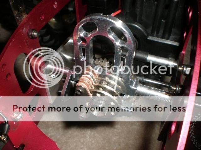

I found this from another build thread on this forum. No info on how it worked though. think it would be strong enough mounted like this? My mount would not look as slick as its not an RCMonster mount but it might work. :)

Thinking aloud here.. but I'm wondering if you can't mount the diff sideways, so that the motor is oriented either on top or beneath it. Some aluminum spacers would give you room to allow for clearance of the spur, and you could even center it between the two chassis plates.

Originally Posted by IrishChamp View Post
Sense that mount is already attached to the motor you wanna just throw it in the box as well?? ;)
That mount will still go in my truck . Check out the RC-Monster store, Mika has made a nice motor mount: http://www.rc-monster.com/proddetail.php?prod=rcmcdmm
You should see the angle on my BPP Truck . The angle on yours doesn't look that bad.

Can't blame a guy for asking ;)
I've been eyeing Mikes Universal Mount for a while. I should have just gone with it but I have what I have and would like to make it work. Wish I wasn't do stubborn.

Would it be crazy to put it upside down? To spin freely it needs to be too low, below where I would need to secure the platform. Using this mount sideways would be a little problematic because of how this mount is designed, where its mounting points are etc.
Room for electronics up top.
I like the way he made that work. Do the same and you could (Maybe) fit the batteries inside the chassis.

I think I could, they just arrived in the mail, I'll see if they will fit. The advantage in my mind to putting them on the sides though is being able to choose the weight bias and possibly putting them lower. inside the chassis would be best though.
