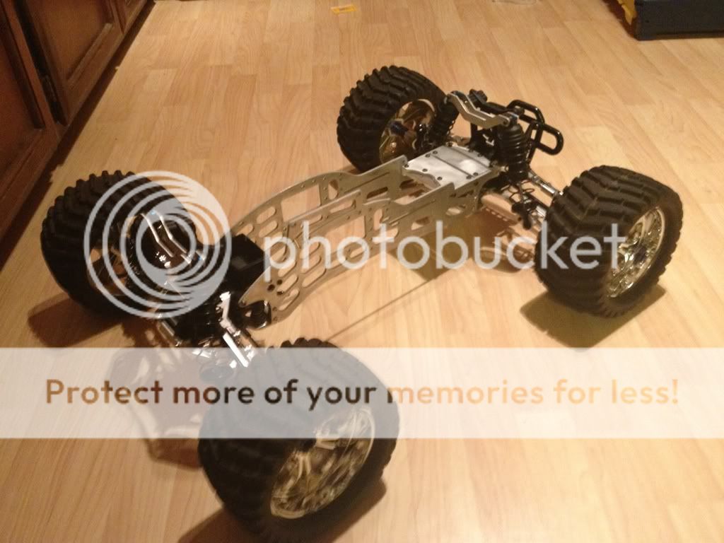

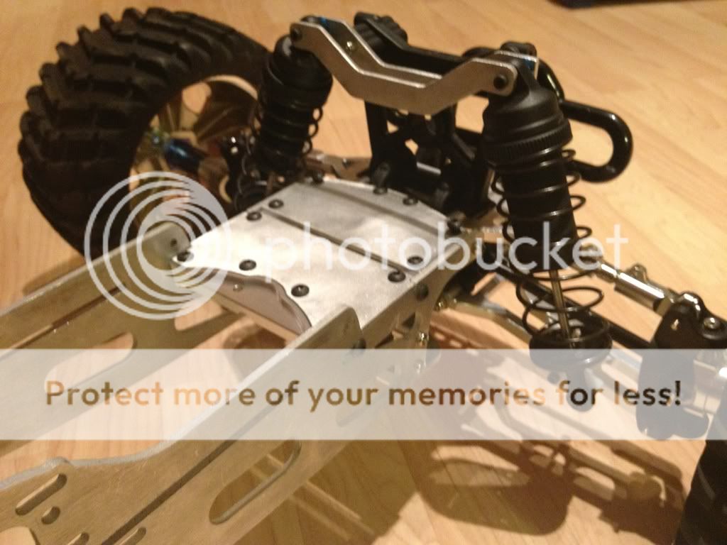

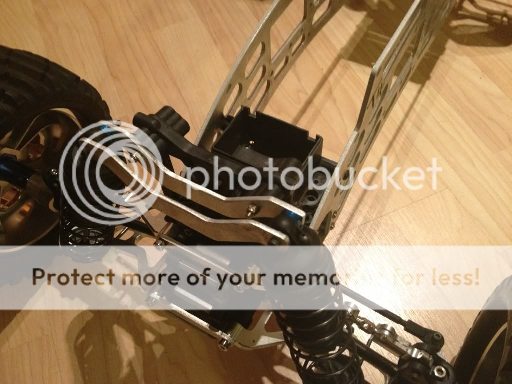

Rear bulkhead and chassis support plates:
Finally bought an esc as well, jive 120hv
